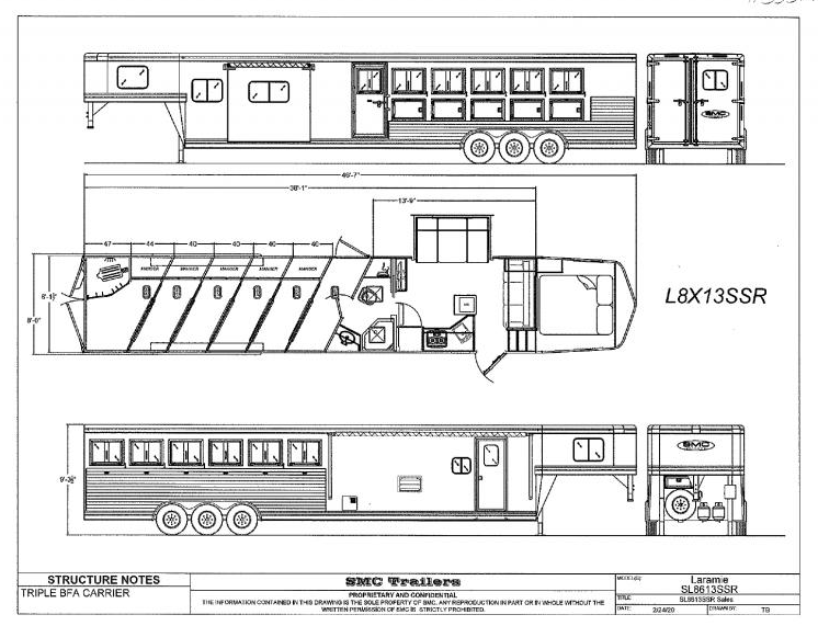

I have seen used mattresses and a six horse(slant) style trailer used for old iron from auctions. A 6 horse trailer is still really long though 30 ft plus living quarters.As others have said the horse trailer is about 10 inches off the ground, safer than 4 ft. After all these are IRON horses. Will the bikes be (dry), or have oil/fuel in them?

I like the 6 horse trailer idea, you save on hotel costs and hopefully can park it close to the bikes.
I would probabley use the side stands and a lot of straps.
