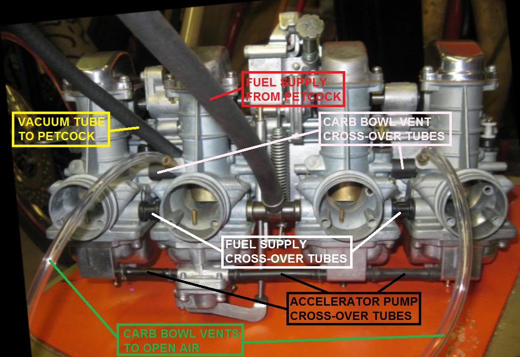

I'm working on VM24 carbs today. Very similar to 26's, but a few wrinkles. The PO said he rebuilt them...yeah right! He put new float valves and jets into them. Never bothered to clean the main emulsion tube...full of gasoline snot. The outsides were covered with grease and dirt. The joiner between carbs was cracked and has to be replaced. What's with the two intake ports on the downstream side of #2 carb? Never see that before.

See image below for hose connections. Ed

Thank you Ed! Looks like the second port is for the petcock. I didn't realize the petcock wasn't a gravity only feed.
