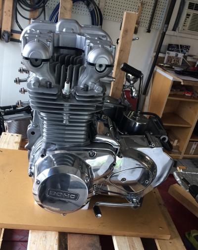

Hi KZstreetfighter 71, Good for you buying the Phoenix. I am just butting in, I sold a KZ1000 complete engine in 2018 for $700.00 US dollars.

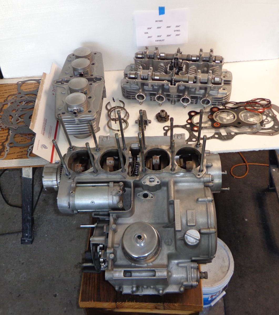

But I did a lot of work to a 77/78 KZ1000 engine and head. Not assembled, but ready to be. I shipped it via LTL Freight From New York to Arizona. I gave the guy a break on $ and did not charge him the ebay % commision. Because no one pulled the trigger from eBay when it was listed in 8-2018.

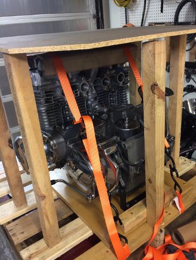

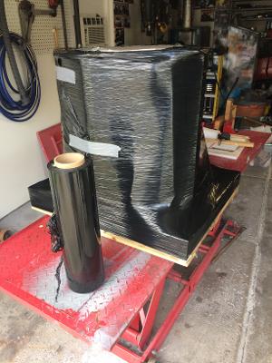

But check this out. And from being in Logistics and Shipping for 32 yrs. I learned to package overkill! To make it safe! I have seen it all! from Fedex To UPS and the USPS. Palletized ready for a fork lift. Imagine that? I still have stretch film rolls from 10 yrs. ago when I retired! TIP in USA! "Old Dominion Freight" Cheapest for LTL pallet shipments. As long as you get the pallet to their docks.

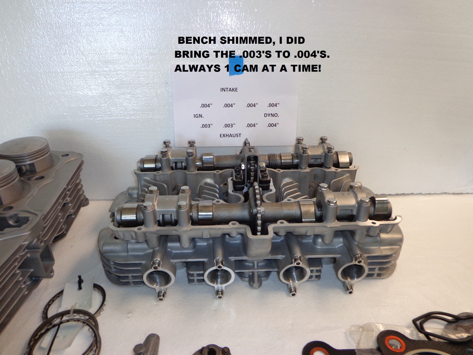

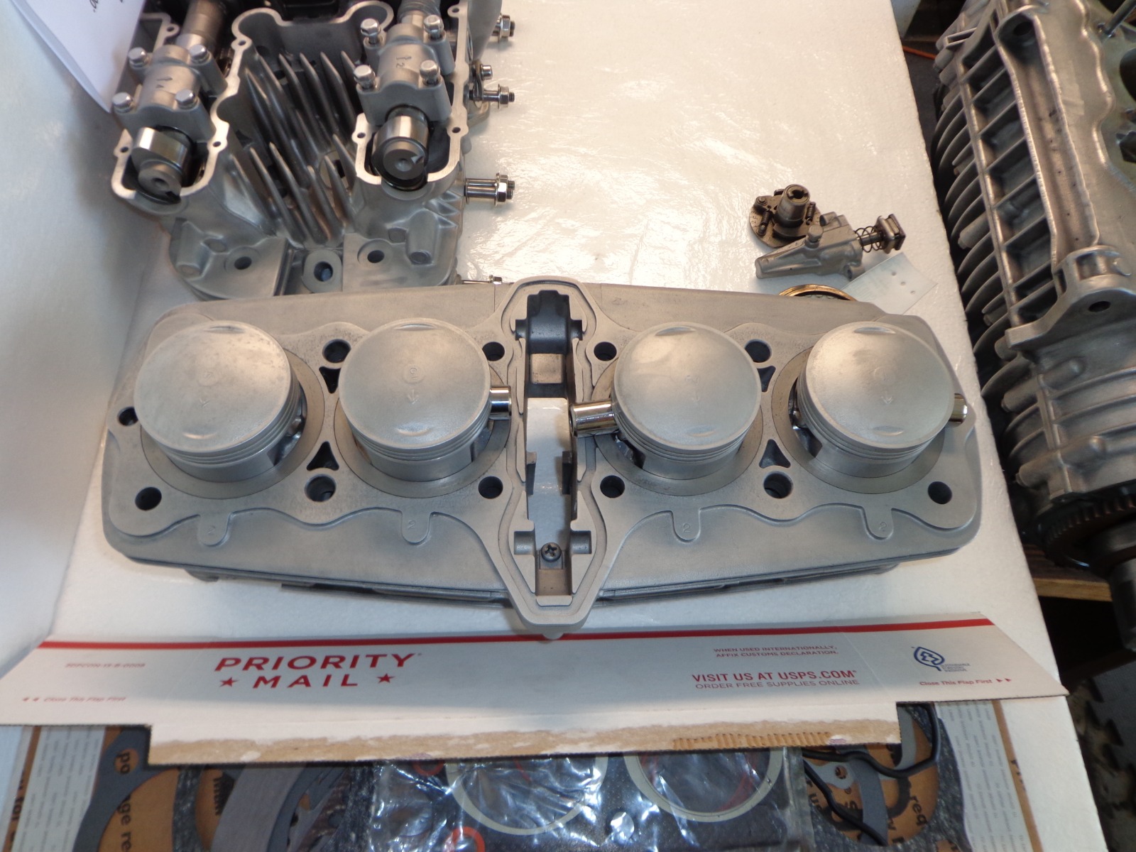

This Head was ready to install with shimmed stock cams. The pistons were not installed just sitting in bore.
I was proud of this one. I even polished the side covers! I made jigs to hold valve cover up a 1/2" to keep off unbolted cams. This way the orange straps held the engine to the skid. And a wood frame cage, with lots of stretch film.

First off z1kzonly seriously nice work on that motor, i would eat my dinner of that, second Irish people tend to get all defensive when suggested that we all know each other but the reality is that he is probably my second cousins best-friends husband and i have more than likely been at a rally where he was at the same time. I go to the vintage Japanese shows when i can, well apart from this year and ill look out for a bike with that tail piece, it will most likely be a stretched out streetbike as there is little or no drag racing in Ireland these days, be safe mate.
