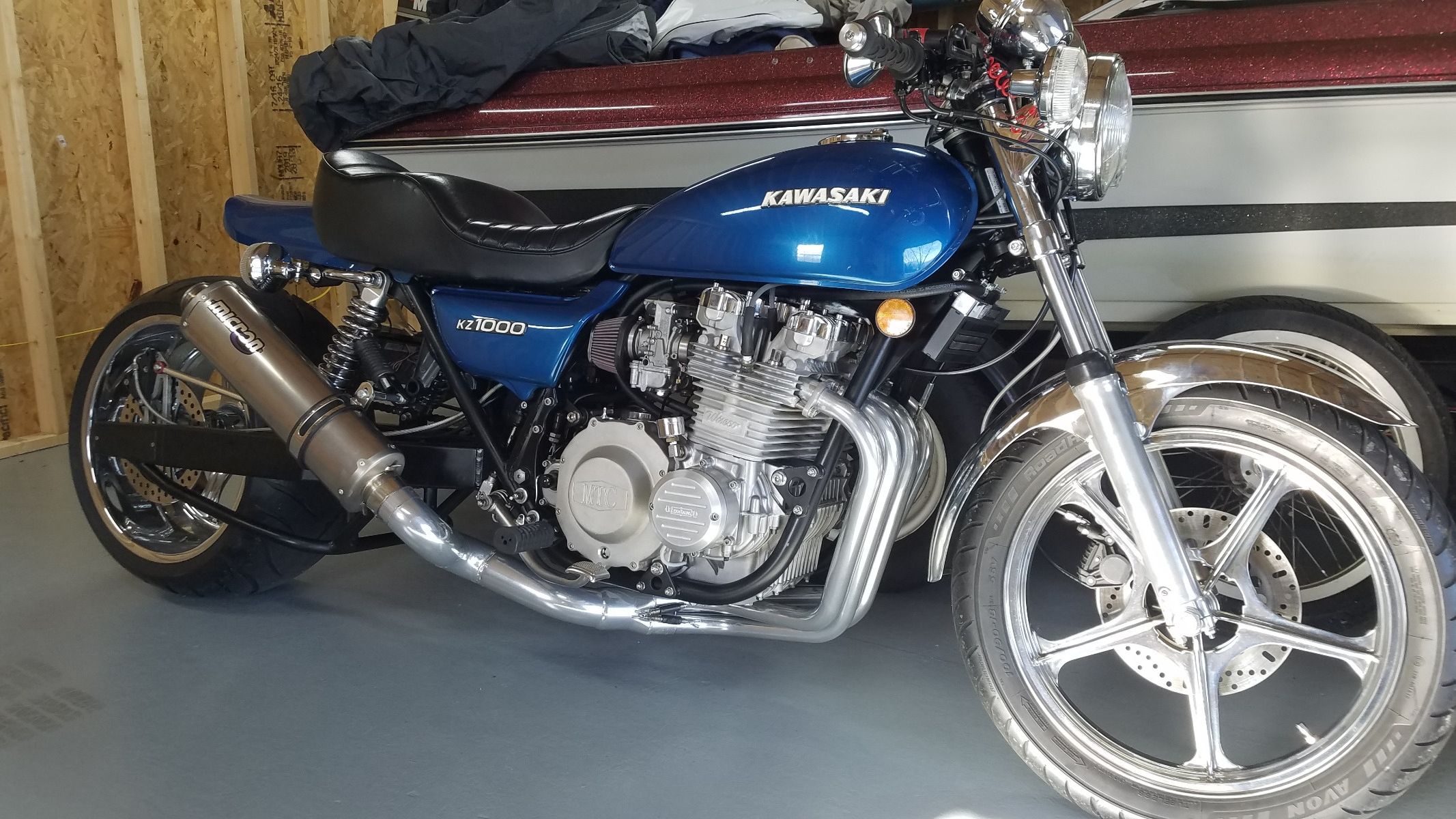

Well. Its done!!!!!!

I fixed your pictures so all can see easily
Nice work

1977 kz1327
Cavanaugh Head 38.6/33
38mm Flatslides
MRE racecut trans
300mm rear tire
Web Cams 435/465

Wow - Very nice! Is there an airshifter buried in there somewhere? I see a pneumatic line in the pic, but no cylinder. Just curious...

Yes there is an air shifter. When I take it to my welder guy and we do the exhaust I'm going to go ahead and get him to weld the bracket on to the shifter lever and then get the cylinder mounted. I already made an aluminum Mount that actually is attached at the left side motor mount if you look closely. Thanks for the approval.

The chromed non Smog valve cover is like bike porn, you have done a great BOTM build Tom!!!

Yeah, I found that valve cover a long time ago and I also have the spare at the house if I ever need to do another one. Seems like it just makes it a little bit cleaner without the block off plates

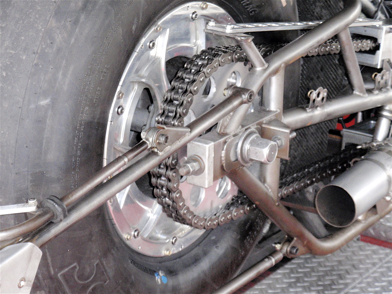

z1kzonly wrote: Hope that is the best EK or Tsubaki Top Fuel heavy duty chain you bought.
You mean something like this?:) This pic is of a T/F Harley. Taken in the pits at Topeka at few years back. About as heavy duty as you can get. Looks bombproof.

Well, got the motor broke in. Valves readjusted and degreed and pipe back from Jet Hot. Amsoil 20w50 and took it out today. Larry Cavanaugh told me this motor was gonna try to pull my arms off. Took off, shifted into 2nd, as the rpms hit about 6500 or so at about 50mph or so, the back tire broke loose and all i could do is smile. This thing pulls better than my other KZ that had a 1385 with a ported kz head. Huge thanks to my motor buddy
