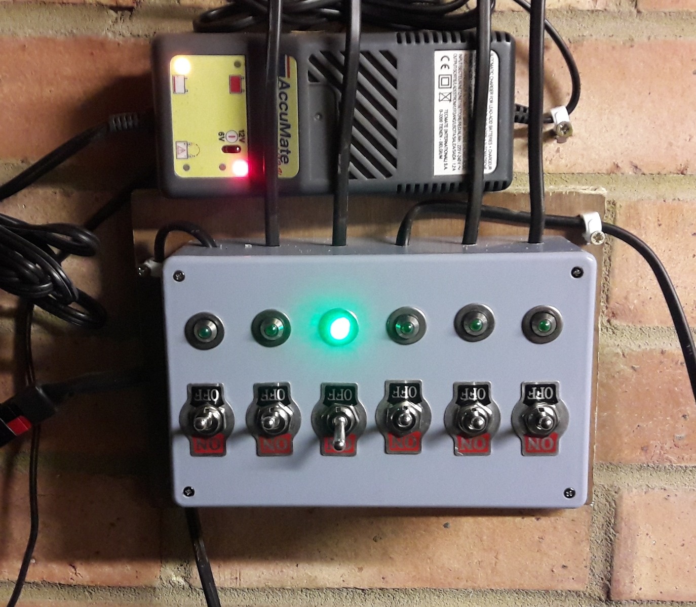

02 Apr 2020 08:33 - 02 Apr 2020 08:37For charging multiple batteries, I would tend to agree that the switching setup warren posted makes the most sense., if someone wanted to fabricate it. It makes use of one battery conditioner for multiple batteries without conflicts arising from different battery conditions.
Of course all of the fabrication can be eliminated by simply moving the conditioner cable from one battery to the next.
