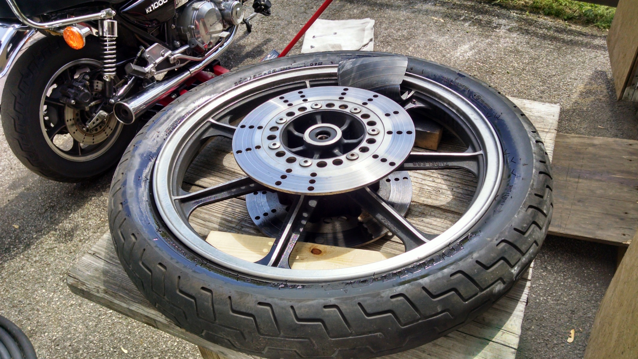

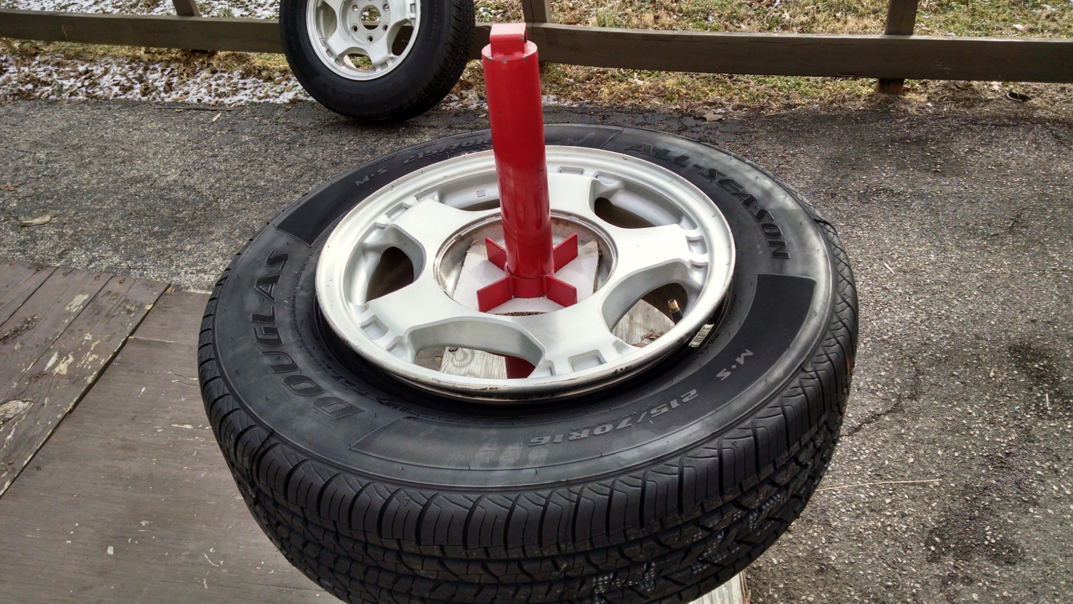

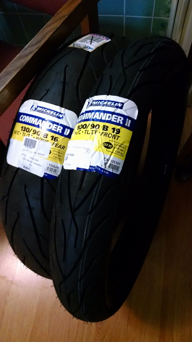

WOW, that is a NICE tire setup! Is that the NO-Mar changer? I have a harbor freight manual tire changer that I use to pop the beads on both sides, then use tire tools with the wheel laying on a few 2X4's to prevent putting pressure on the brake disks. I mainly use the manual tire changer to mount and fix tires for my truck. To keep from taking up the floor space, I bolt it to a section of plywood to hold it still while in use, then unbolt it and store it again in a corner of my little workshop. (check out that back tire on my bike. lol)
After `5K miles, these Michelin Commander II tires still look great. The Dunlop D404 on the back in the pic also has ~5K miles.

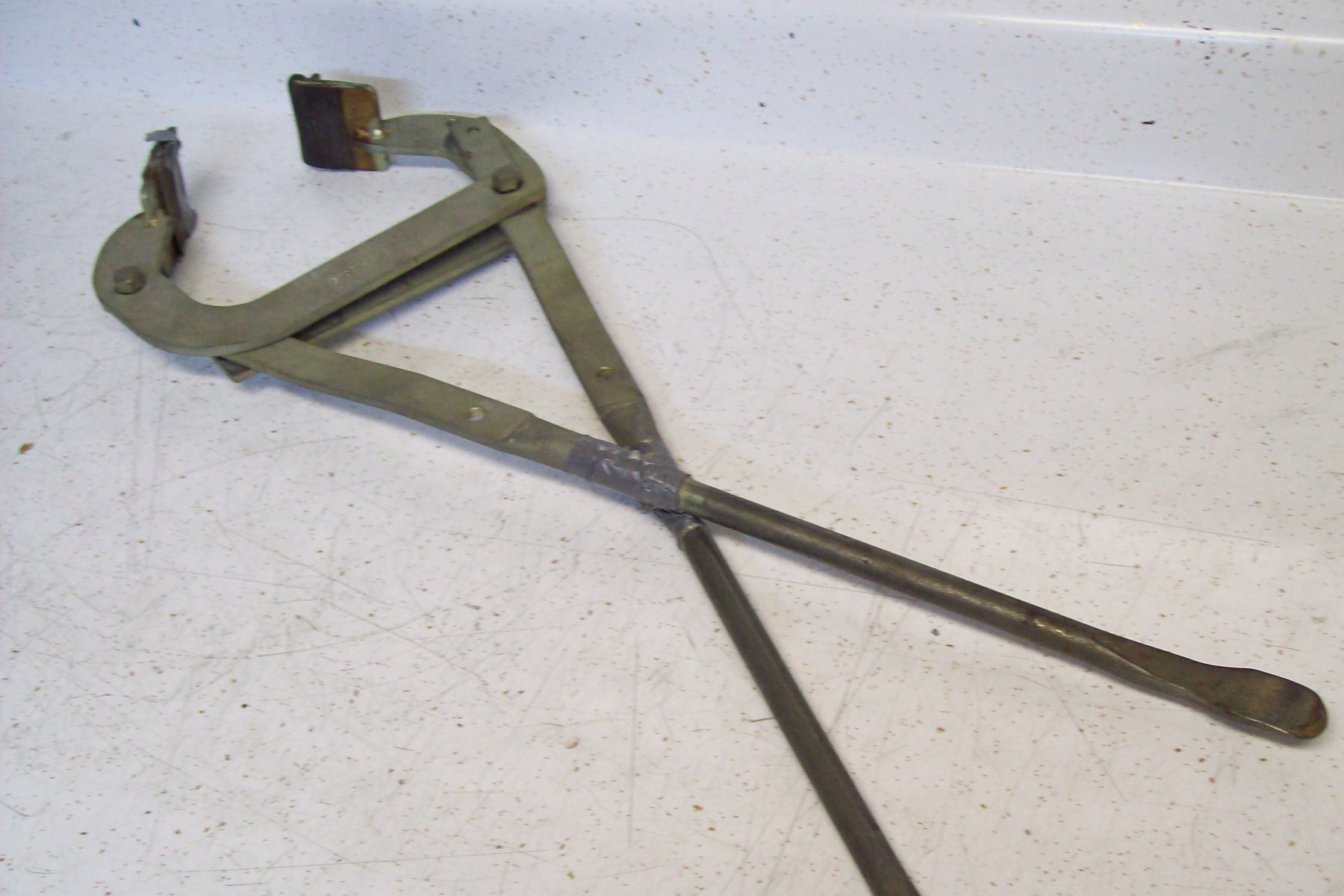

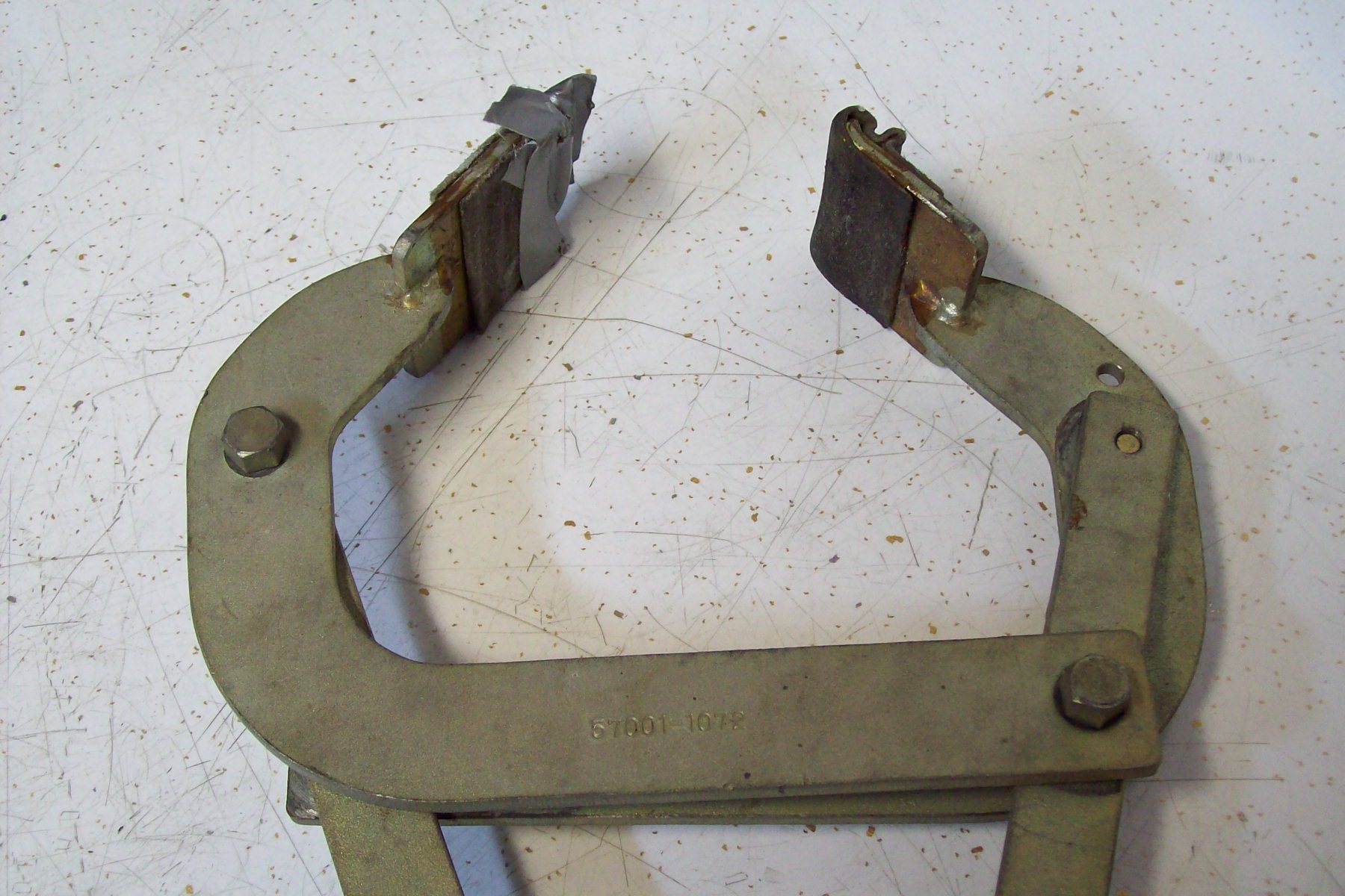

The hardest part is breaking the bead loose on the tire. I got this fancy tool with my KZ1000 S1 tool kit. It makes breaking the bead simple as hell!!!! Just had to put some duct tape on one edge of the jaws so in case it slipped off the rim edge it would not scratch it!!! The Kawa part number on this tool is 57001-1072.

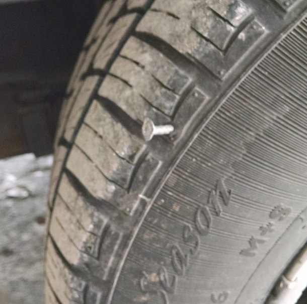

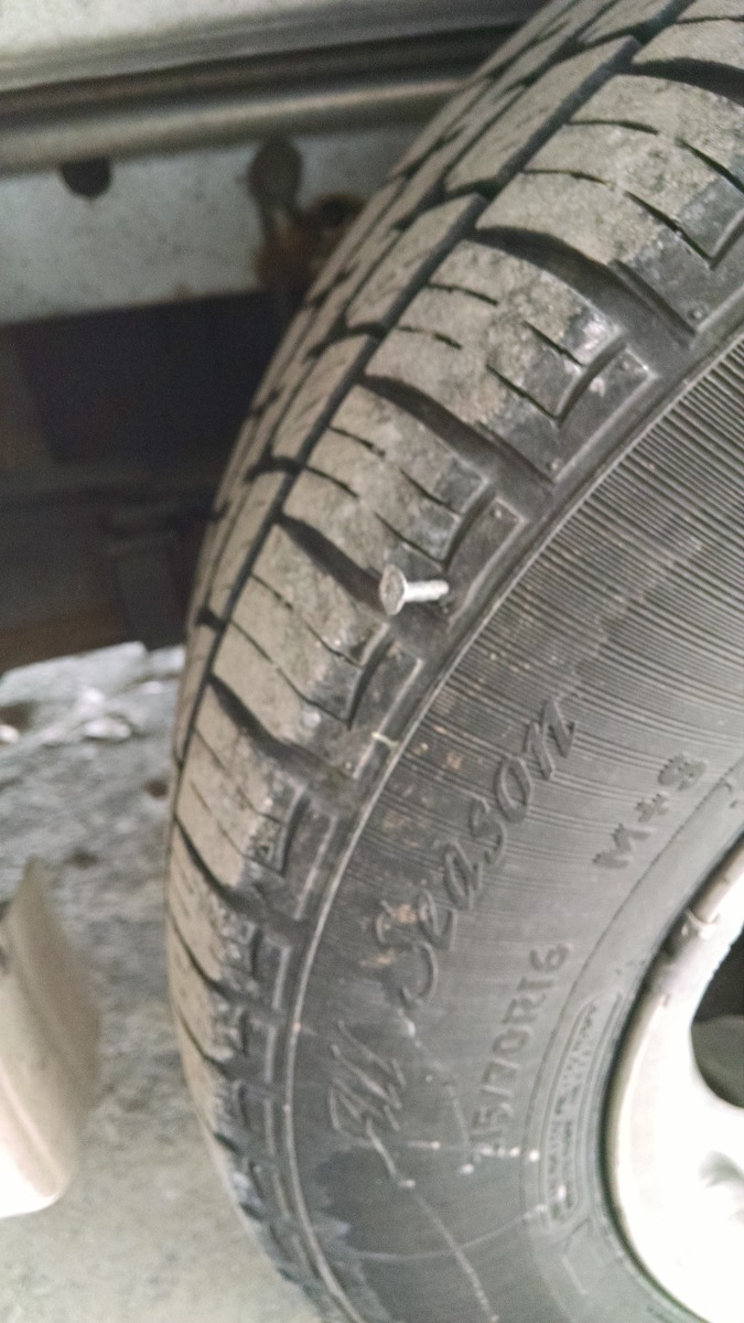

I've had to cut tires off before and it works well, just one thing I would like to add, use a brand new blade not a rusty old dull one
Flat tires on my truck are a business expense so I let the pros do it and write it off.
I had 2 flats last year from job sites, one was a drywall screw and the other was a pc of slag from an I beam probably
both where close to the same spot as yours, Ford and farm n Fleet told me that they would not fix the tire because it was too close to the side wall so I had to replace a new tire :pinch:
I went to Pomp's for the second one and they didn't care, they patched it and it's holding fine .

24 Jan 2019 09:38 - 24 Jan 2019 10:37I'll fix that one myself. I use a 3 /16" plug / patch I buy at NAPA. after I disassemble it grind off the inside. It's still sitting here waiting for summer. Holding air, since the nail is still in it.
