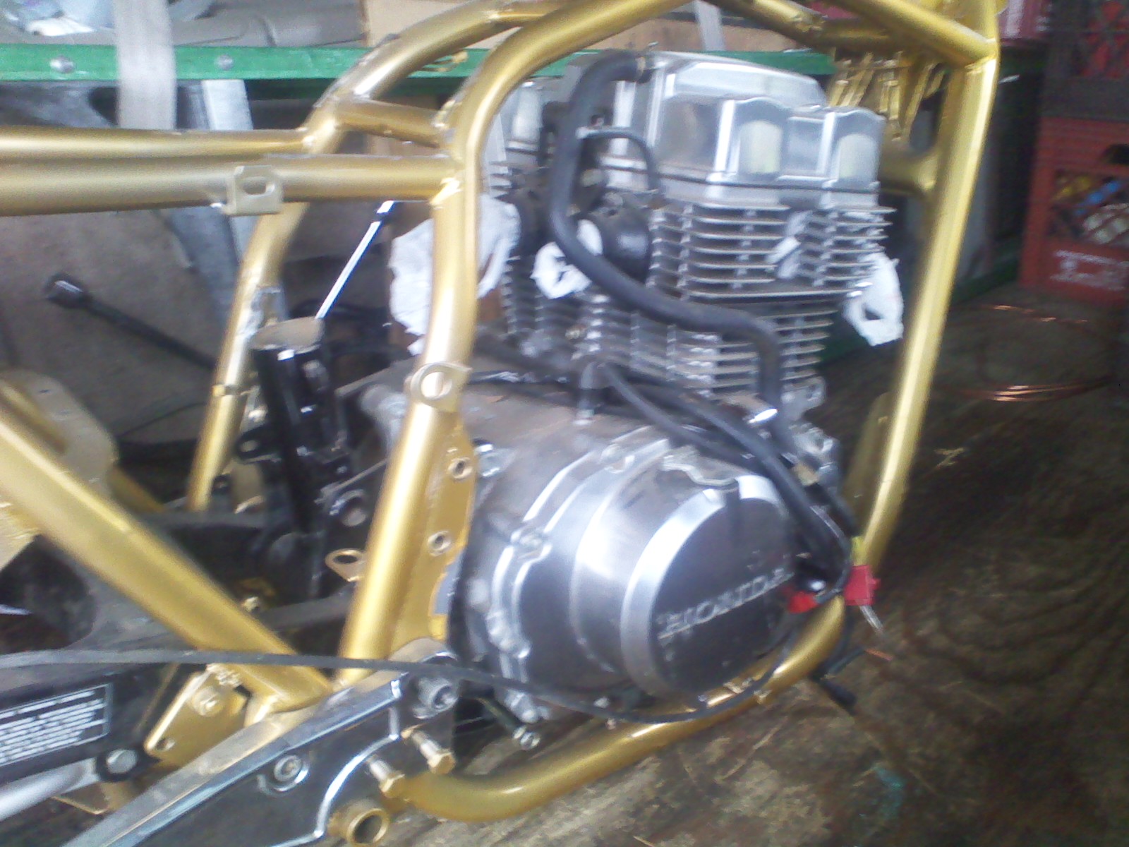

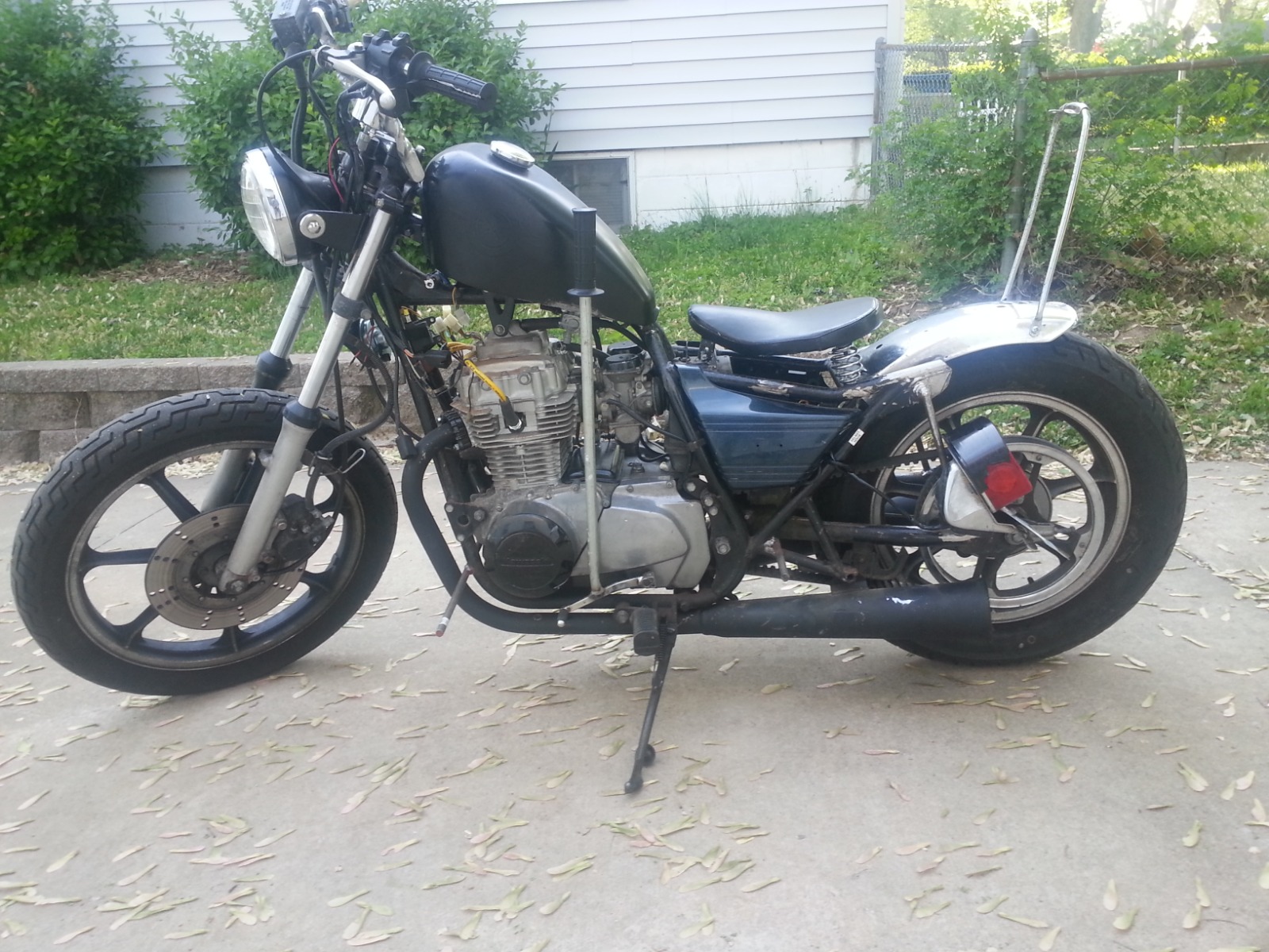

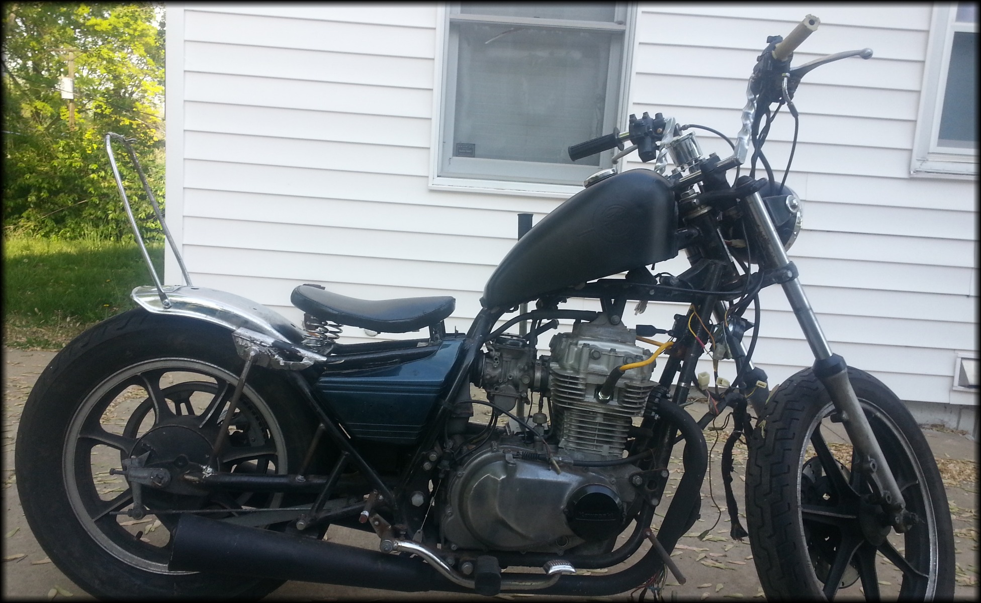

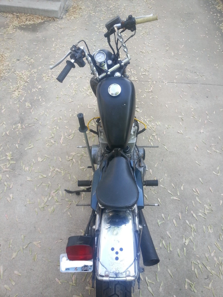

This is some excellent advice, that will most likely be ignored. Some pics and a little background of the bike would probably help us help you. Does it run? I assume no.. that would be a place to start. A Kz440 is pretty low on power to begin with, and almost every "upgrade" you mentioned will make it even slower, but HEY, at least you will know where it's at at all-hours of the day.. PARKED in your garage until you get tired of tripping over it. lol
Here is a Kz440, that this delirious peron thought I might be willing to trade for my running, titled, Iron-head sporty. OR willing to sell for $3200.00 outright. Ummm.. yeahright. Lots of custom just dripping off ot this abortion. OH, did I mention it did not run?. JUST needed wired. smh
1981 Kawasaki Kz1000K1
