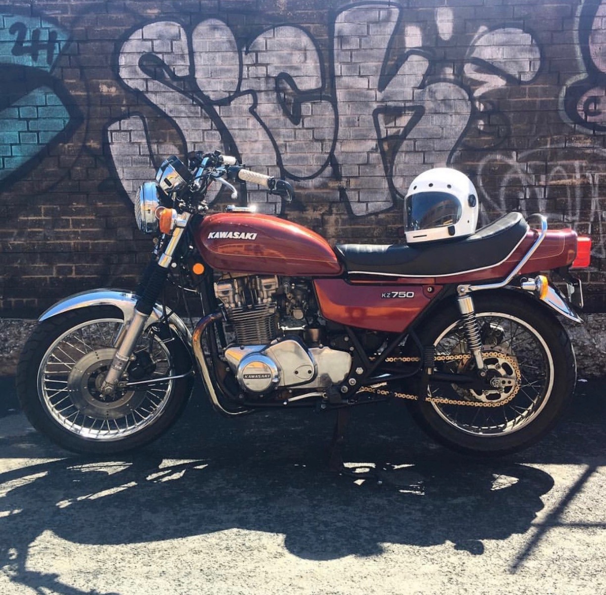

thank you so much for this. Its really helpful. Mrs says one of my bikes has to go if I get this one. So its between the 700 and this one which I already have. If I get the 700, this has to go
1977 Kawasaki KZ650B
1977 Kawasaki KZ750 Twin
