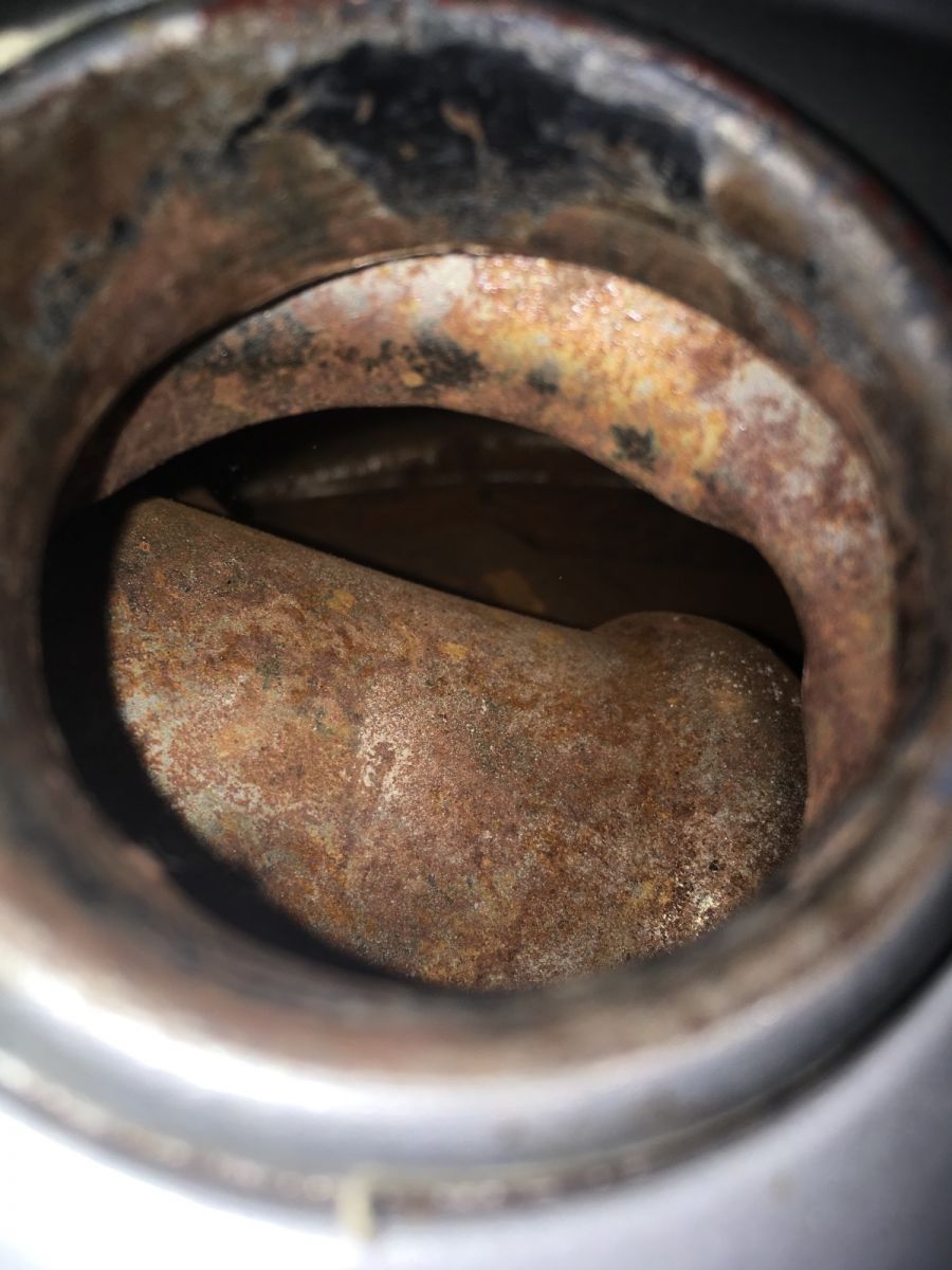

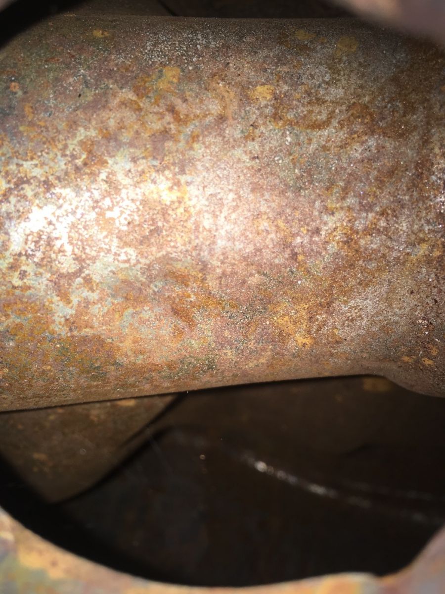

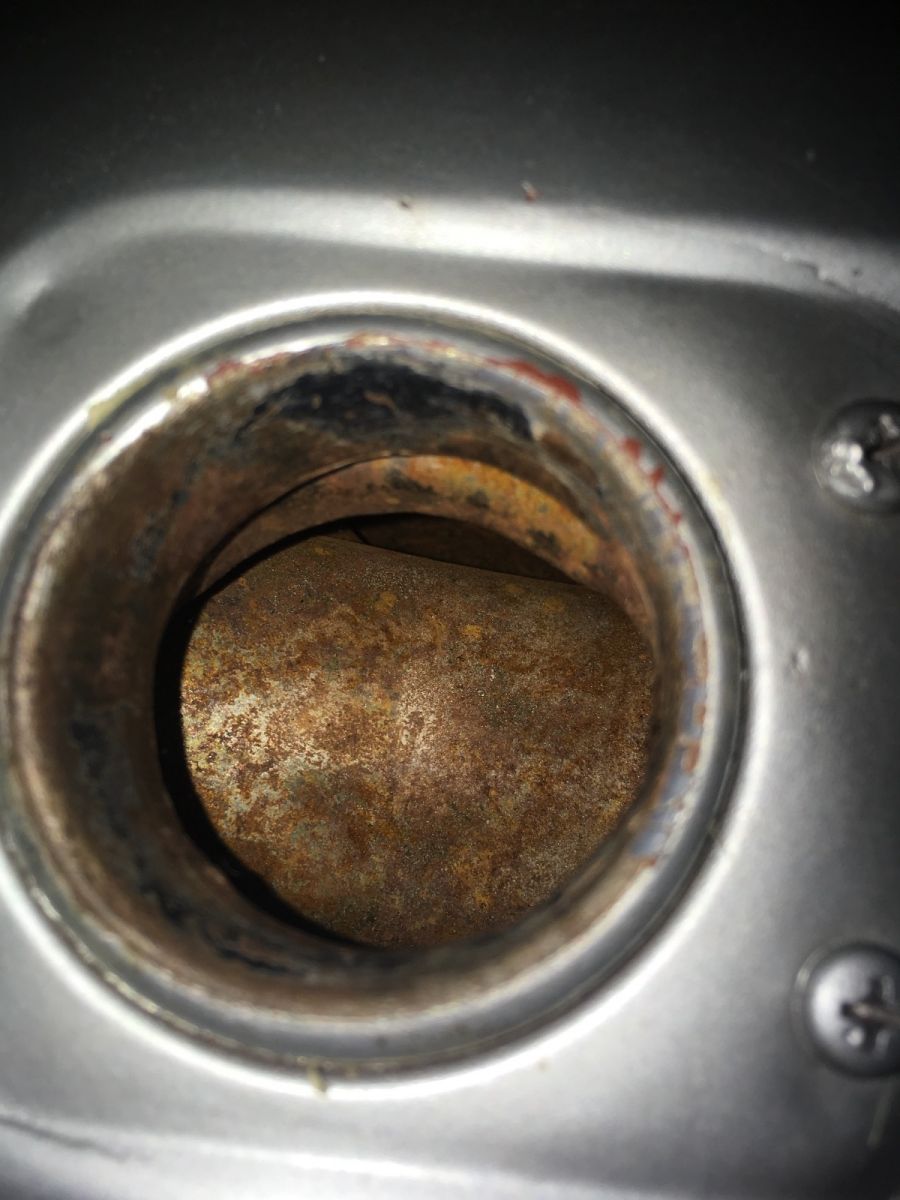

Yea ill probably do a clutch inspection before making a choice, that'd be more logical. Maybe replace it when i do the full rebuild.
as fo the tank liner, wouldnt it be more beneficial to just line it anyway? Ill take a picture of my tank rust so you can see how bad it is. But speaking of oil, any brands you suggest? i heard Mobil was one of the best for older bikes.

Avoid the tank liner unless it is absolutely necessary.

ill definitely be looking in to all your suggestions, thank you! I'll get a picture of my tank soon so you can see how bad it is, and what you suggest. And also, im using vinegar, and bb's to get all the rust knocked off, ive read many things online that say it's a really good way to get rust off. then using baking soda and water, and acetone to remove all impurities/ moisture.
