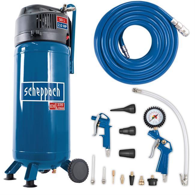

Air tank is to small.
I use this kind of compressor, need less or same room as yours and comes with a lot of accessory parts for 120 Euro.

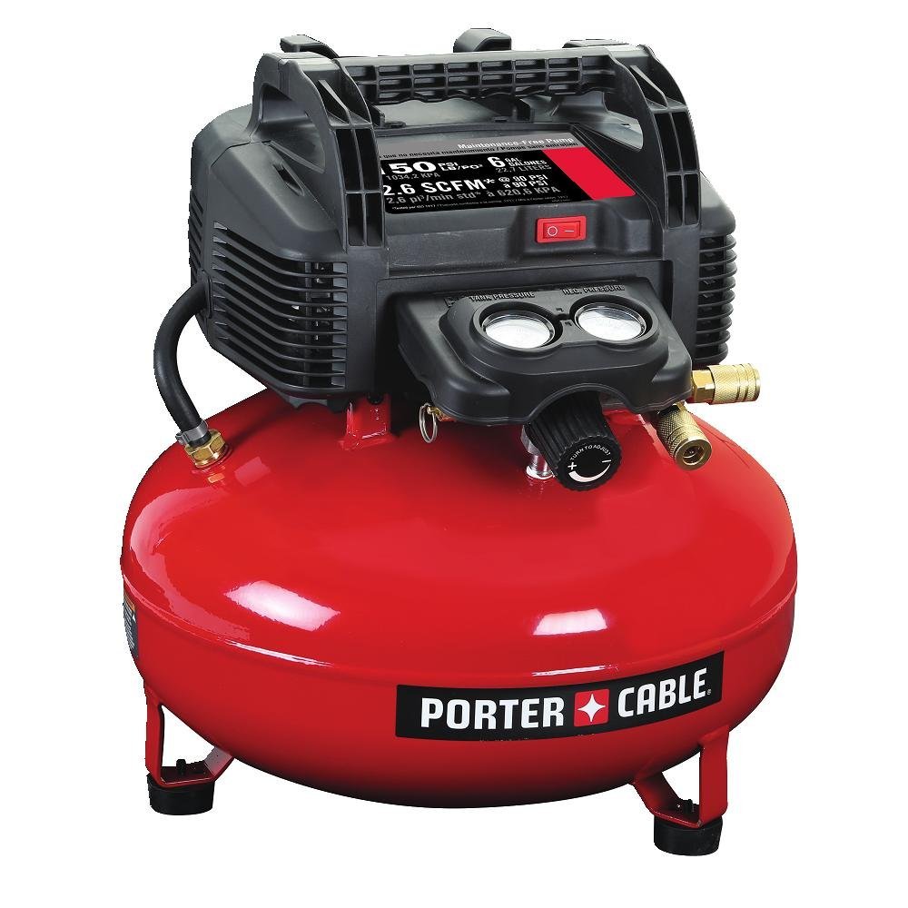

I have an 80 gallon compressor and it constantly runs using any blaster. I also have one of those pancake compressors, they ARE NOT used for blasting type tools, even pneumatic rotary tools. They are for nailers/staplers only...maybe an airbrush.
