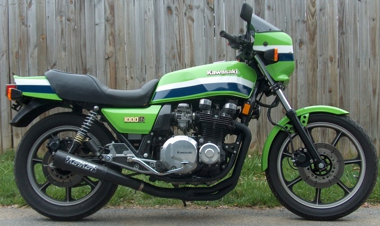

Your bike is very very neat. Well done it looks great! Shoot man hope I can do the same man.

Thanks and just take your time and do not get into a rush to finish. It took me 15 years to get mine to where it is today.

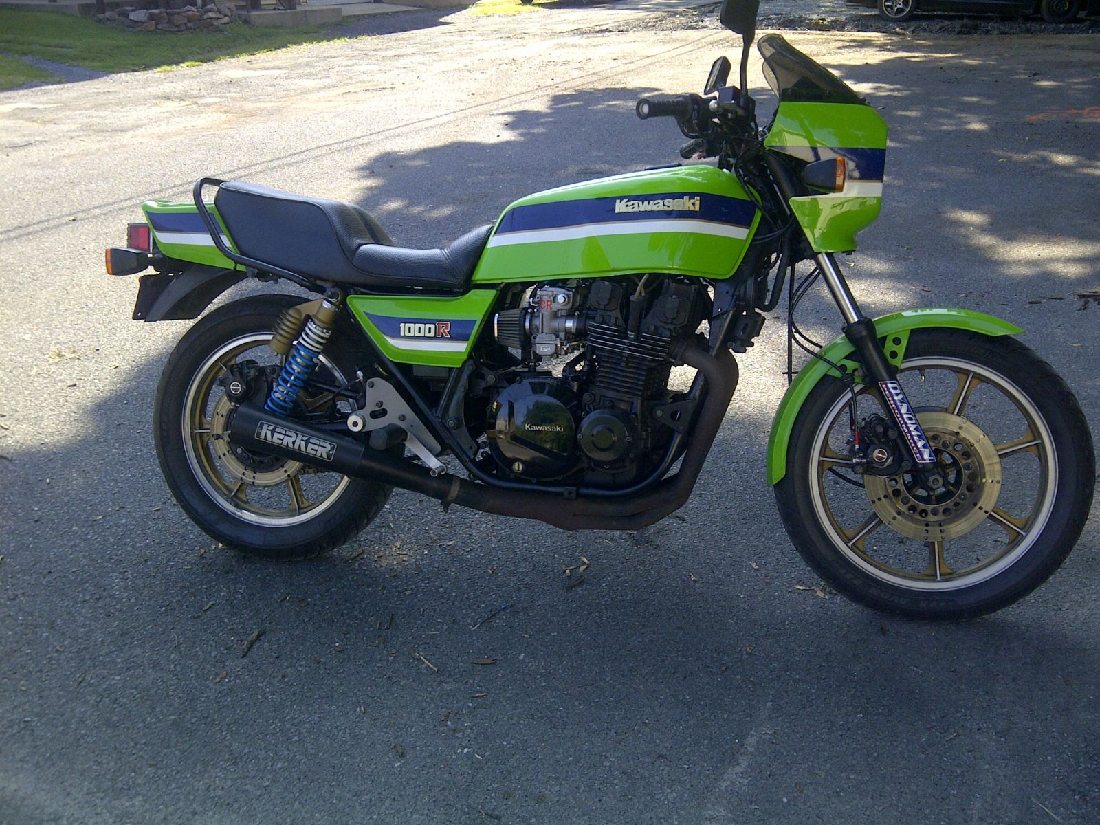

. An easy and quick check to see if it's a real ELR is to take a look at the rear rim. It should be an 18X2.50, the standard size for KZ1000 is 18x2.15. Kawasaki used the 18x2.50 on the ELR's and Police bikes. ...and the GPz1100 B2and 1000j3 I think. An ELR must have an R in the vin. Beware there is a lot of lawson rep 'replicas' about, paint it green, scoop the seat and change the badges
Fire damaged bikes are difficult restorations , my ELR was fire damaged too. A lot of donor parts can come from the 1000J and GPz1100 but some genuine R parts are virtually impossible to find, genuine seats for example.
Fire will likely have destroyed all the difficult to find bits: wiring looms, plastics, electronics, clocks, fuel tank, seat etc etc etc, You'll be ebaying and searching for very rare parts for years to come.
I guess an ELR is worth £5000 plus in uk, maybe double for a minter but they don't often come up for sale.
The frame and yokes has different geometry, so there is more to an ELR than just marketing hype. They are probably among the most sought after later kawasaki collector's bikes and well worth having, just this will be much harder to restore.

Thank you for your post, yes I am keeping her for sure. Kawasaki South Africa confirmed today that she is 1983 ELR. Like Baldy said just gonna take my time and enjoy restoring her. Got a lot of spares with the bike like bikini fairings seats tanks, but no gauges. If I have time tomorrow I will post more pics of the bike.
