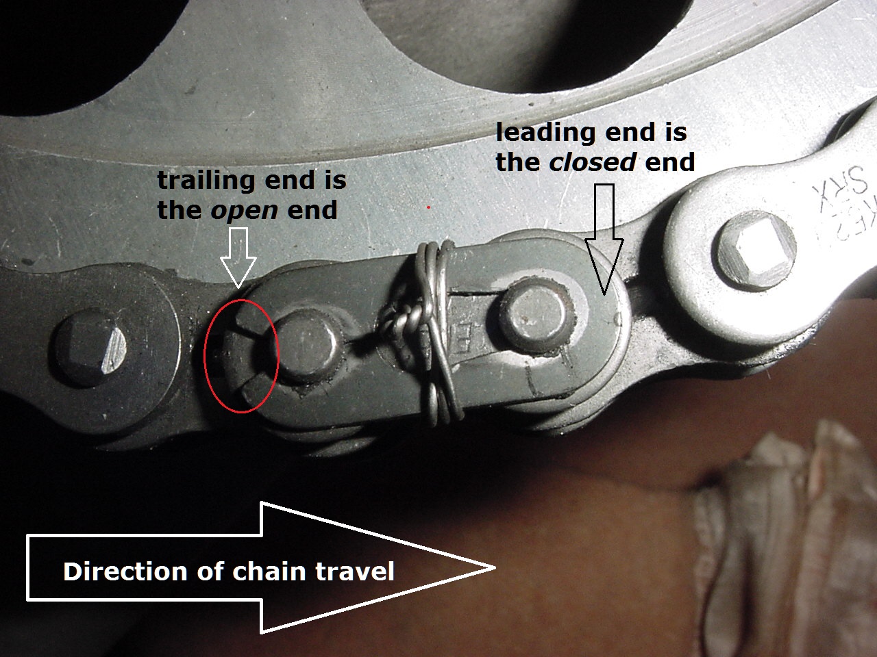

Perhaps everybody already knows this, but it's important when installing a master link that the open end is supposed to trail the closed end as the chain travels around and pulls the rear sprocket.
I believe that such orientation is to reduce the risk while riding of a stone or other road debris hitting the open end and dislodging the master link.

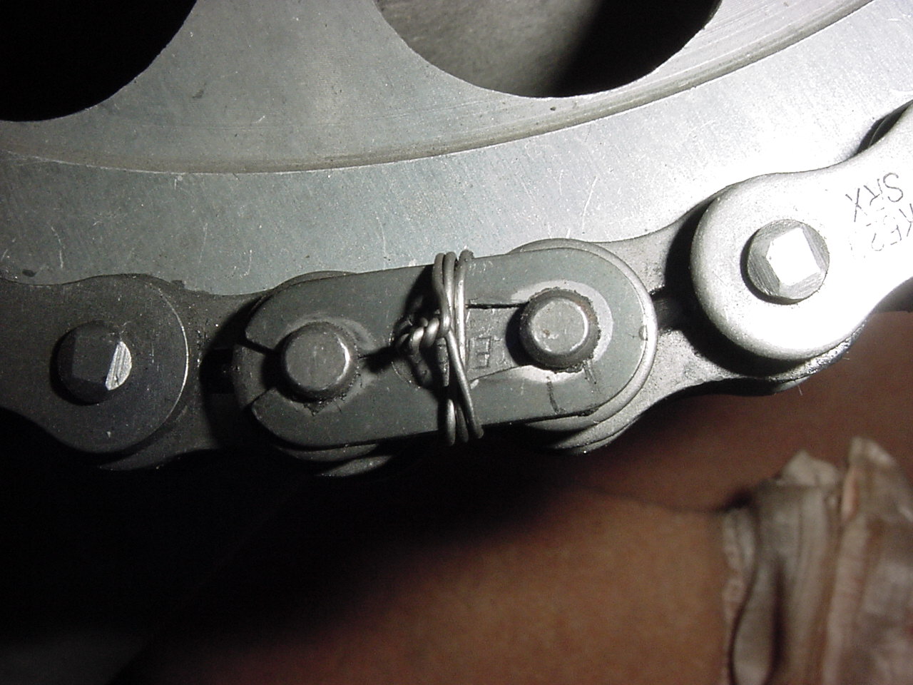

Re: Doing maintenance is GOOD!
21 Aug 2016 08:30
I always safety wire masterlinks. It helps keep the clip from disappearing and it is easy to see to make sure the clip is still in place.
