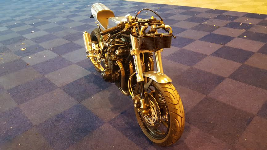

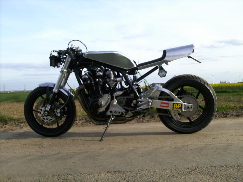

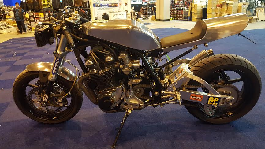

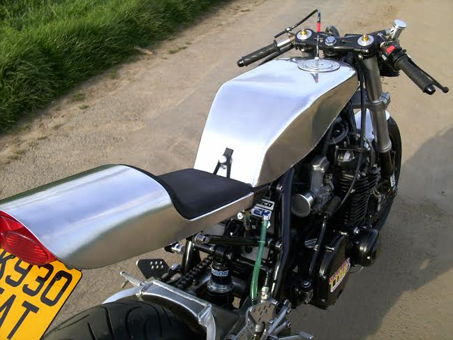

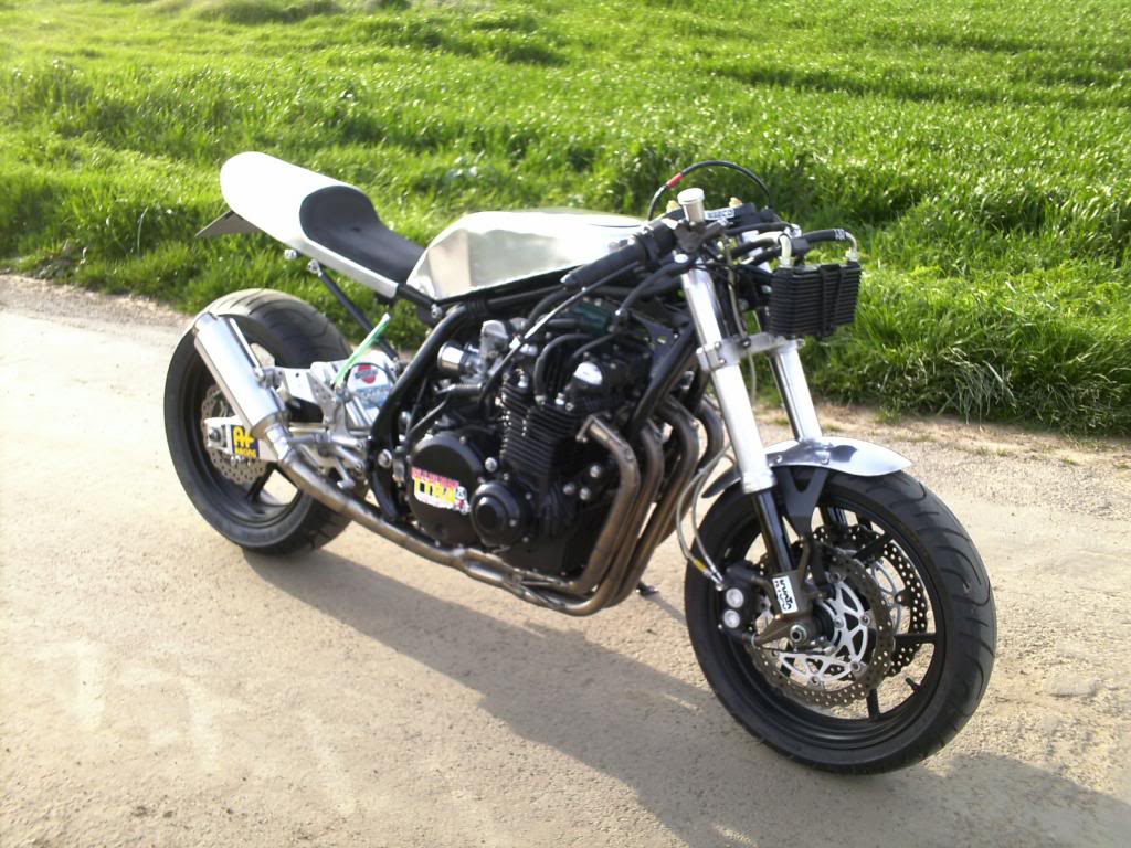

Its the last month of the year and time for the last BOTM for 2016
Its also time to show off a modified machine as I do every other month
and do I have a winner for you all to see!!!!!!!!!!!! :lol:
Lets give a big KZR welcome to ZED1015 and his incredible machine :laugh: :laugh: :laugh: :laugh: :laugh:
Zed ( Rob Meggitt ) got bored one day and decided to build another project bike, and am I glad he did..
He started a build thread 6 long years ago and the results are over the top..
ZED titled his build thread New Project , 1428 turbo or supercharged , who knows
Well, No 1428 , No blower of any kind but still a one off beauty that is a true work of art !!!!!
Engine is a KZ 900 with 1015 cc Handmade header, ZX10R front end , Gixxer 1000 swingarm and the frame came from a Zepher 750
Other than that ZED made the majority of the bike in his shop
So please join me again in congratulating ZED 1015 to being our December Bike of the Month
Here are a few shots to go along with our cover page fader which also shows our Bike of the Year
Absolutely a Killer Machine :woohoo: :woohoo: :woohoo:
Have a ball checking out Zeds custom work

Bloody nice, love that black headlight :laugh: :laugh: :laugh:

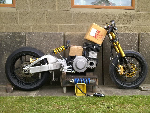

And Just remember :pinch:
It all started out from this mock up
This is ZEDs first picture in his build thread
My How Things Change :side:

01 Dec 2016 14:51 - 01 Dec 2016 14:52What made you abandon the rear shock setup, and what shock are you using currently?

There are several reasons.
One is that I found a lighter and nicer GSXR1000 swinger in my stash which I felt the bracing maybe wasn't suitable or strong enough to take a cantilever mount so I went with the Suzuki rocker arm and dogbones and another is that the top mount wanted to occupy the same space as the fuel tank baffle box.
The shock was a bandit 600 with an R1 spring but I have since fitted a custom Hagon shock to my spec as the bandit one was a little harsh.
The blue springed Buell cantilever shock and Srad arm hasn't been abandoned though and will find it's way on to my next Zed build.

Holy Shnikeys, that is some nice bike. Love all the one-off stuff and home made tank and tailpiece. Man, It is sure nice to see the talents of people on this site who have the vision to create something this cool.
Kudos to you Rob for a great build.

Very impressive piece of machinery!!!! Work of art might be a better term to use.

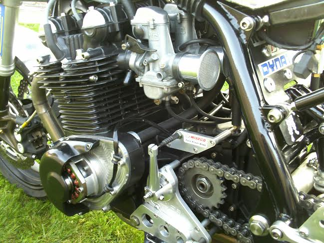

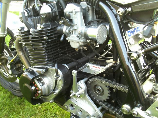

I don't know if the dry stator setup, or if the hand formed fuel tank gets my award for neatest part on the bike.
Congratulations Sir on a true piece of motorcycle engineering.

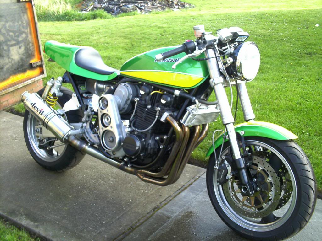

Here is a fine ride ZED built in the past Just to spice up the Bike Porn
