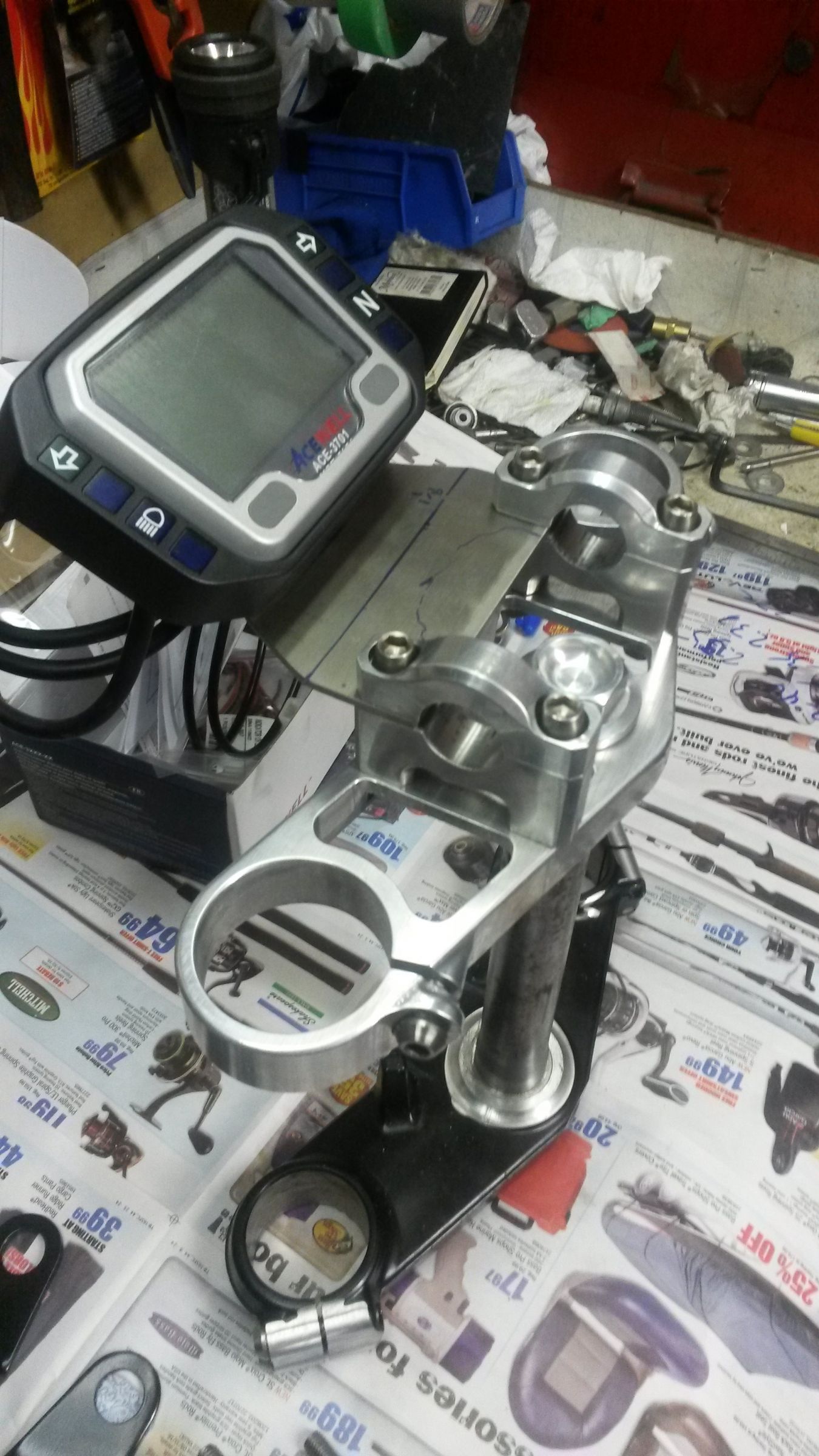

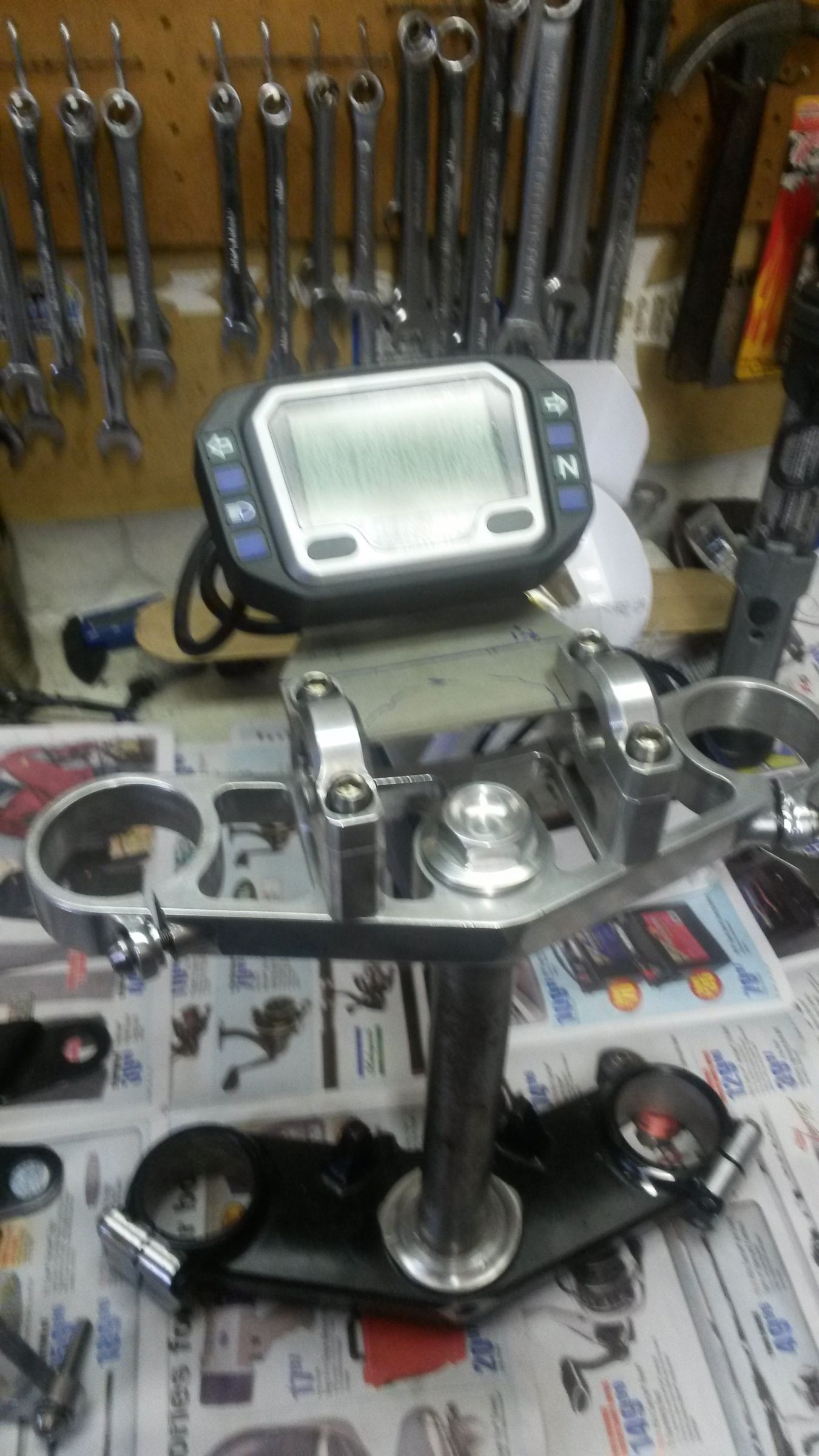

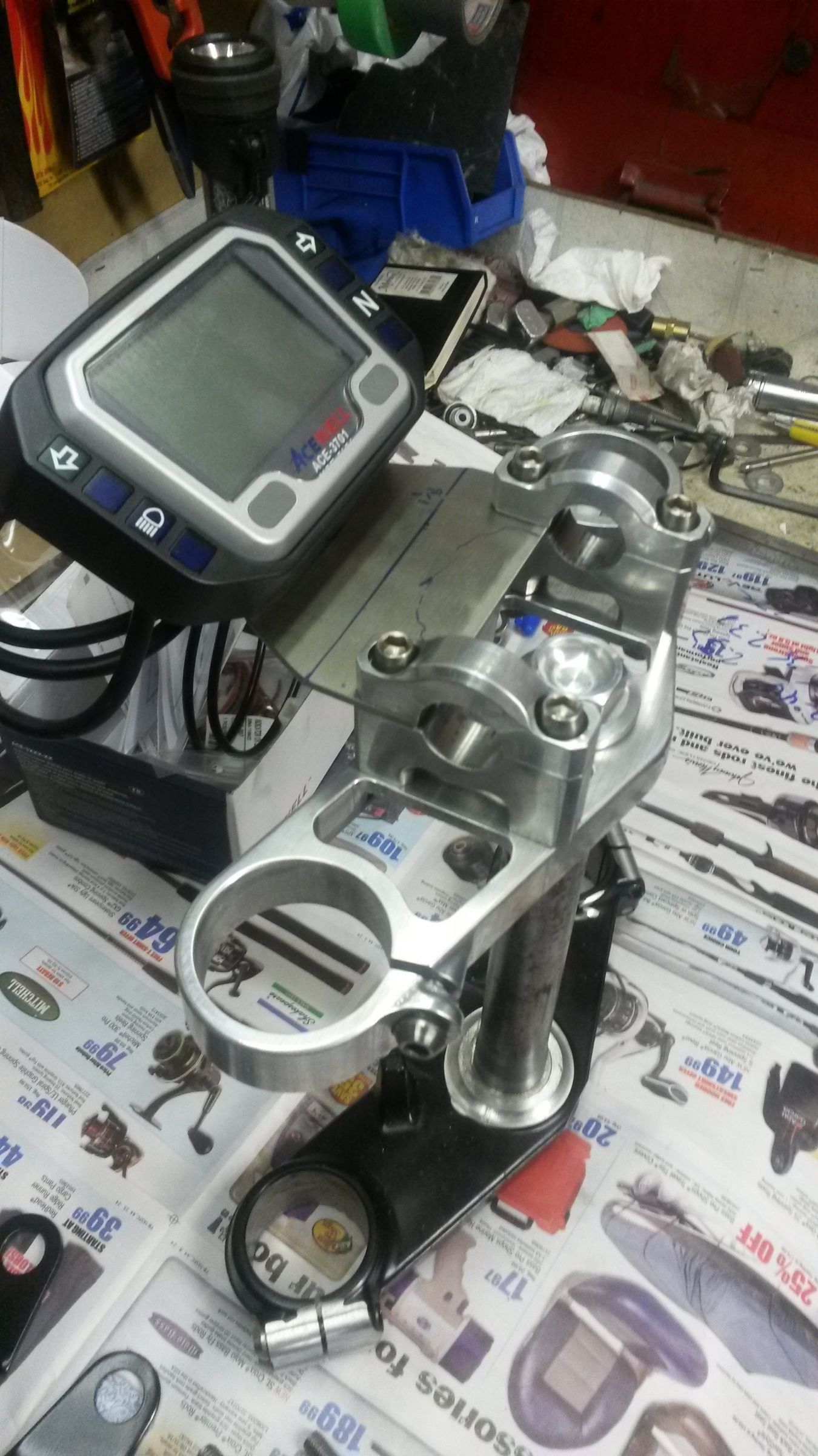

I have a frame from a '78 kz 1000 LTD that was damaged and I wasn't sure it would be easily repaired which I recently was told no problem. I have a friend who was able to send me the damaged piece of frame and I had a good friend do the repairs. I now have the frame back with a set of cases in it for mock-up and will try to get at it during the Christmas slowdown. The engine is ready to go but I did not attach the pistons, or slide the cylinders on until later. I have a zx600r swing-arm sized to fit and the forks, wheels, calipers and triples for the project. I want to try and make a bike for short distances like the coffee shop on Friday nights or breakfast Sunday.
As I have done two restos so far, I would like to try something a little more radical as others have done so well on this site. It seems that everything I tackle becomes the three year plan so will try to take relevant pictures along the way, unlike past builds.
Will load some pics of work to date. Calipers have been rebuilt, triples machined from the zx600r for regular handlebars,and digital dash bracketry completed.

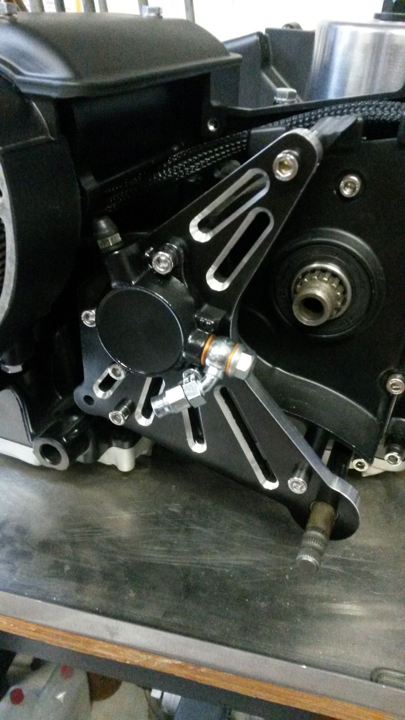

I Love the Hydraulic Clutch setup

I love it too! I can't believe what a difference it makes over the stock setup, it almost makes you want to shift more. The stock worm drive actuator is pretty difficult to operate and when you add some Barnett clutch plates it is even worse. I guess that is why the later version of the actuator changed and had small balls inside the ramp. gotta like technology when it makes fun stuff easier.

On my Frankin (GPZ1100) bike I have the 3 ball actuator and I'm surprised at how good this system is compared to the worm drive. My Z1R has a GPZ900R hydraulic but I have to admit the 3 ball system feels better. Maybe when the cable gets old this will change. I don't know how the manual actuator will behave with stronger springs etc.

I mis-stated Barnett clutch plates in my previous entry, it was Barnett clutch springs only. I always use stock clutch plates but like a little more positive grab on them that the heavier springs offer. When I did my LTD I used the Barnett springs with the stock actuator which has the balls in it and feel is normal, however, when I used the same springs on The 900 with a NOS stock worm drive set-up I could barely pull in the clutch lever. It was at this point that my good friend suggested his mod of the Yamaha slave under the stock cover which was activated by a Magurs master cylinder. At that point in time, it was I am not going back to stock unless bike gets sold. I still don't exactly know which bike it came from but have since found a couple for the project using the above shown mounting plate. Now I have a spare if something should wear out and I don't know the model for seals as both were in mint shape.
