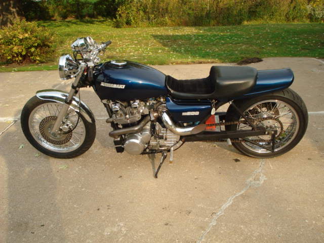

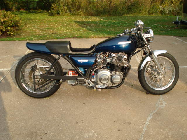

It isn't licensed as of now. It was but haven't had any time to hardly look at my bikes this year. Way too much work and not enough free time this year. It's very streetable though. I have only had it at the track once a couple years ago and made 4 runs. First one was only a 10.2. Then I ran two 9.83's at 143 mph and on last run, it stood straight up on me. Had a couple guys who were racing Busa's come up and ask me how I did that and I asked what. They said the bike was straight up and they swore it was coming over backwards but somehow I came down the right way. It felt high but not that high. It came down and quit running so I thought I hurt it but once moving it started back up and idled down track. I moved my legs to see if I could see anything wrong and it stopped running again. Sat back up and it started running again so got to end of track. Once there I checked it out and figured out that the carb had popped out of the manifold and when I moved my legs the carb moved away from the manifold and it would stop. When I sat up, my leg would push carb against the manifold and it would start running again. That ended the day though so I fix that problem. It's a fun bike to ride....love that sound of the turbo...
  • racer54
  • racer54's Avatar
  • Posts: 1902
  • Thanks: 114
Re: Re:Bike of the Month.
01 Aug 2016 16:48
#736990
As for the engine, starting on top, the head has had some clean up porting....nothing much. It has stainless steel valves but stock valve train. It has a small turbo cam with .340 lift. It sits on 1200cc turbo pistons with o-ringed cylinders and a copper head gasket. The crank is a welded Z1 crank with a crank support plate and the motor has HD cylinder and case studs. The trans has been back-cut also. Has an MTC snowflake lock-up under the polished cover. The turbo is an old ATP turbo kit with a Mikuni HSR42mm carb. The velocity stack was custom made and plumbed with nos. The nitrous kit is for ATV's and only set up for a 43 hp shot. Wired up to use while at full throttle and only while I push a handlebar mounted button. Haven't used the button yet. Been told that a turbo basically doubles the HP of whatever the nitrous would be on a naturally aspierated motor so it would essentially be a 80 hp shot....according to a builder who knows nitrous.

Here are a few more pictures...

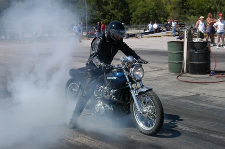

One from the track....
