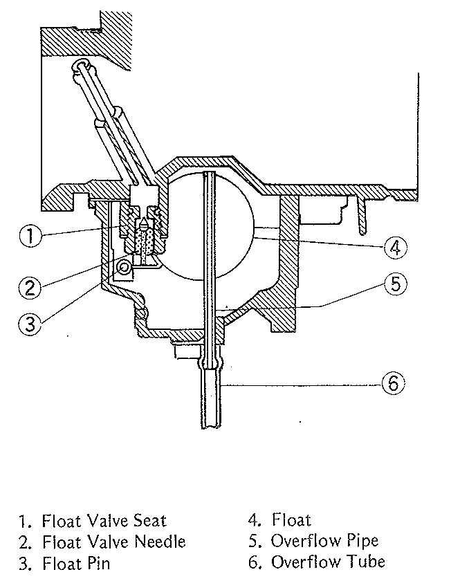

On these carbs there is a drain screw and a horizontal overflow nipple coming out of the carbs. It is not one piece like i have seen on other carbs. The horizontal brass overflow nipple has been dripping since I have had the bike. I found a post from 650ed which provides some potential causes of leaks.
1 - float valve not sealing - I took the bowl off the carb and cleaned the float valve needle and the piece of the float where the needle sits with a qtip and carb/choke spray cleaner. The bowl and underside of the carb looked clean. Did not fix issue.
2 - overflow tube broken - I filled the bowl up with water and there was no drip out of the bottom of the drain
3- fuel level is too high - I guess this is my issue. I attempted the clear tube method today with the clear tube on the horizontal overflow tube and just let the fuel rise because of the leak and it filled to about 5mm below the carb line. I am going to attempt this again tomorrow and loosen the drain screw to see if it causes a change. I do need to replace the drain screw because I do not think its original. Its a flat head screw and its all chewed up. I wonder if this could contribute to the leak.

20 May 2015 20:29 - 20 May 2015 20:43sleepinsilvia23 wrote: ... I guess this is my issue. I attempted the clear tube method today with the clear tube on the horizontal overflow tube and just let the fuel rise because of the leak and it filled to about 5mm below the carb line. I am going to attempt this again tomorrow and loosen the drain screw to see if it causes a change. I do need to replace the drain screw because I do not think its original. Its a flat head screw and its all chewed up. I wonder if this could contribute to the leak.
It is such a pain to get the bike leveled because the center stand is not on the bike.
Hi sleepinsilvia2,
I have the same bike as yours. What I don't understand is that the over flow drain should not behave as you describe, The correct fuel level is 4.5 to 6.5 mm below the upper carb body so your 5mm sounds fine. Unfortunately if that is the correct fuel level there should be no fuel flowing out of the over flow unless there is a leak in the over flow system. I've attached a section view of the carb. I know that it shows a vertical overflow drain but it's right out of the FSM.
I believe that the only way to set the fuel level is, as you attempted, with the wet method because I think that the alcohol in our fuels attacks the foam floats and makes them heavier.
