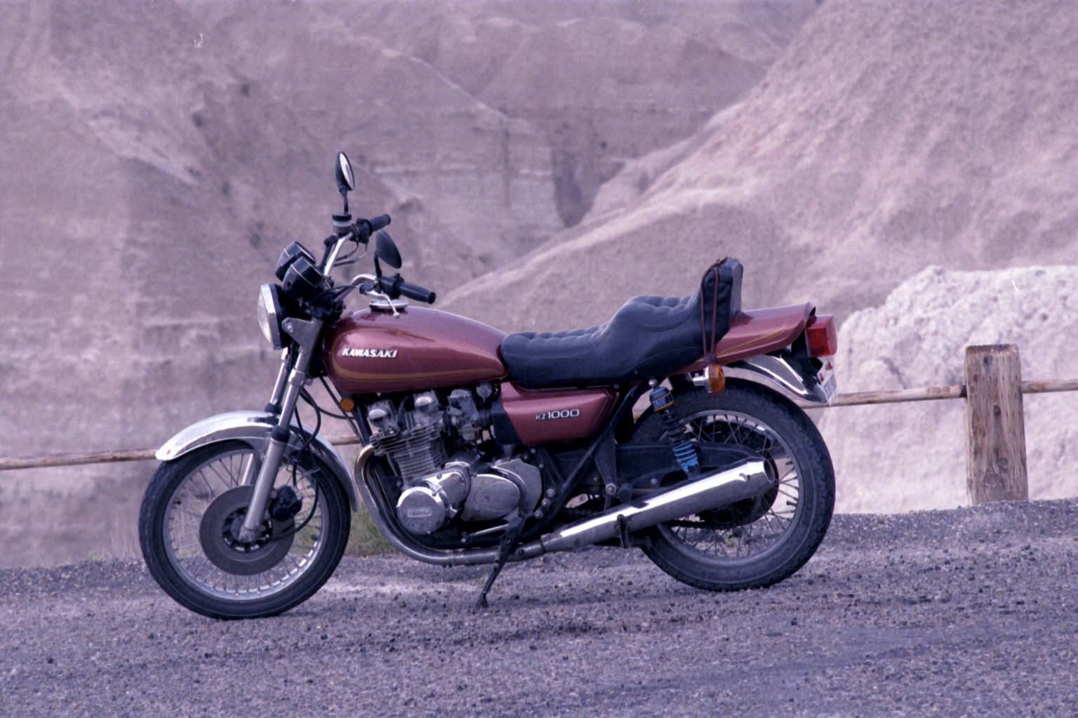

KZ900 LTD was replaced by the KZ1000 LTD aka 1977 KZ1000-B1 (starting again with "B1").
