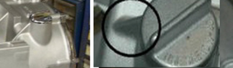

I went through a head I had checked out several monthe ago that I wanted to install on my current engine with another set of jugs and pistons.
I have four engines. Three Mark II's and a KZ1000.
I was comparing them to the pictures on this thread and lo and behold two of my Mark II cases don't have the ribs on the cases that are shown in this thread.
I guess someone installed mark II cranks in the KZ cases?
I'll get the numbers off and see what year engines I have.

Two of the engines I have came up as 1978 KZ 1000 C1A Police.
These engines have the mark II cranks but do not have the renforced ribs. ???
The one engine I have that has the renforced ribs came up as a 1980 KZ 1000 A4.
The other is just a 1977 KZ1000 A1.
I guess I will never know the true history of these engines.
The 1075 engine that came up as a police engine came from a drag bike I bought 12 years ago.
The other two I bought a couple of years ago. Roy
