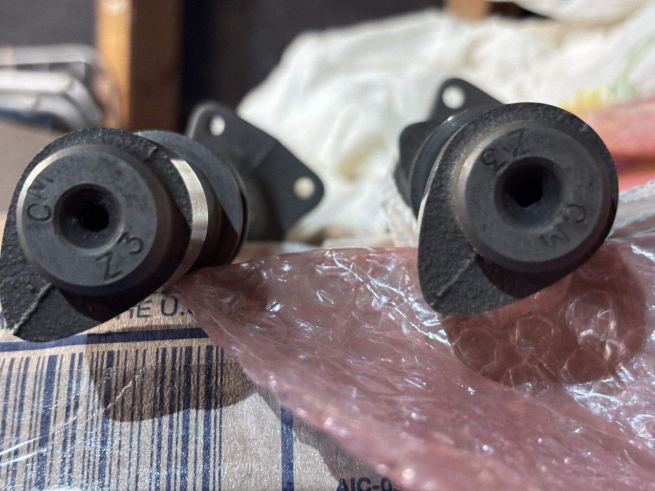

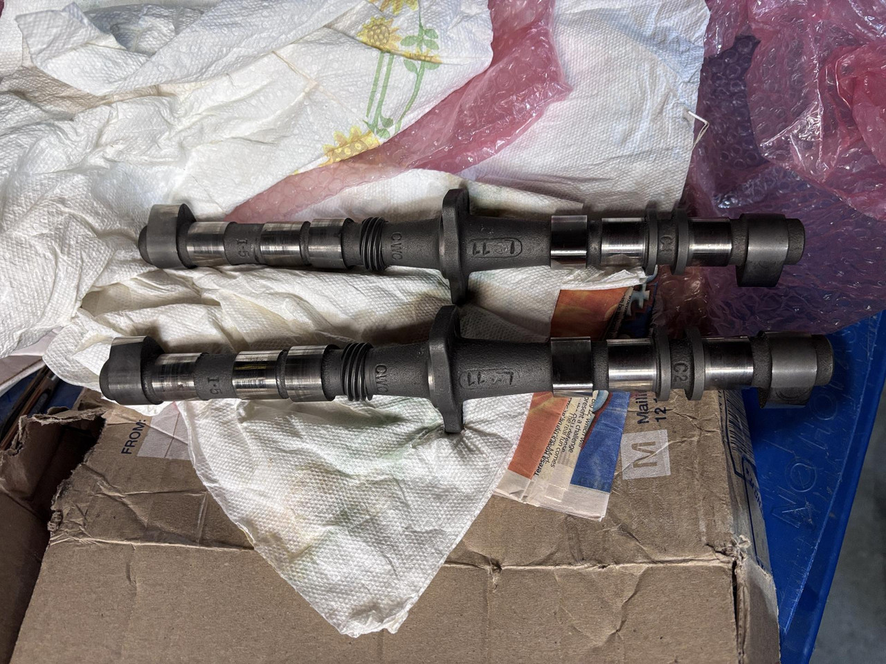

02 Aug 2026 06:56 - 02 Aug 2026 06:56No you were not taken as long as they are stamped the same at Z3.Just to let you know that this project isn’t dead, I thought I’d bump it to the top with a question:
I bought a set of used but very good condition CamMotion Z3 cams from Feebay. Opened up the package today and found two Z3 exhaust cams (both have tach drive work gears). I’ve never seen two exhausts cams used even in aftermarket sets: always 1 intake and 1 exhaust.
Was I taken for a ride by the seller?
Later, Doug
Custom cam grinders back in the day often used stock cores to spray weld and regrind so this is a common occurrence. WebCam also did this a lot when no billets were available.
I have two custom ground WebCam cams in my 650 drag bike engine both are old stock exhaust cams way bigger than most offered for the 650.
