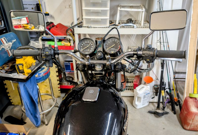

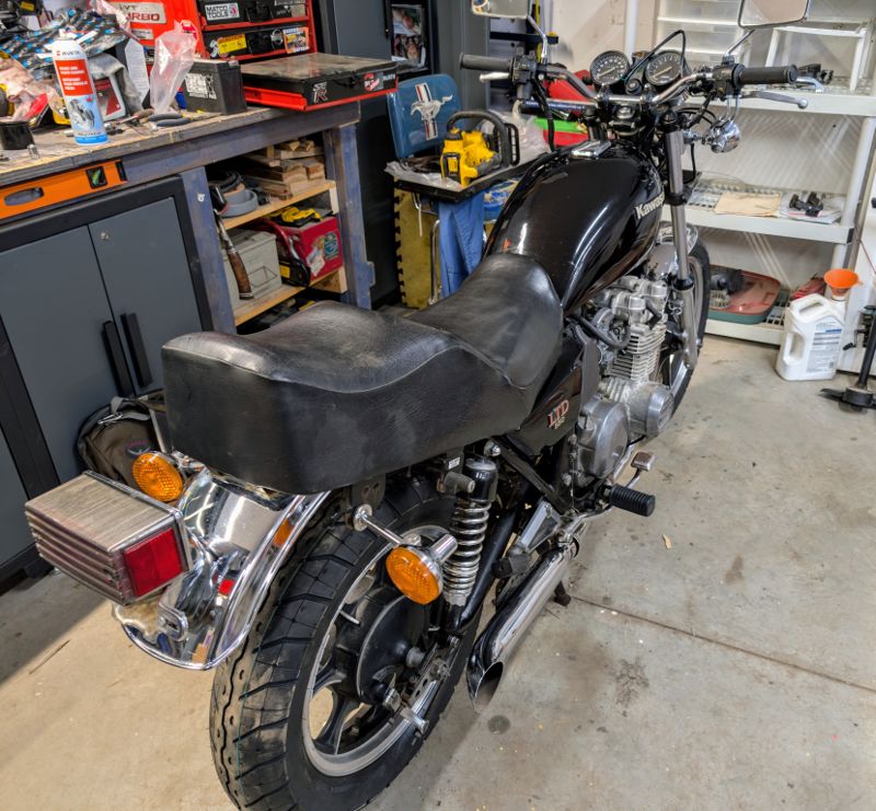

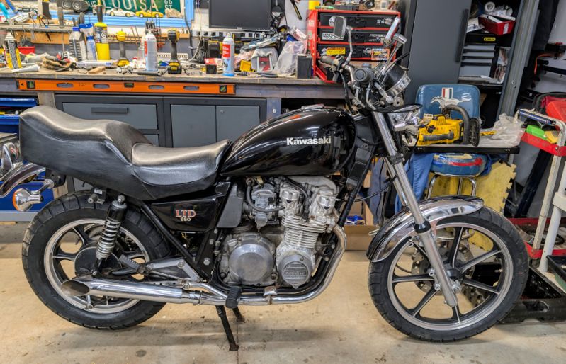

Re: 1982 KZ550 LTD
05 Apr 2025 12:18
Getting there!
As it sits now....not done by any stretch.
But....lots has been done.
Ran it enough to make old seals leak oil. Replaced those seals, including the valve cover gasket. Adjusted valve clearances while in there.
Removed the fork and tore it down, cleaned and re assembled with a bunch of new things.
New tires, new wheel bearings, new chain, new sprockets. New brake shoes. Wanted a new cush but they don't seem to exist except as used items, so I shimmed mine up.
Exhaust required attention...the mufflers slide over top of baffle tubes....the tubes that normally go into the exit of the mufflers...they have been modified to go over the exhaust pipe, and the muffler over that. However they weren't very secure...I hummed and hawed and spent too much time making them work. What would make the most sense would be replacing them, but for nostalgia I decided to spend way too long on it. So it is now super secure, and other than myself, no one will ever.
Ended up replacing the kawi brake master....I just couldn't bring myself to trust the old thrashed seals, and couldn't find a rebuild kit....
New ignition wires have been out on. I've gone through a fair amount of the harness to correct loose connectors. New bars and grips have been installed. Throttle and clutch cables are run. Adjusted the clutch. With the lever pulled, it is the trans is still engaged to the engine. Pulled the oil fill cap, the plates I can see are moving so I suspect one or a few of the most outside plates are stuck.
Pulled the headlight apart....I was planning on not doing that, but it was rusting inside the bucket (behind the reflector), so figured id take care of that before it becomes an issue.
Last night I decided to clean and wax the tank and side covers, because I just wanted a quick and mindless task...
And during all of this, there's been an awful lot of cleaning going on.
At this point, the front lighting needs to be finished. The front brake system still isn't done (the new master is on, I have some ss braided line and new caliper seals, I've just been meaning to paint the caliper). A whole bunch of little things to deal with. Then I guess that's it. Fire it up, maiden voyage it and see if that clutch can get unstuck.
