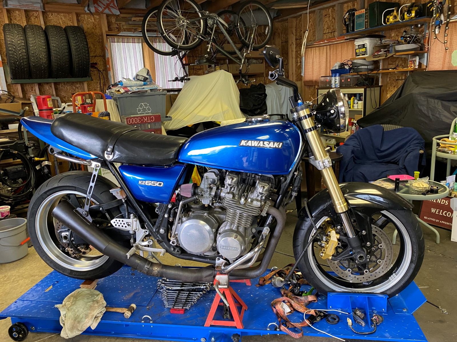

I'm putting a Moto gadget M unit blue in as well and will be building the wiring harness from scratch. Do you have a picture/drawing of how you did yours? I also used the Cognito Moto stem on my build as I'm putting the suspension from a 2005 GSXR 750 on my 77KZ 650. Nice build!!
