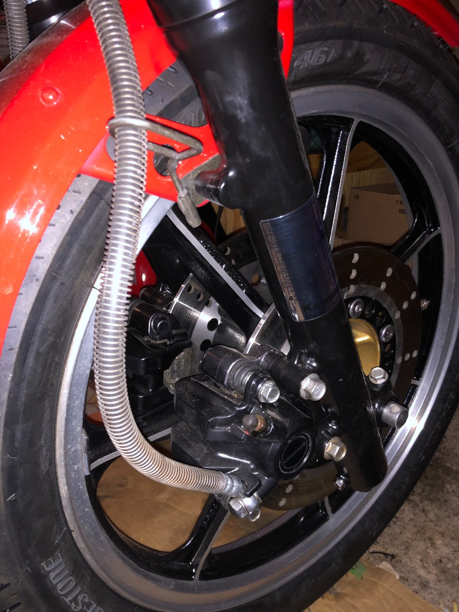

Ebay for replica seat cover, carb boots, air-box boots, clutch plates, clutch cable, speedo cable, brake pads, fork seals
and tapered steering-head bearings.
New o-ring chain and sprockets.
Zinc plated most of the nuts and bolts.
New battery, LED turn signal bulbs with an LED flasher unit.

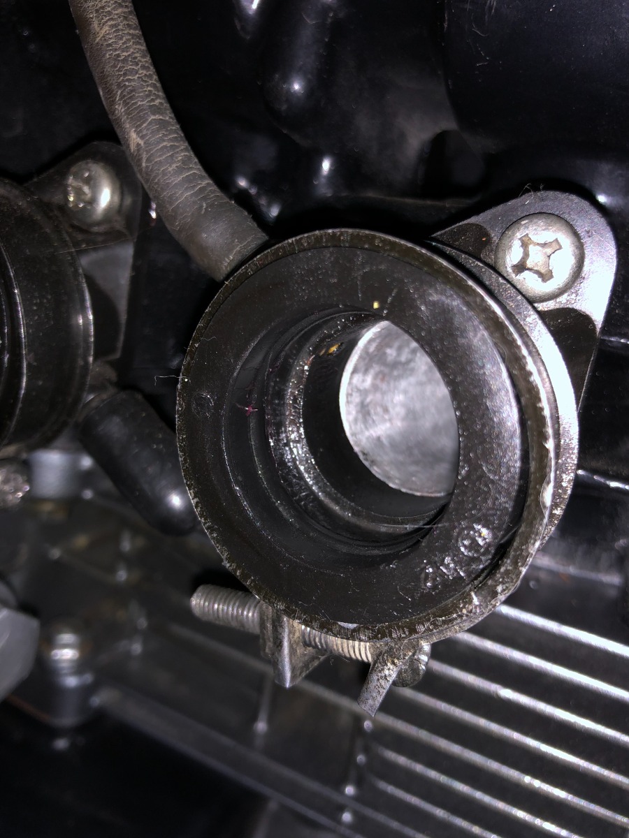

I've done a cylinder-head re-fresh: lapped the vales and installed new stem-seals.
I live up at 5500ft, so I had to spend some time re-jetting for the 4 into 1 Kerker.
Settled on 104 main jets, stock pilots.

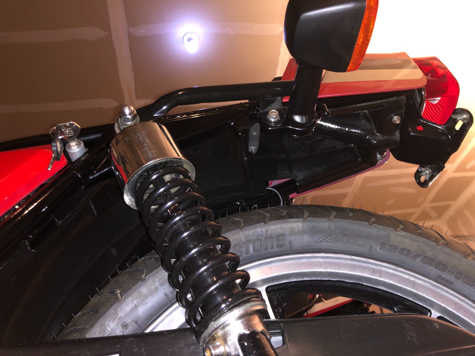

Recently, I found a set of Ohlins rear shocks that I had professionally re-built.
These made a huge a difference to the handling, compared to the 40 yer-old original units!
