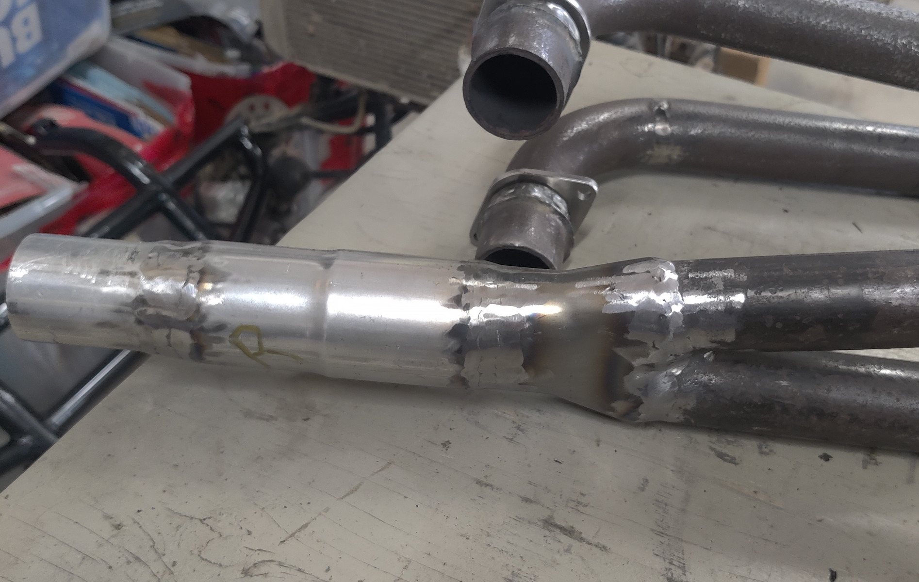

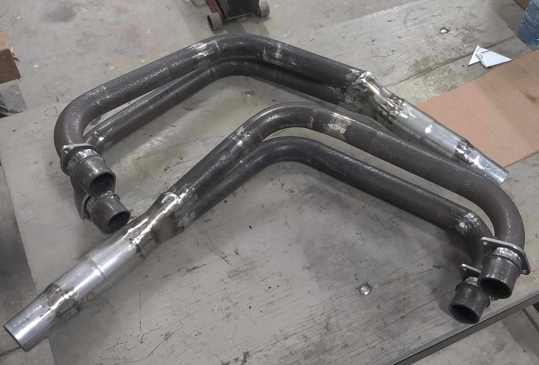

I got the exhaust fitted and final tack welded last night, left it with my friend to complete the welds and smooth them out.
When he gets it done I will need to blast and paint the headers. I will also need to make some new muffler bracket spacers to set them at the same height and angle as they are slightly off. Luckily there is a bit of wiggle room into those muffler slip joints.
The pipes are set higher than a stock 650 system because there is no room to put a cross over pipe. What I did discover is that just like the MAC 4 into 2 system the left bank and right bank are set slightly different mostly to get under the kick stand attachment.

Got the head pipes welded, he only has MIG so not as nice looking as some others can achieve. Should be OK once bead blasted then painted high heat silver.
At some point I may opt to have them copied in stainless, but I am dollar challenged at the moment so it was never going to happen. The plan is to work with this for start up to get me on the road this coming April. I have always been more about the go than the show

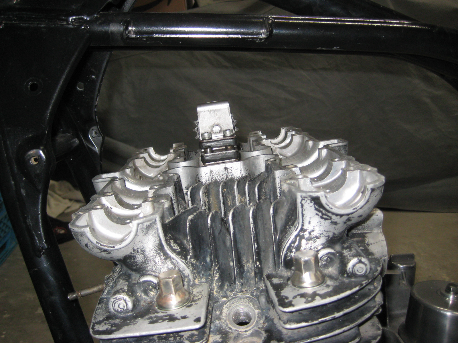

At the exhaust welding session I had the chance to check the valve cover clearance to the frame.
It seems to be enough to remove it without having to unbolt anything other than the coils (which is normal)
It may require removing the center idler, I just did not have enough time to fully investigate that evening. The cam sprockets sit lower than the center idler so that is the main obstacle.
Once I go to build the engine and install the carbs I will see what I need to do to remove it. Worse case is the carbs will need to be removed because I know it can slide off to the rear.
I had always heard horror stories about this type of engine swap of the engine having to be dropped off the mounts to check the valve lash - Myth Busted!
