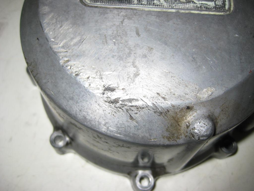

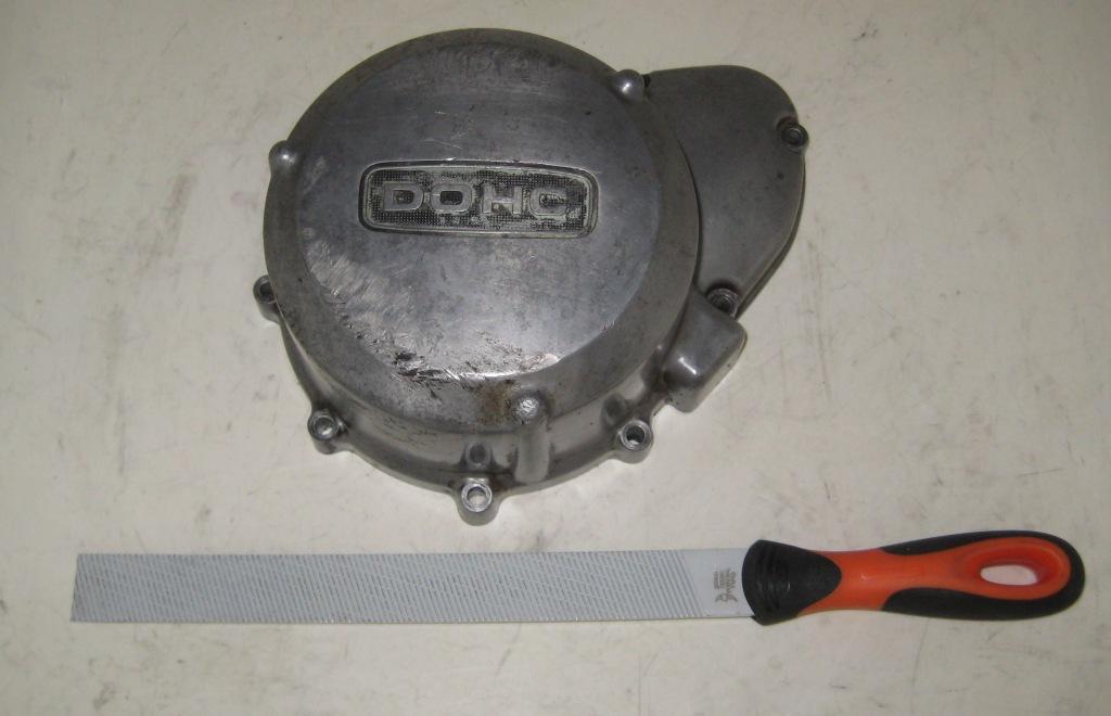

Generator cover is a little chewed up so going to give the deeper gouges a once over with a aluminum file.
This would take forever starting off with paper.
Not sure when I will get to working on it but will eventually post some result pics.

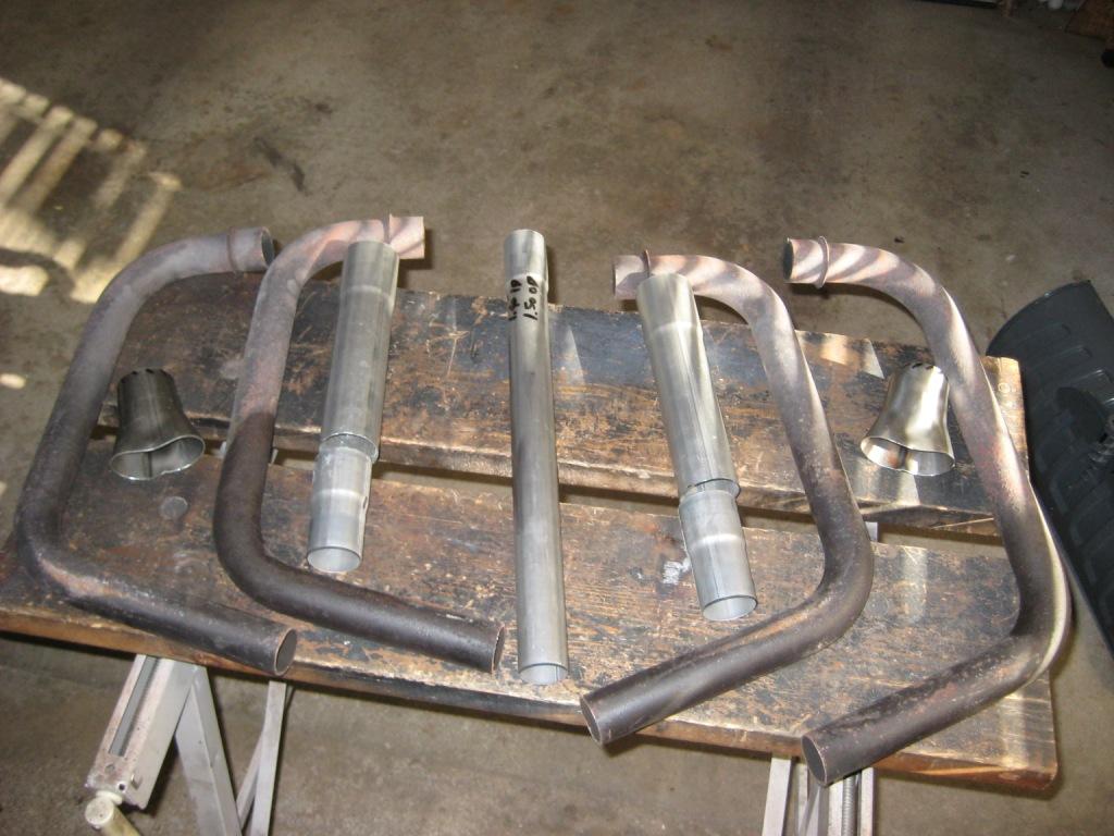

I pulled out my exhaust parts that will make up the system to the mufflers. I need to smooth the outside of the down pipes before using them to mock up. This is a 4 into 2 system with mufflers that look like the original 650 units.
The middle pipe is my crossover tube, just hope there is room for it but won't know till I mock up with the wheels on it.

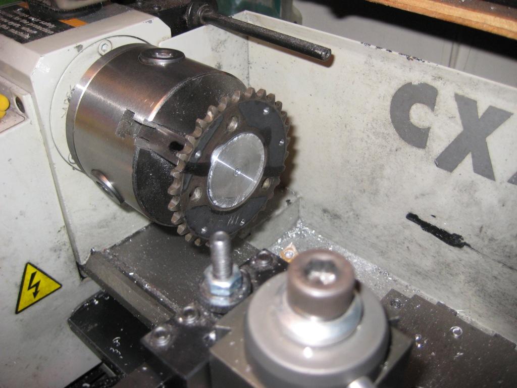

Was able to get out to the garage today and work on this fixture finally getting it finished.
My parting tool would not reach the middle so I cut the last 1/2" by hand with a hack saw, then I faced the end, but the saw marked up outer face which was already to size.
This is the top with the centering pin.
This is the bottom with the pin pressed in.

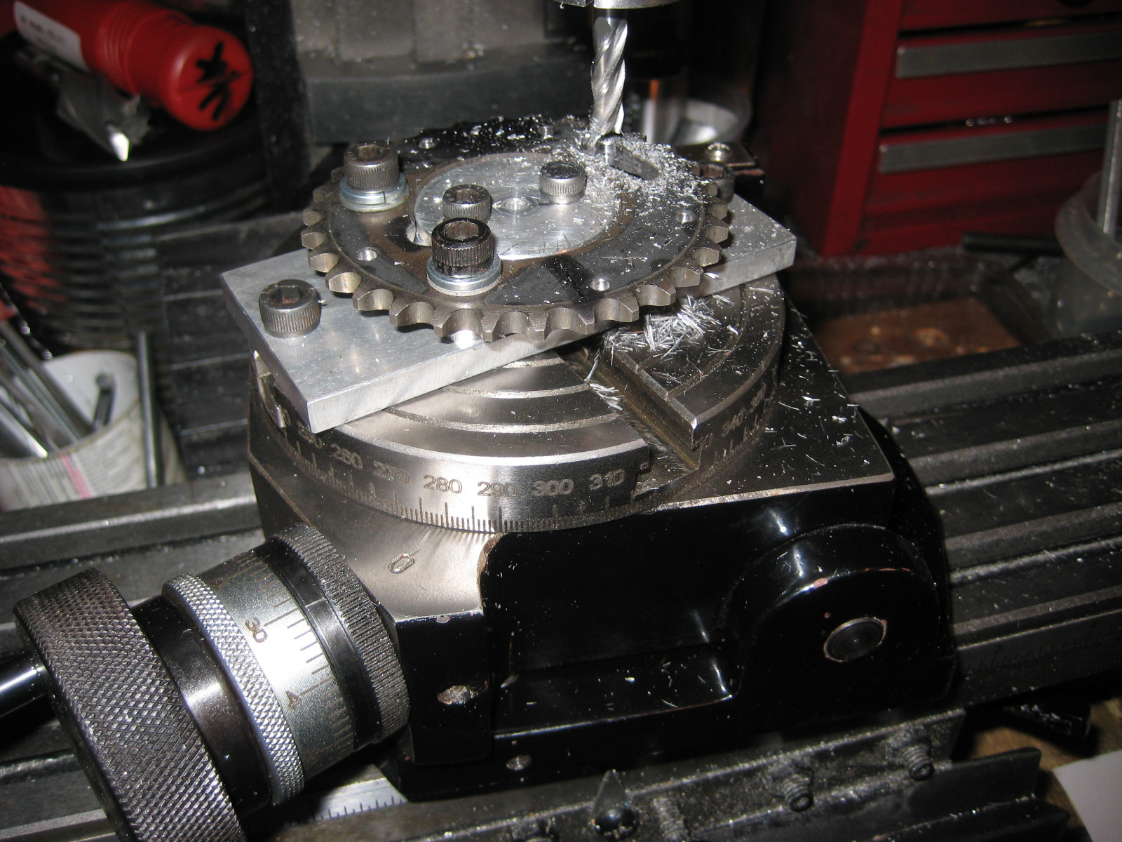

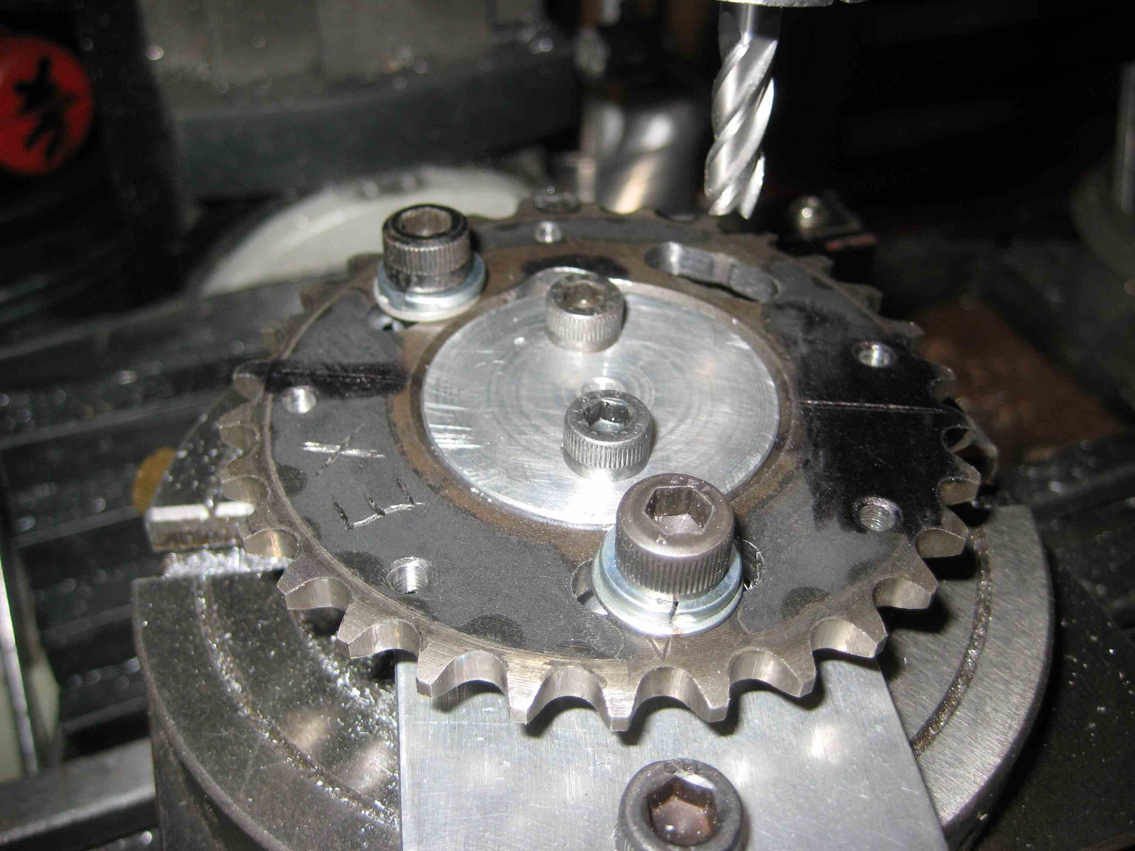

Fixture mounted on the rotary table, with two M5 bolts holding the plug to the base plate. The small centering pin is nested into the rotary table center.
M6 bolts to mount the sprocket, cut the slot then move the bolt to that slot, then slot a different hole - pretty simple process.
You can also see where I ground a relief so the .425" cam lobe could pass thru. Did that by hand with a Dremel tool.
I need to pull out a 650 cam sprocket and see what I need to do to bolt it onto this fixture. I know there are only two mount bolts but not sure on spacing or the center hole. Anticipating making another mount plug!
I will leave the slotting to another day, it should only take about 10 minutes per hole once I get it mounted to the mill.

Only got one slot cut after having to figure out the bolt hole separation!
Had to lay it out on a piece of paper using a circle template and a protractor
My CAD is down right now as I just swapped to a new PC tower with better software so the CAD needs to be reinstalled. I jotted down where the end mill slipped in then found out from the layout I needed to go 12 degrees per side from the start hole. It only took about 5 minutes to cut that first slot.

Got home early so finished slotting those cam sprockets.
Had a 650 cam sprocket on the shelf so compared it to the 900 sprockets. The center hole and bolt spacing is different.
The material I used to make the 900 fixture mount plug will just work for the 650 sprockets. Will make a 650 plug for the fixture at a later date.
