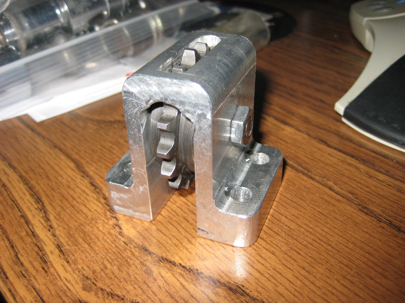

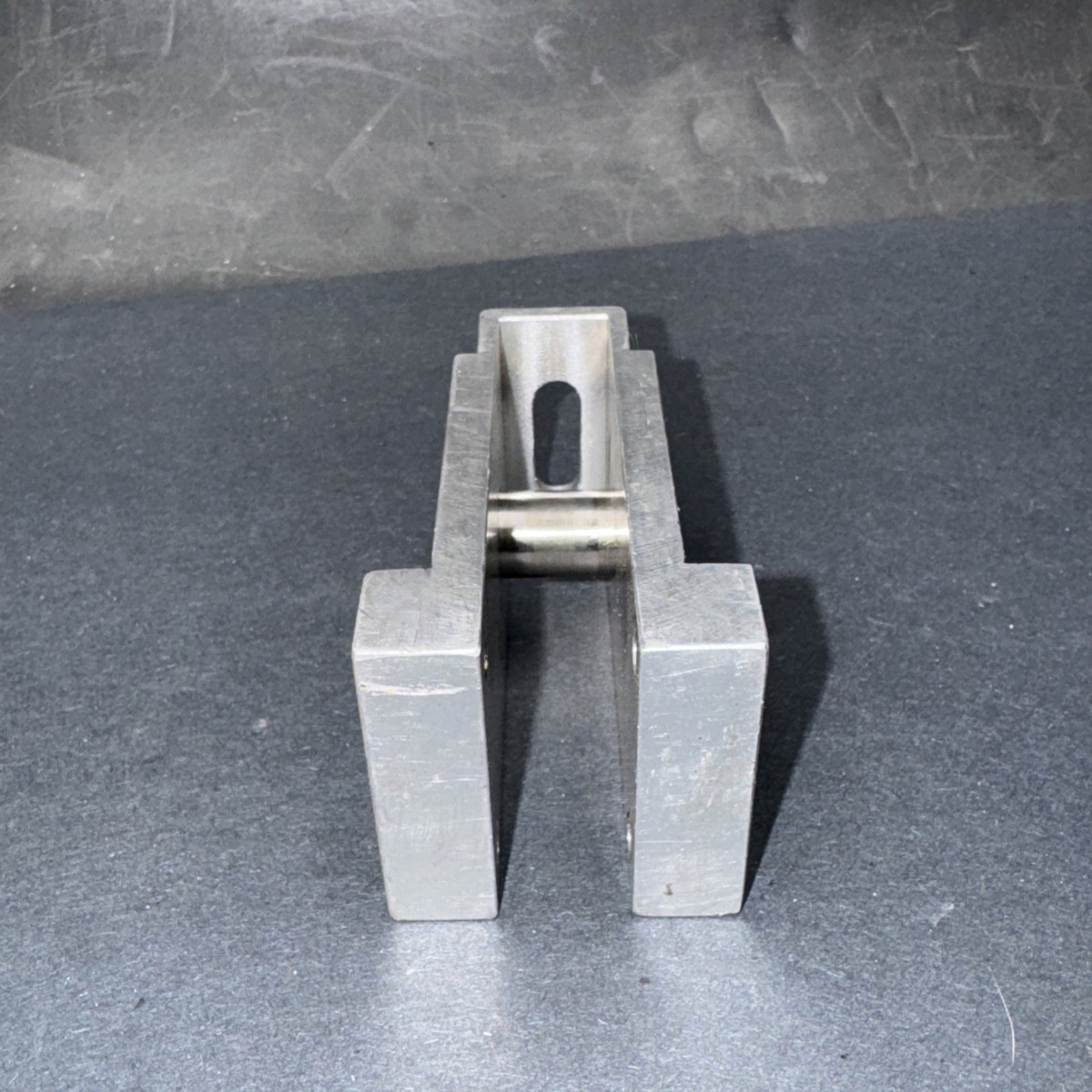

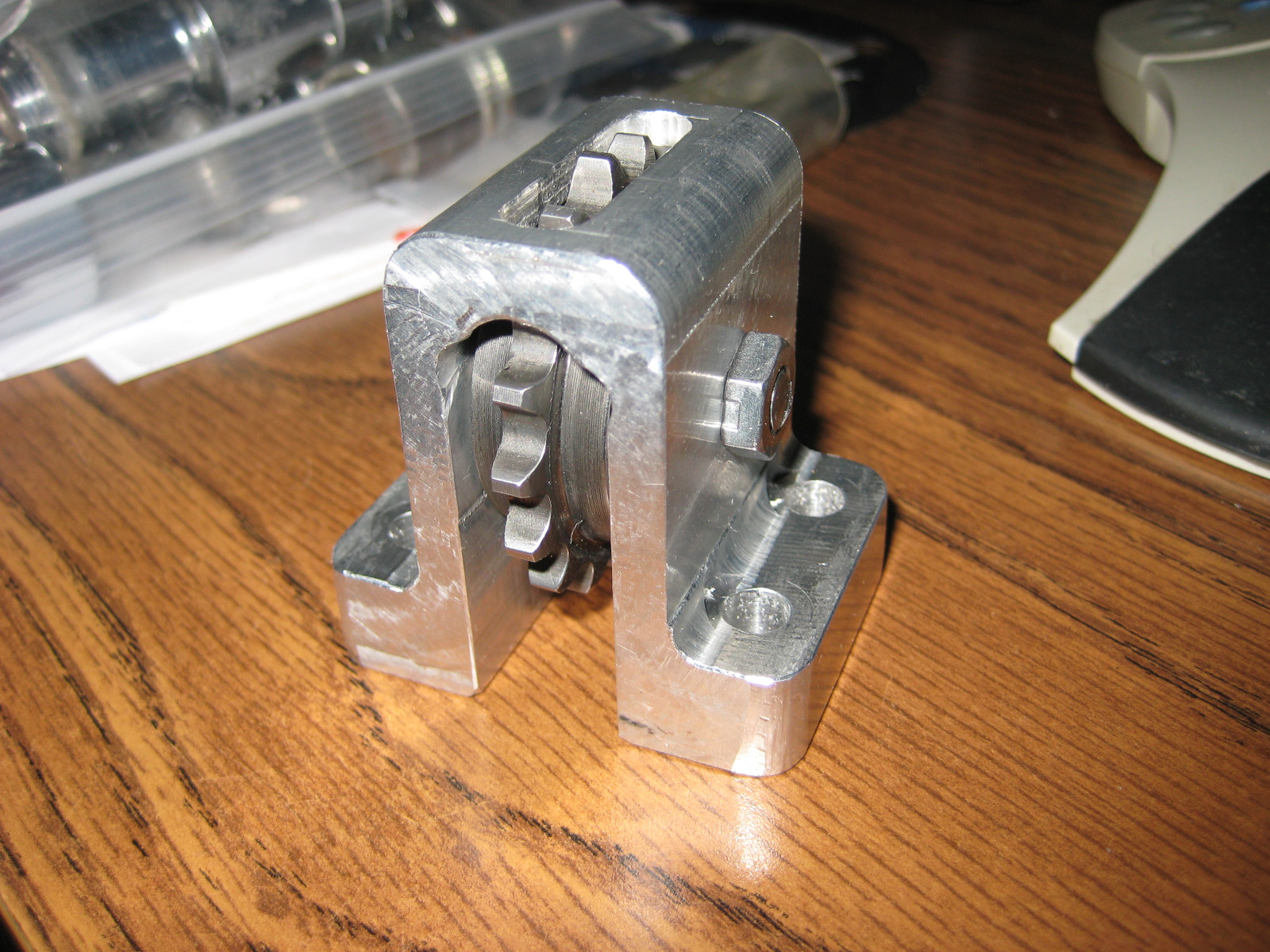

Finally finished up this billet bracket today.
Cut the top radii with a 1/4" radius cutter, but to save some time just used a hand file on the mount flange radii.

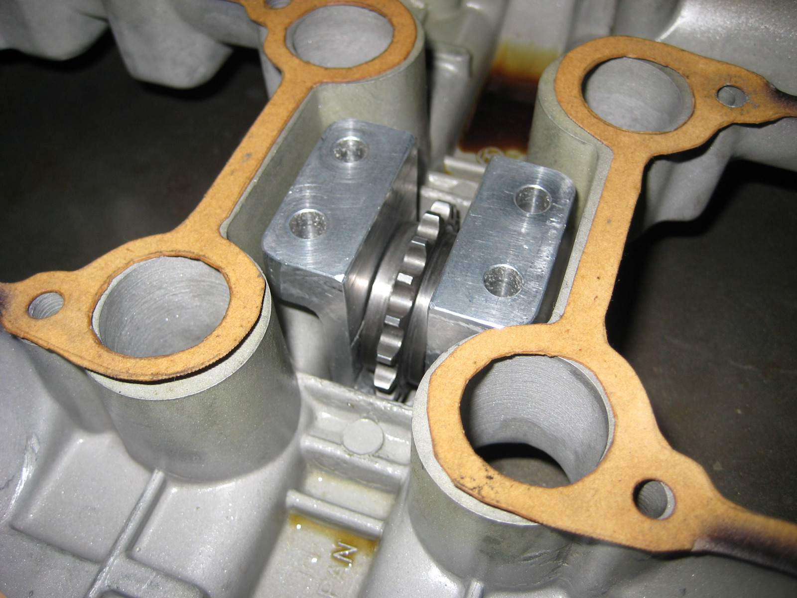

Checked the fit into the top inside of the cam cover and there is lots of clearance, room to "wiggle" it, and about 3/16" to the gasket surface.
This should fix my issue with removing the cam cover off to the side without it catching. Won't really know till I dive into it in the Spring.

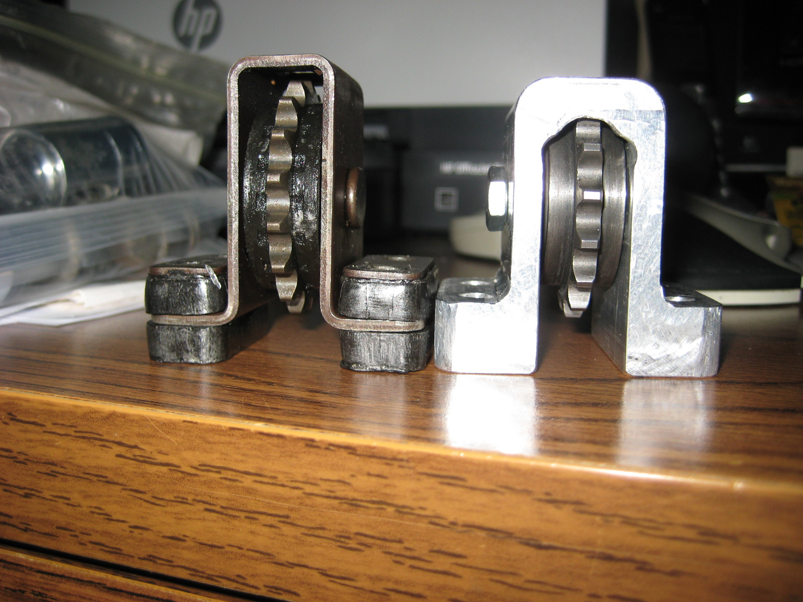

The height difference between the stock and billet brackets with the same sprocket center line.
A lot of work for a small difference.

Is there enough "flat" around the bolt holes for the mounting bolts to sit down flat ?

12 Dec 2025 12:53Its hard to make out but I spot faced those mount holes with a 13/32" (.406") end mill, M6 SHCS head is about .388" so should be OK.Is there enough "flat" around the bolt holes for the mounting bolts to sit down flat ?

Top job, I didn't think you would have overlooked it (even with cold feet -Lol)

I believe the design I came up with will do the same job as the steel bracket. I made all the wall thicknesses as big as I could, the general run of thumb is over double of what the steel thickness is. The way I carved out the insides created some gussets to make it as strong as possible.
I think I am done on this project for a while till it gets a bit warmer in the garage.

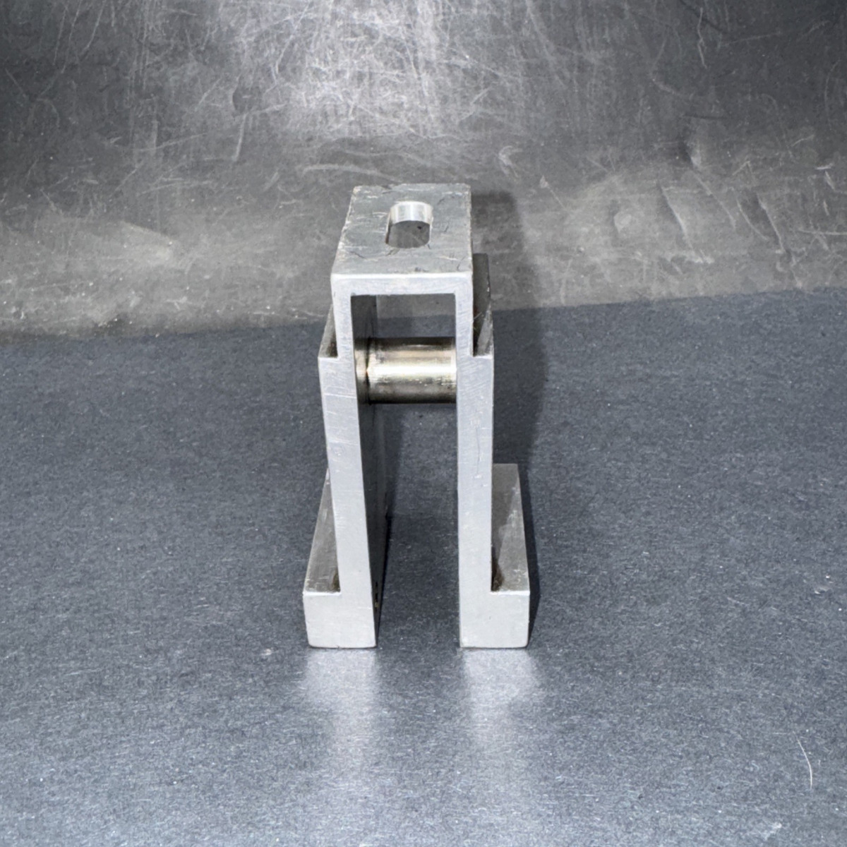

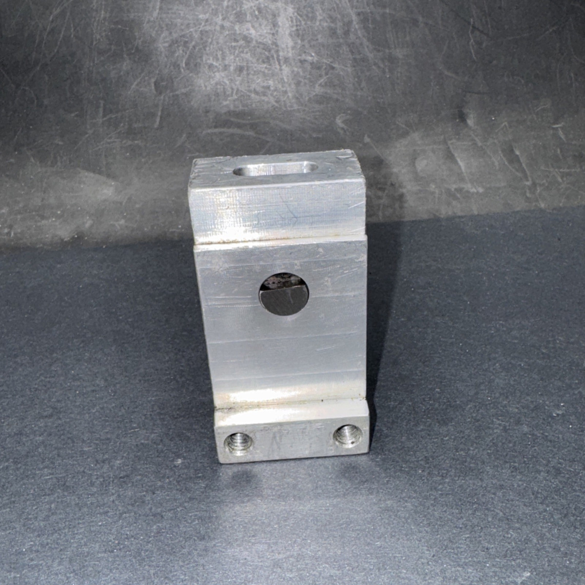

I was looking at some drag bike parts on Ebay last night and spotted this billet J conversion bracket for center idler.
Now I am thinking mine was "over engineered"

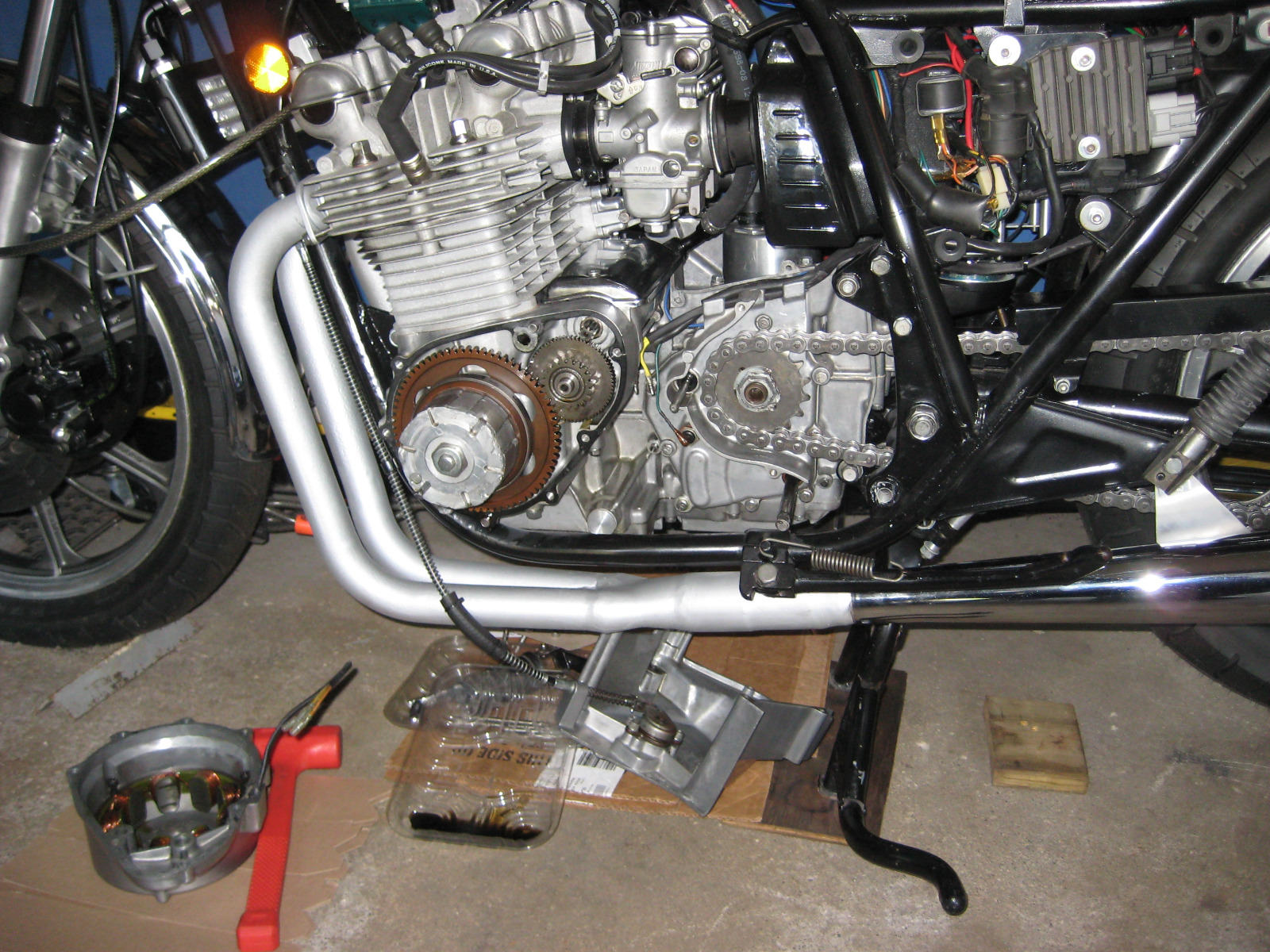

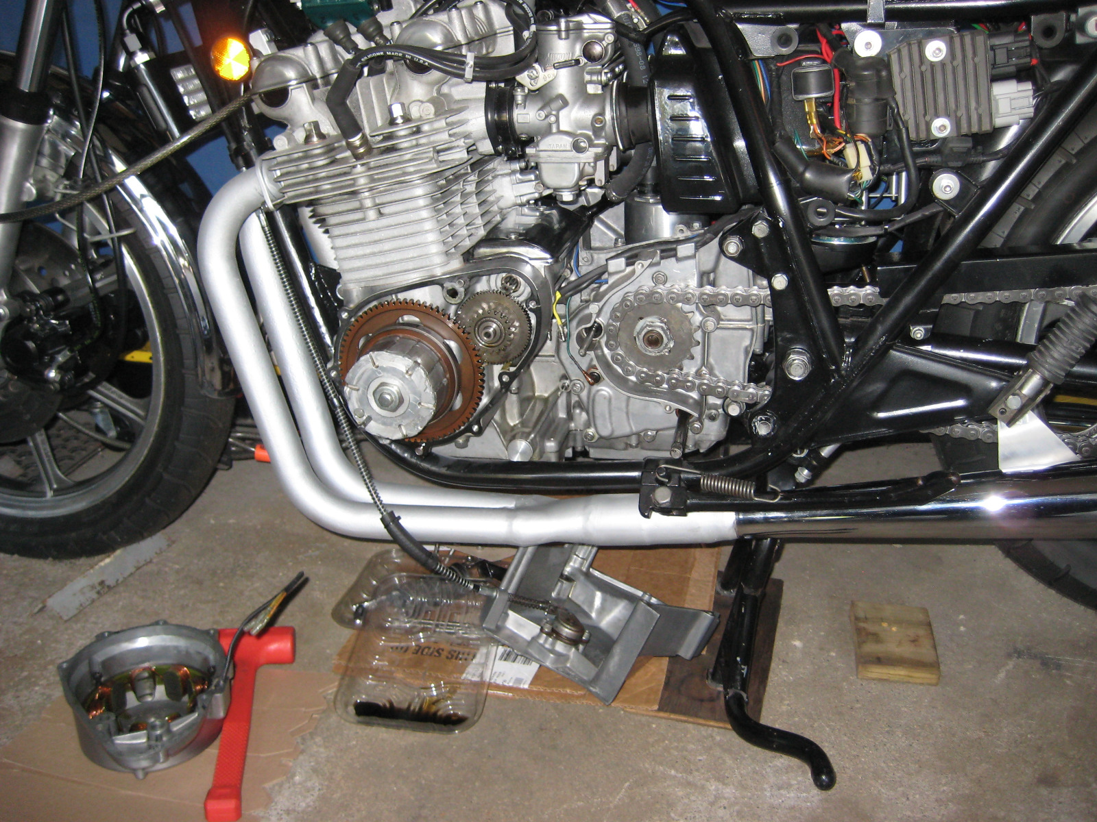

I have been holding off on working on this bike because about a month ago I discovered it was covered in grinding dust.
Looks like the dust got pushed up from the floor with some wind when I was working on my Son's car late last Fall. Normally dust will just collect on the top of the cover, but I had steel grinding dust up on my tail piece! It was all over the chrome bits as well, fenders, and the new mufflers. It had a bike cover on it plus a heavy duty drop cloth, but that did not seem to matter.
Today I finally had a day where I could blow off the dust and wipe the bike clean to start working on it. I blew it off real good and that seemed to help a lot. The grinding dust was not as bad as I initially thought so I just did my best to wipe it clean without moving it.
I took the weak stator off to swap it out with a new stronger unit. About a 1/8 liter of oil seeped out so not as much as I thought (on center stand)
I chopped the stock blue plug off for Z1/KZ1000 which has 3 power wires and a wire each for oil pressure and neutral light. I just needed 10" of wire for the 3 hot wires. The neutral and oil pressure wires I took off from the KZ650 wire harness so they are in a separate small harness which does not use the blue plug connection.
I took the weak stator out of the cover and now have to clean up all that black RTV before I can install the new unit. The gasket stayed in place so I should be able to reuse it (Cometic) as it did not get subjected to many heat cycles.

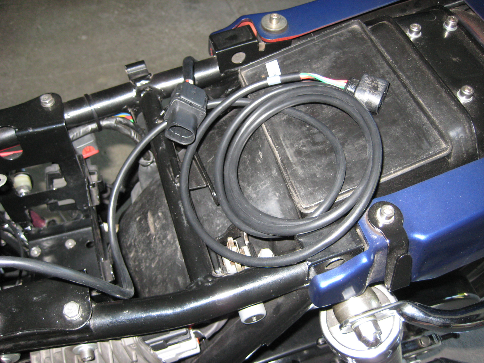

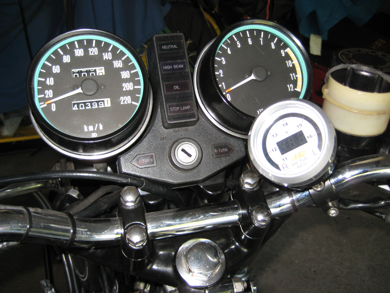

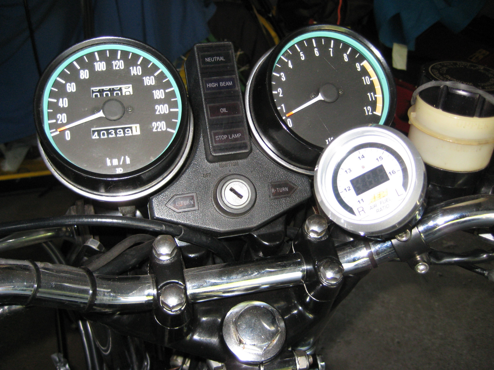

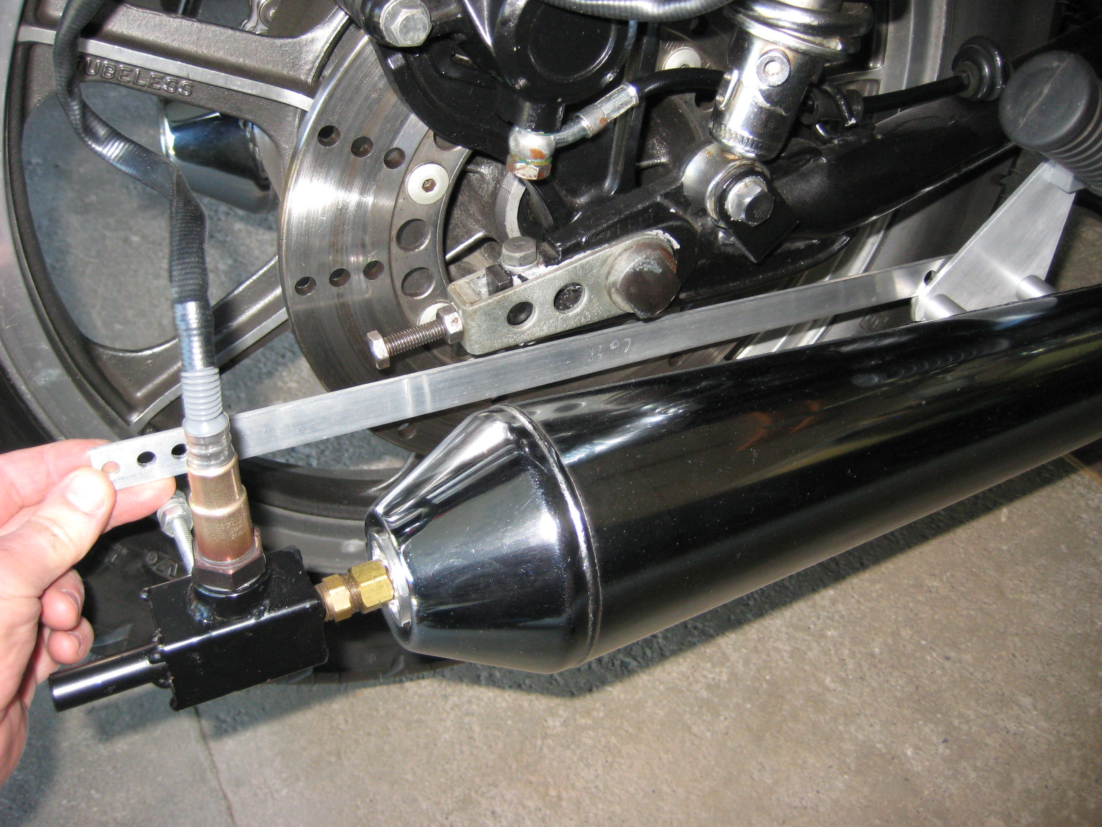

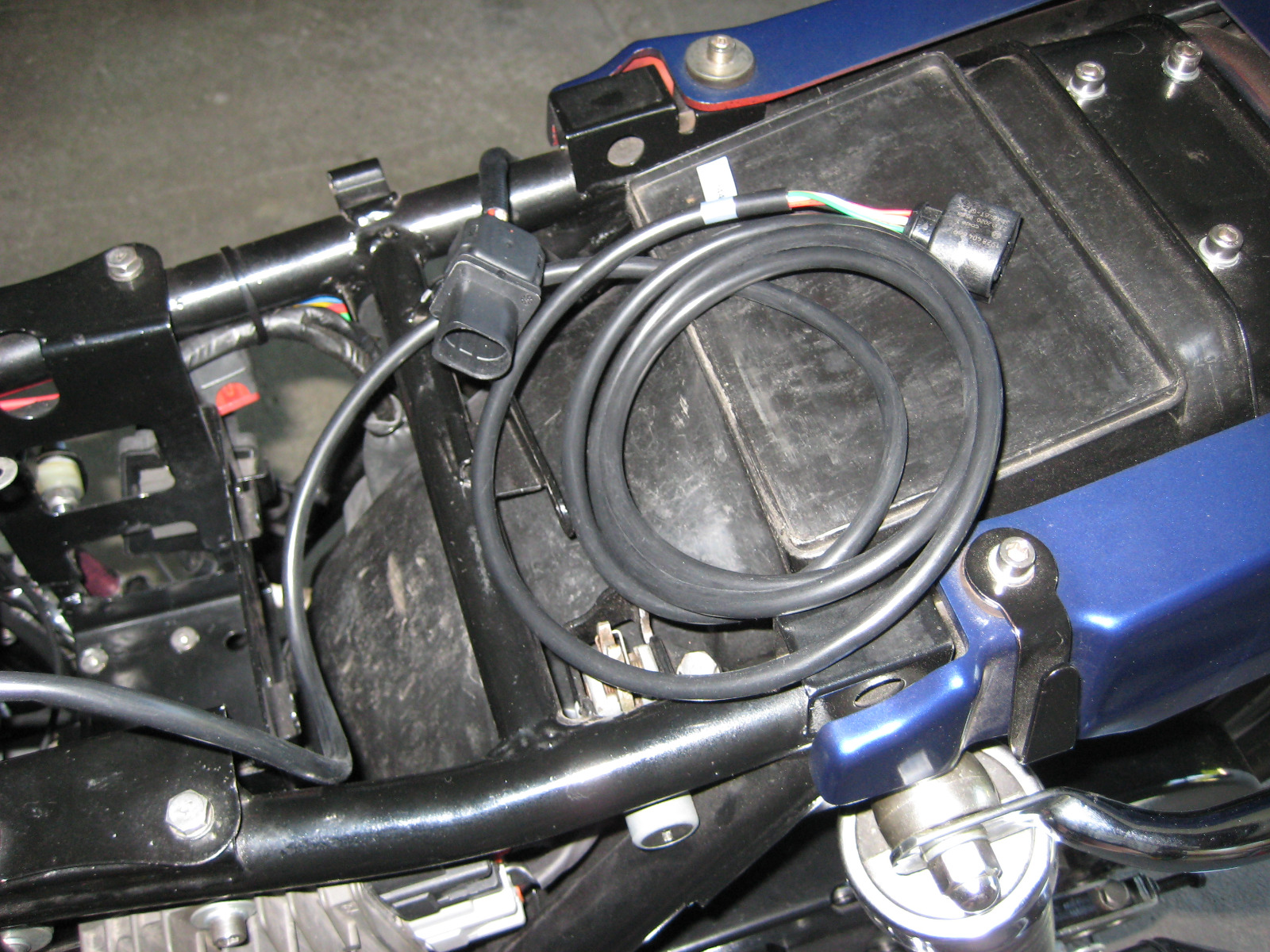

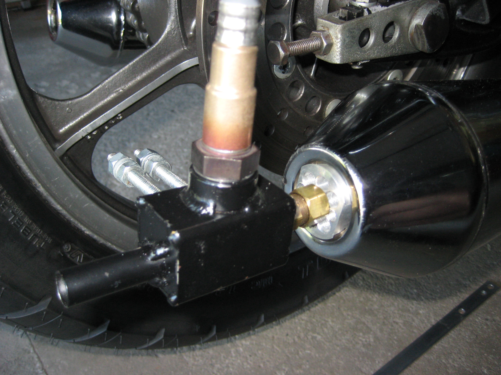

Its been one shitty thing after another around here but finally got back on this build today.
Pulled the bike out of its Winter parking spot then got to fitting the AFR gauge and O2 sensor to aid in tuning the carbs.

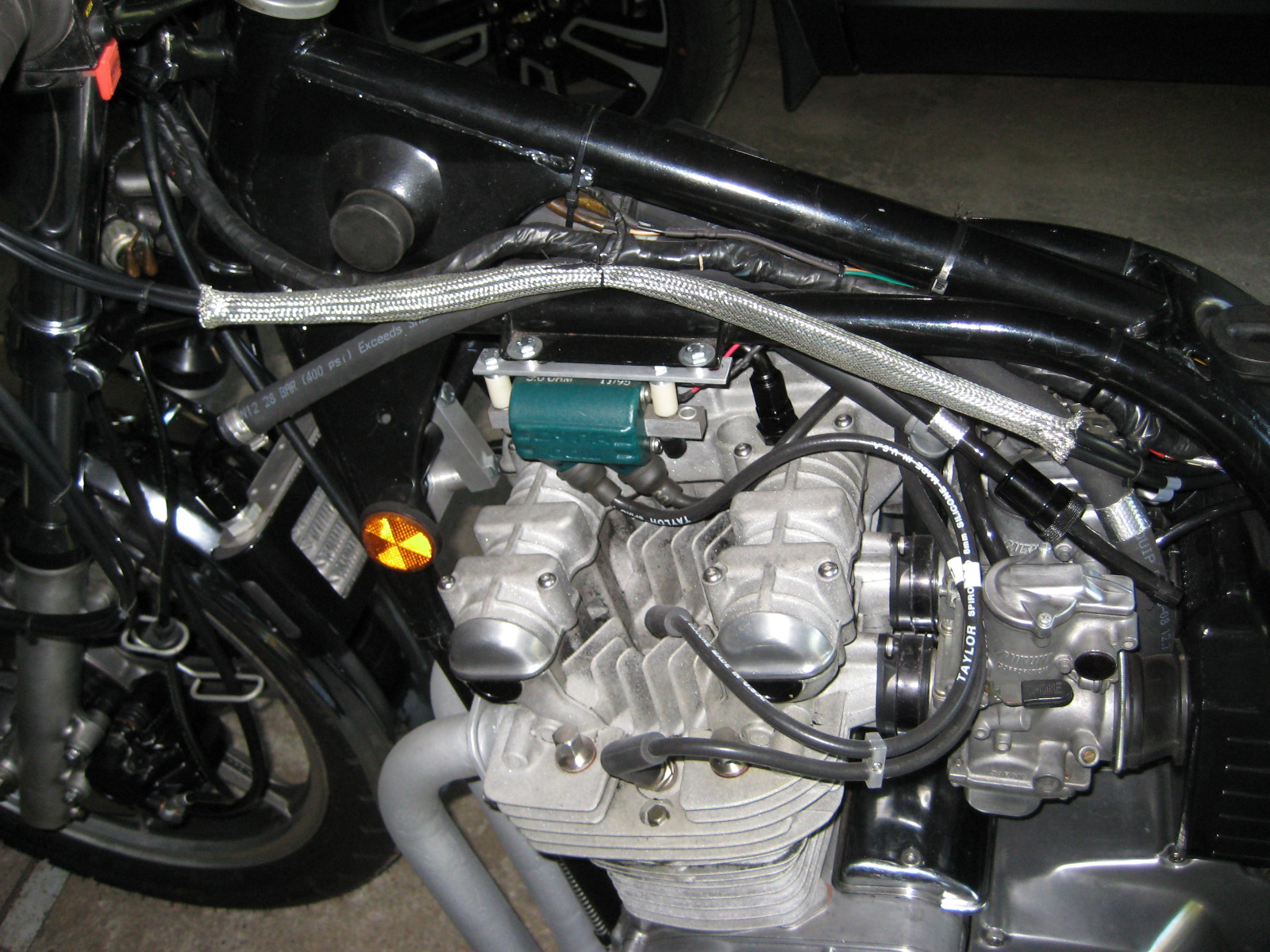

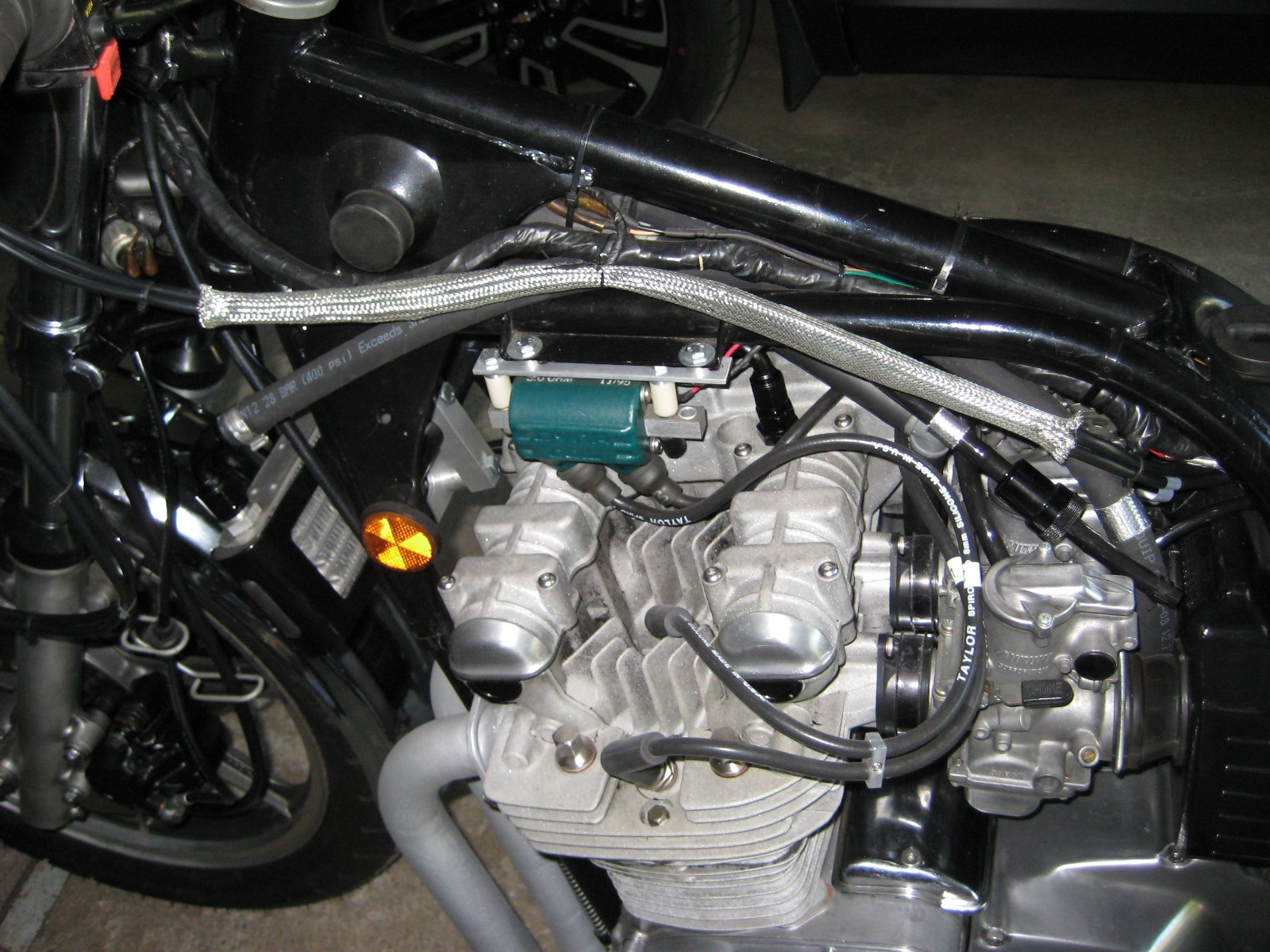

The wire harnesses are meant for a car so the extra length will be coiled up in front behind the headlamp bucket and at the rear under the plastic tail piece.
I used some RFI shielding sheath over the wires where it passes over the coils. I plan to run some black heat shrink over it, the picture is just a test fit.

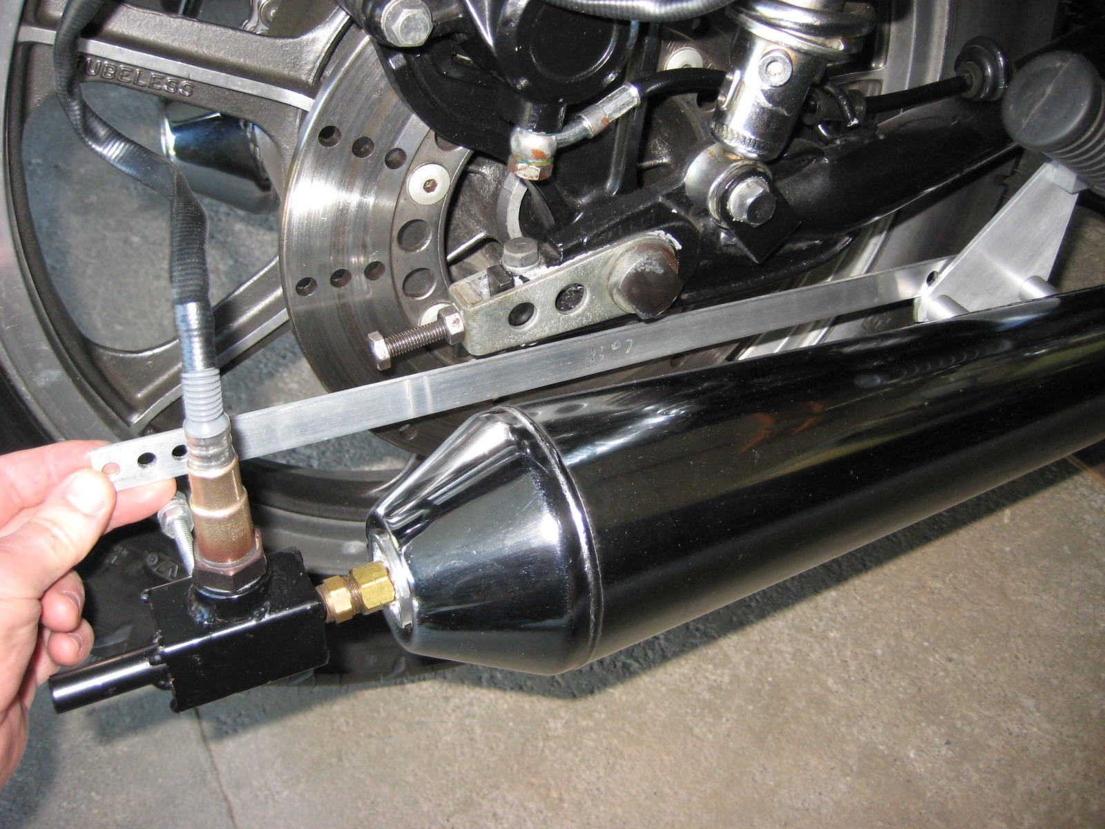

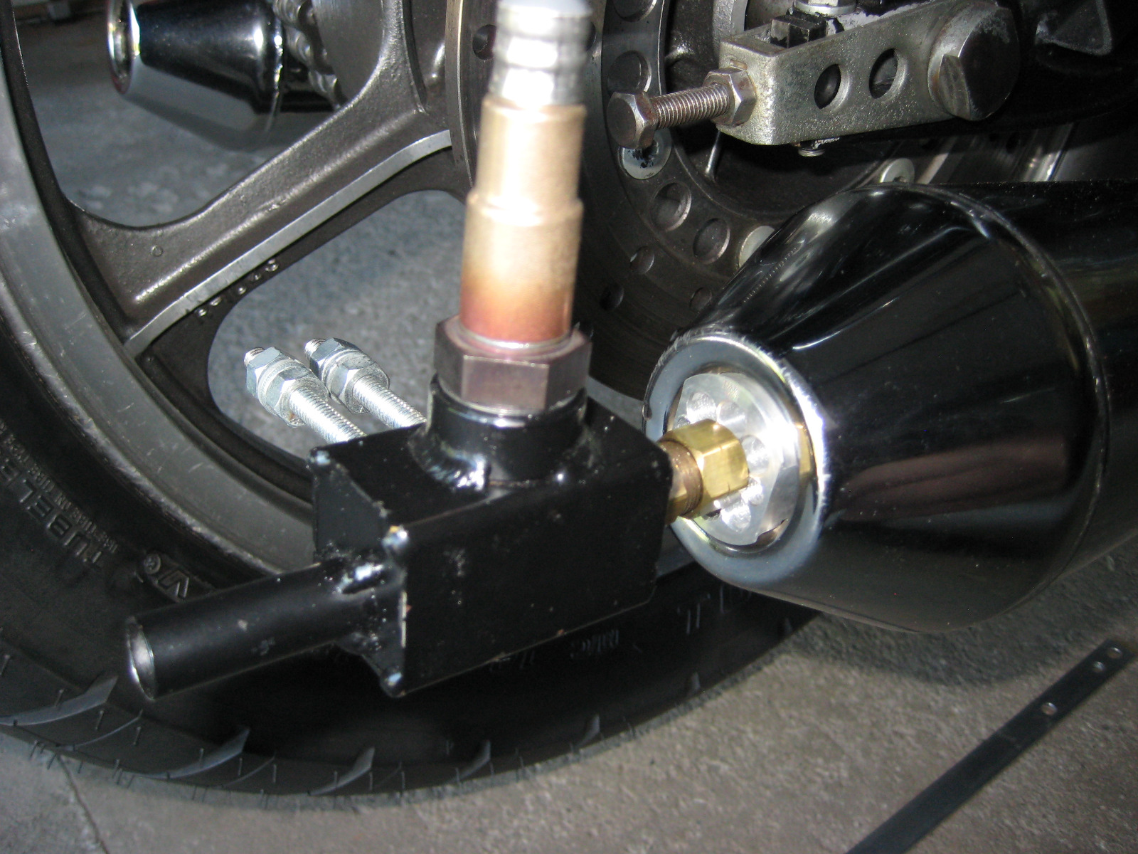

I installed the O2 sensor in the housing body and stuck the adapter plug into the muffler tip.
The mounting strap needs to be bolted onto the muffler mount plate then the housing body can be bolted to the end of that strap.
I still have some work to do before I can fire it up, hoping to do that one day this weekend.
