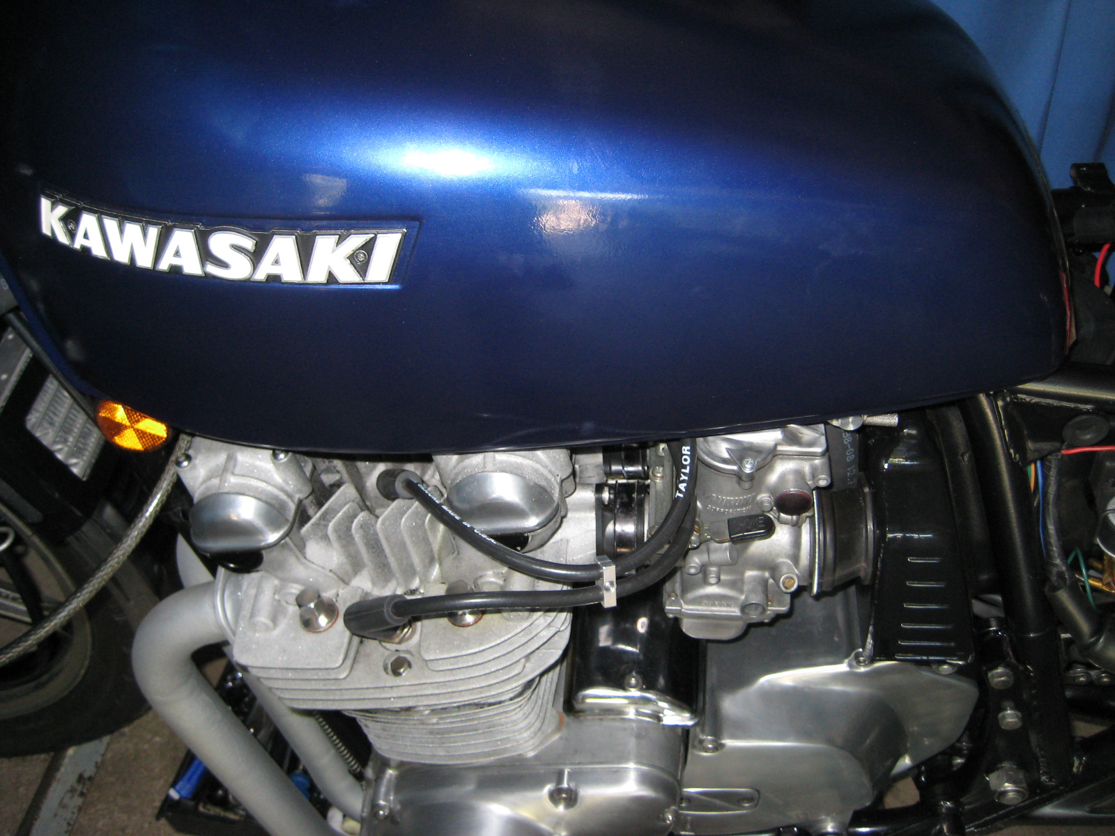

I continued on today with a few small "busy" jobs on this bike.
I removed some shims on my center stand limit bar because the stand was hitting the LH muffler. The shims were made on the lathe because plain washers were too wide to sit flat.
I also worked on getting the petcock fixed so the outlet lined up with the where the gas hose needed to be and the lever handle could fully swing around as it was hitting the air box initially.
This is after I turned the outlet a bit to get it closer to where it needed to be and I used a small hammer to punch the lever closer in on the body then cut the excess off the roll pin with a Dremel pink disc.
I then cut out some heat shield material to fit to the bottom of the tank to reflect heat away at the cam cover and a few spots at the front where the oil lines sit next to the tank.
Trial fit was OK but the outlet fouled slightly on the oil line so I turned the body more so it was more parallel to the bikes center line.
It looks OK from the top with the plug wires out to the side.
You can see how tight it is to the carb top but it clears OK, filter clears and gas line has a bend towards the center then back into a top 5/16" "Y" fitting at the carbs.
This is the lever fully opened.
This is the lever fully closed. I hammered in the lever more than 1/8" and shortened that roll pin.
This shows the routing of the plug wires to avoid the tank bottom on both sides.
Hopefully there won't be a issue with the heat wicking up from the engine, but better safe than sorry.
The gas cap lid vent hole has been previously enlarged to increase the amount it can vent out. In the past with my 831cc 650 engine I could hear it hissing when I would pull over and stop on a stupid hot day.
