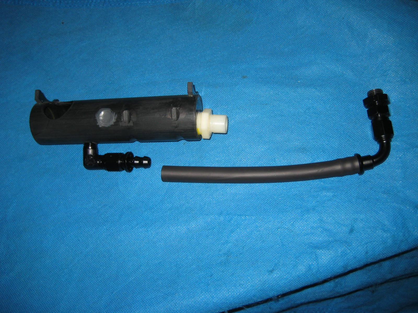

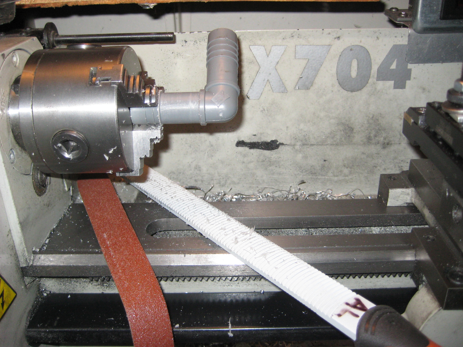

I started looking at the venting again since my 90 degree AN fitting arrived for the catch can.
I measured then carbs and found out the main vent tube out of the air box was not going to make it up and over the carb tops. The catch can is strapped to the frame back bone so a straight shot would be perfect but the only way to do that would be some custom 90 degree elbows at the air box end.
I looked around in my plumbing spares and found a plastic 90 degree AC drain fitting would work if cut down on the lathe. Only issue was the cutting tool could not get close enough so decided to cut it with a aluminum file and some 80 grit paper.
It cut pretty good by hand but you have to "sneak" up on the sizing of the OD.
Cut to length it works pretty good and will solve this small issue. I only had one elbow so I need to buy another but they are less than $2

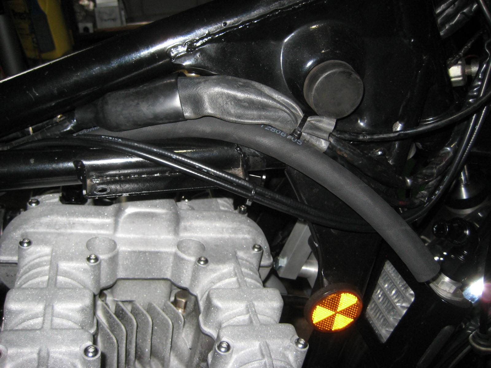

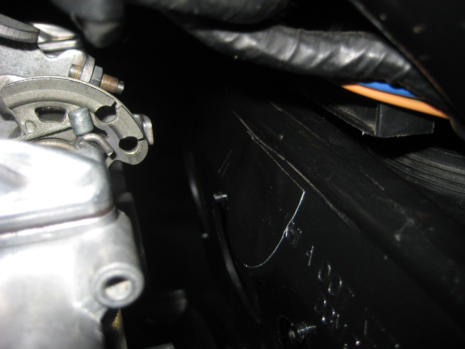

I was able to figure out a way to go from the breather cover to the catch can but I had to scrap the line running thru the air box.
This is how close the bell crank was to the air box fitting.
No way anything was going to come out of there straight or at a 90. I was able to cut the vent tube off at the cover then remove the cover from the shifter side, will reuse that bit of hose.
I removed the pollution fitting and sealed up the top and bottom holes on the air box with Gorilla tape on both sides.
Vent line from catch can drops down behind the block, does a 90 (need fitting) then drops down with a 90 at the cover. I will need to angle it a bit to drain back on that horizontal length.
Its kind of funky way to do it, but its all 5/8" ID so only restricted by the elbow bends similar to those stock elbows in the vent cover.
The air box in its final location with the CV rubbers installed.
Once I get the throttle cables hooked up and the vent tubing in place then I can start fitting the oil cooler lines.
I am hoping I can start it Thursday morning.
PS: I went back over my notes to make sure I Loctited the cam sprocket bolts (wrote that down) and discovered I got the cam timing backwards. I set the intake at 108LC and the exhaust at 110LC.

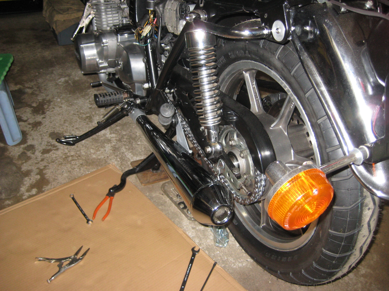

I started in today finishing off the carb install by wrestling with the throttle cables. The push cable was no issue but the pull cable gave me fits, I finally got it on and adjusted properly after much cursing! I installed the main gas line and the vent lines into the air box filter. I then made sure the ignition plate was statically timed before it got forgotten. I also installed a new longer O ring chain and the kick start lever.
I heated this plastic vent elbow to make it bend over 90 but it sprung back too much after cooling, could only get another 5 degrees out of it but that may be enough because I think there will be some give in the hose as well. Seemed to draw back 10 degrees on cooling even after clamping it.
That is about as far as I got on the fittings because I started in on fitting the mufflers.
I knew I needed to adjust the spacing, and it gave me a hard timing trying to get it lined up like I had it welded up!
So far I have it within 3/8" of each other on both sides, but depending on the rear brake lever touching the pipe it just may have to stay that way for now. Its close but not perfect, I have some washers I could try once I get the rear brake lever adjusted again.
Tomorrow I will finish the venting and get the oil cooler lines installed, then lastly the coils. I will probably start it later tomorrow or Friday morning depending on whats going on around here.
