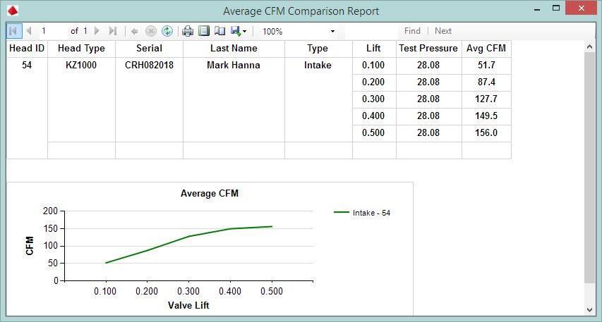

That chart works out to 89CFM @ 10" at .400" lift, so fairly typical for a high performance street engine. Stock GPZ1100 head comes in at 84CFM @. 500" lift.
My guy is a Canadian version of Larry C, and Larry asked about my guys work a few times when we emailed back and forth.
The KZ head on my 1327 drag engine is ported to 110CFM even though it the smaller 37/31 valves. Its still not opened up on the intake like some I have seen that use epoxy or end plates, it still has some meat to seal the rubbers
Here is the intake side before the rubbers got put on.
You don't really have to have GPZ head to make some decent flow numbers, but you do have to take pounds of aluminum out of a KZ head to get similar results.
