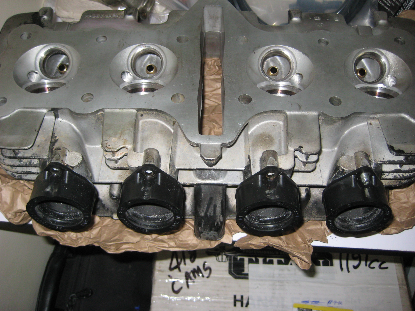

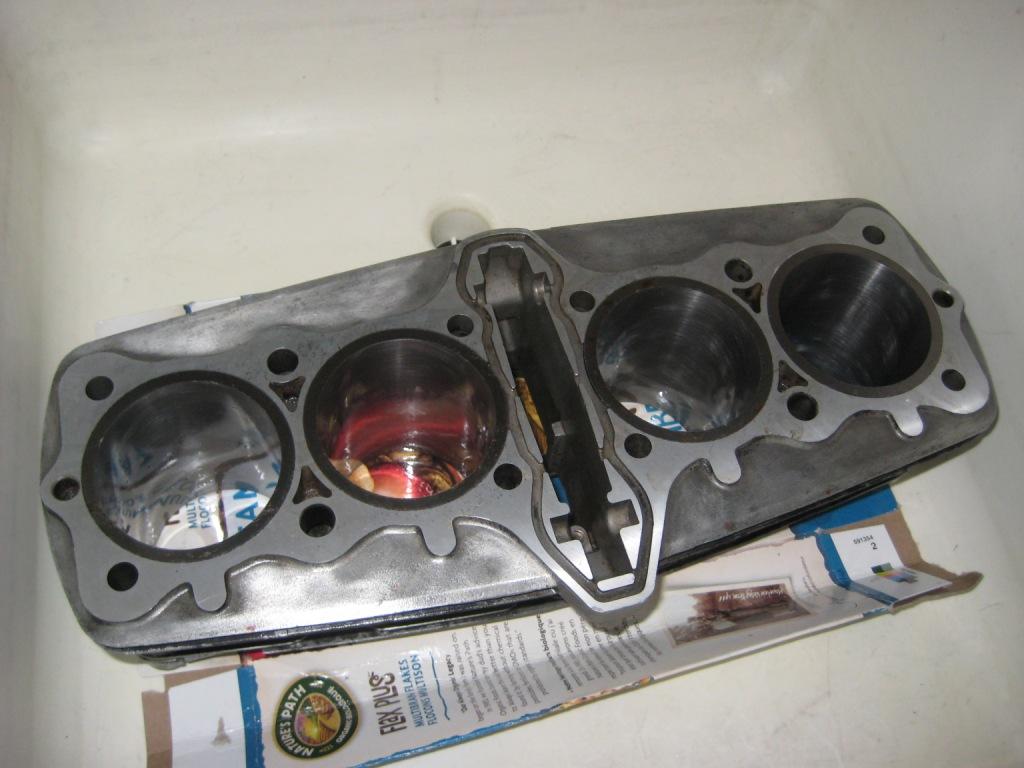

The frame has been painted and been hanging up since October of last year. It already had a tapered bearing headset installed.
The cylinder head is ready to go except the cam pathways need to be ground. Its has been decked slightly.
The 1015 barrel has been fitted with bigger liners which have been bored and honed to size. Its has been decked slightly.

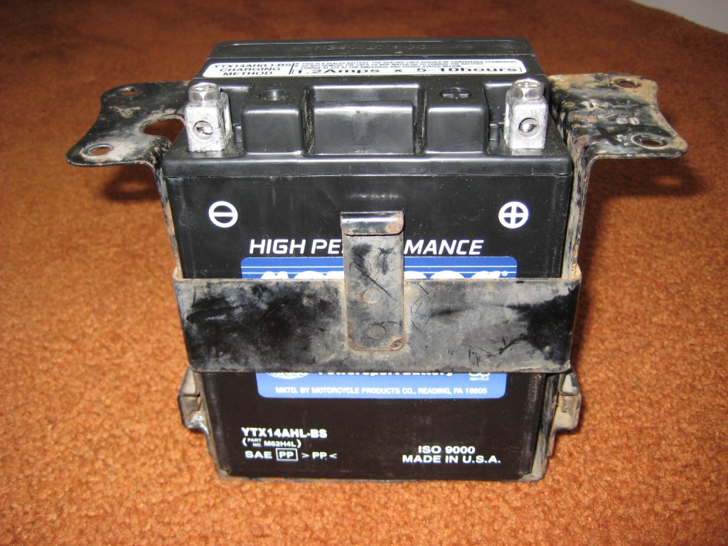

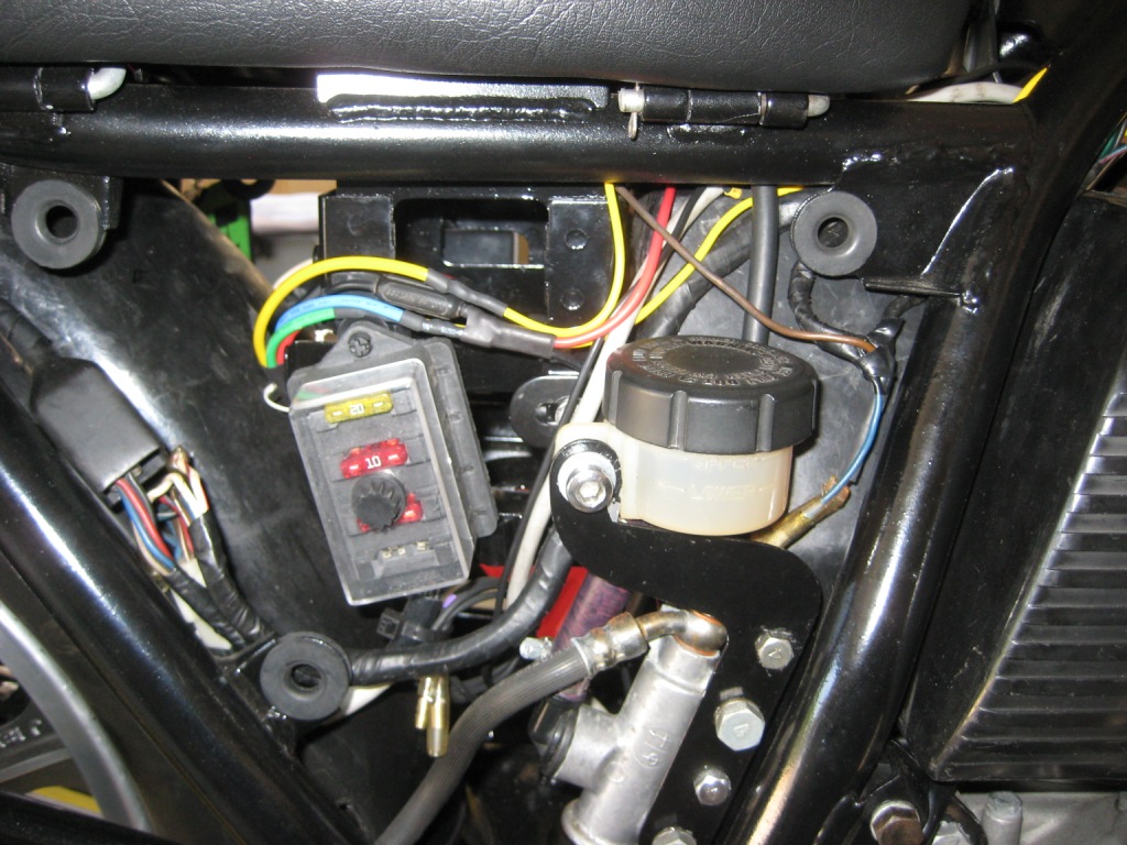

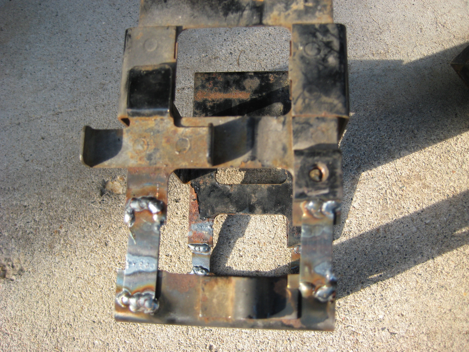

For the electrical system I deepened the stock battery box to be able to run a bigger battery (same size as a KZ1000)
I also installed a SH775 regulator from a 2013 Polaris RZR 800. It just barely fits under the side cover.
I also run a upgraded blade fuse box and oversize battery cables.
This build is not going to be very glamorous, its mostly DIY so spray bomb paint job (already done) and no pricey or slick parts.

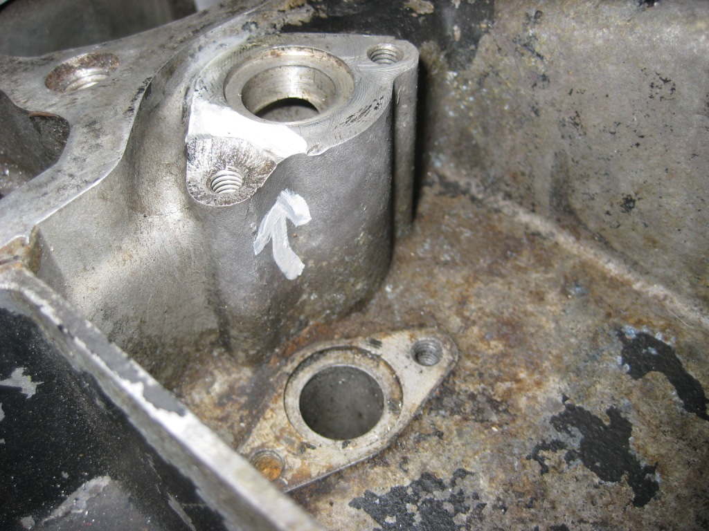

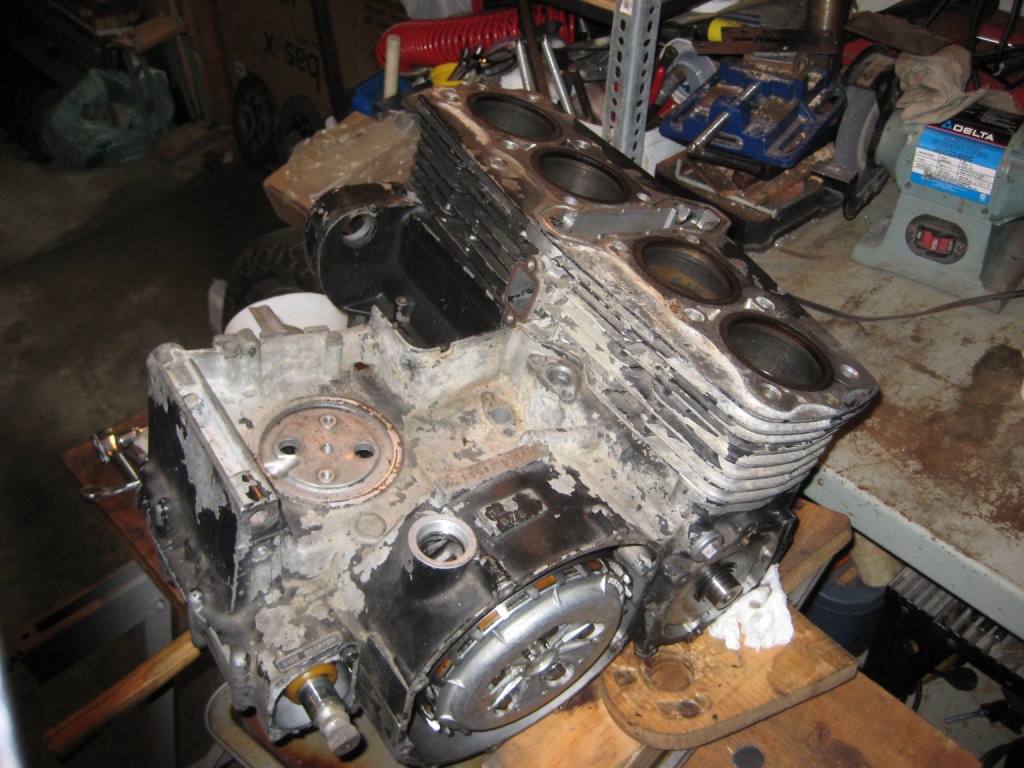

I have to start working on getting the cases cleaned up, black paint and corrosion removed. Once that is done then I can chase all the threaded holes.

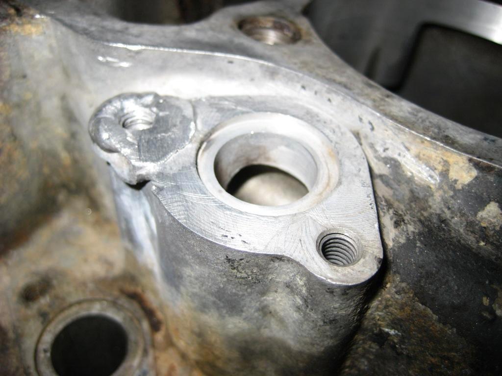

I have one weld repair to fix on the upper case. JB Weld was not going to cut it!
I need to spot face that surface and chase the thread. Get the shape back on the outside with a Dremel tool.
I think I will need to wash and scrape the dirt off before trying to remove the black paint.

Re: KZ650 Sleeper Build (KZ1000 engine transplant)
21 Apr 2023 15:07
How the hell can someone crack and break off the oil pressure switch port mount in this position with a sledge hammer and chisel?
- Injected
- Posts: 1778
- Thanks: 1248
21 Apr 2023 19:08 - 21 Apr 2023 19:19It was not anything like that, it was in one piece when I got it.How the hell can someone crack and break off the oil pressure switch port mount in this position with a sledge hammer and chisel?
Just a big crack migrating from the outside of the lug from up to the top and across the gasket surface.
I believe it was from corrosion and over tightening of the fastener. When I probed the crack it chipped off in one piece (very weak)
If you look closely at the picture you can see a tiny crack on the other side, not as big or worth repairing (just use the correct bolt torque!!)
Its hard to see in this picture, you can make out the line across the gasket surface.
You can see there is a lot of corrosion on the upper case where the engine/bike was stored out in the rain/snow.

The VM33 carbs are assembled and pre jetted for the engine combination.
The rubber ducts for the 750 CV air box fit the carb mouths just right.

Had some time today so I ground this weld flat.
It took a while but I got it pretty flat. Thread is now 100% good.
Might just slick the bottom of the fitting block with 3Bond or RTV plus the stock O ring just to make sure its leak proof.
