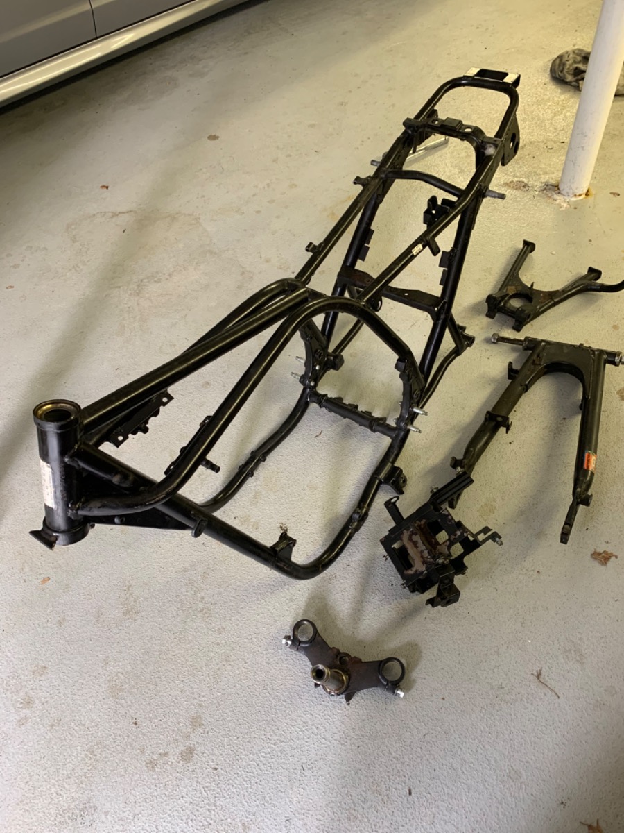

Powder coating done.

Looks good! Did you do it yourself?

No sent it to Quality Metal Refinishing in NJ $200 and returned in 10 days.

Nice. Did you do any prep work on them before shipping?
