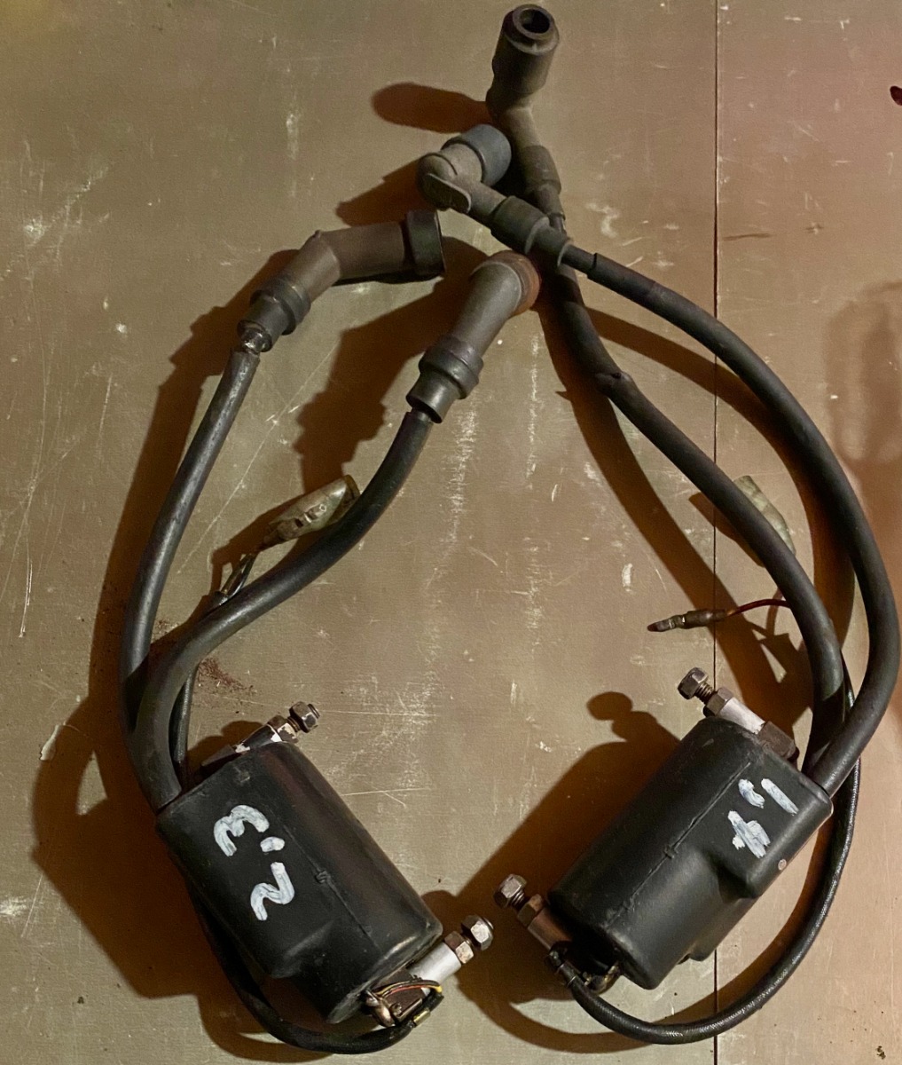

Back to some electrical work with the ignition coils, wires, and spark plug caps.
I think these are the original coils etc, so at 46 y old, they might be past their prime.
The white numbers on the coils were put there by me during disassembly.
Both coils reliably show a primary resistance of 4.3 ohms, which is nicely in the spec range of 3.2 - 4.8 ohms.
The secondary wiring has a spec of 10.4 to 15.6 kohms. My measurements of 24.6 and 25.0 kohms included the HT wires and the plug caps. I've read the plug caps are often about 5 kohms, which means I could subtract 5 kohms from 25 kohms to get about 20 kohms, which is still over the 15.6 kohm spec.
I don't know if the HT wires are copper core, or perhaps resistance wires?
I'll probably install these coils and see if they spark, but be prepared for replacement.

Yep....the coils look original. The way to tell them apart is by the wiring. One has a green wire (2&3) and the other has a black wire. That one is 1&4. Those wire colours should match up with the wires coming from your points or your electronic ignition.

Thanks HardRockMiner.
Do you know if those plug caps should be at 5 kohms?
Some of the plug caps can be rebuilt and the resistors cleaned up or replaced. Maybe I'd toss the resistor and stick a piece of 0 ohm copper in there.

Your old coils are wired internally. You cannot replace the plug wires without replacing the coils. If you go with the Dyna coils you'll need new plug wires and caps. You could stay with copper core or you could switch to something different. They are easy to put together.

I checked both the Z1/Kz900 manual and the Kz1000 and neither mention the HT plug cap resistance. They just note the secondary Ohms of the coil, wires and caps should be 24-36K. Z1 E sells replacement HT plug caps that are rated at 5 Ohms. I’ll look further.
Edit- I checked the FSM for the MKII and the Z1R and they say to unscrew the plug cap from the HT wire before testing secondary ohms. They don’t mention anything about testing the resistance of the cap. John Brookes book give a cap part number but no information on Ohms values.

TEC coils were used by a lot of the Japanese OEMs back in the day. The HT wires go straight into the coils, but they can be removed and replaced.
Stick a fat straight pin alongside the wire where it enters the coil. The wire goes down about 15mm or so, and pushes down over a spike in the coil. Once you get the pin in, squirt some WD-40 alongside the pin, and then pull it out and do it again, on a different part of the wire. The idea is to work some WD-40 down into the cavity. After you do this a few times, try to pull the wire out. Again, there is a spike down in the cavity, so don't damage that. Once you get the wires out, new ones can be installed, down into the spike. The outer wire protective sleeves can be recycled and installed on your new HT leads.
The plug caps typically have 5k resistors in them. NGK makes nice replacements, or at least they used to.
