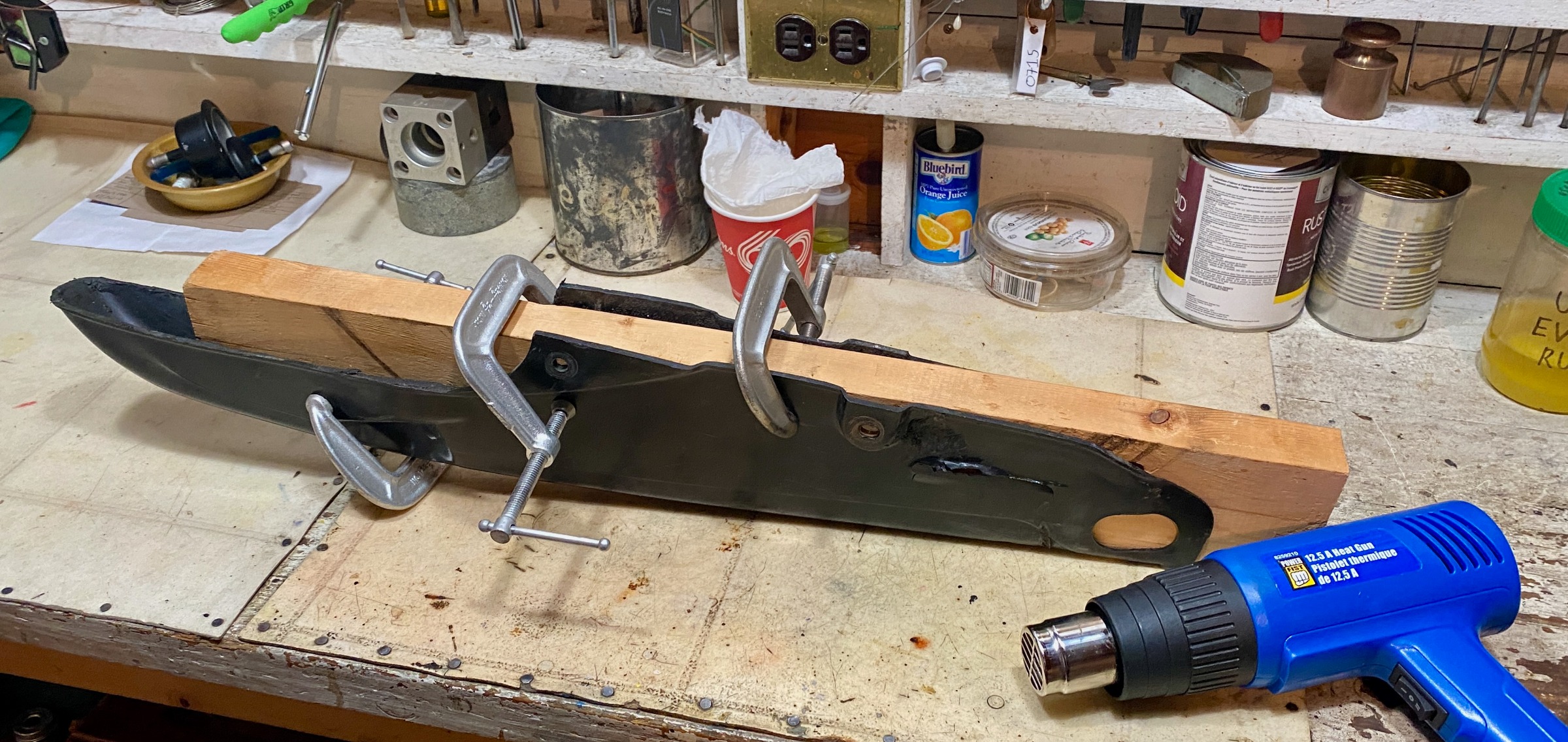

Somewhere in this long thread/project it was suggested that I use a 2X4 and heat to re-shape the KZ1000 plastic chain guard, which I prefer over the chromium guard currently installed.
So I fetched a length of wood and clamped it to the 2X4 where I thought it bowed out. Then used the heat gun to take the plastic to a temperature where I could still touch it, but not for long.
It worked really well!! When I took off the clamps the chain guard was much less mis-shaped.
Thanks guys.
Thanks guys.
