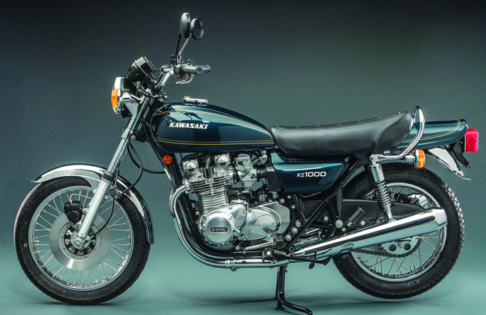

I found a few file pictures of the 1977 Standard KZ1000, chain guard side. Some of my ill-fitment might be the weird shocks I have installed where the coil spring goes lower. It looks like the stock shock's springs don't go below a cut out in the chain guard.
There's every chance I'll want more supple rear shocks in the future, so the current ones might get binned.
Thanks guys.

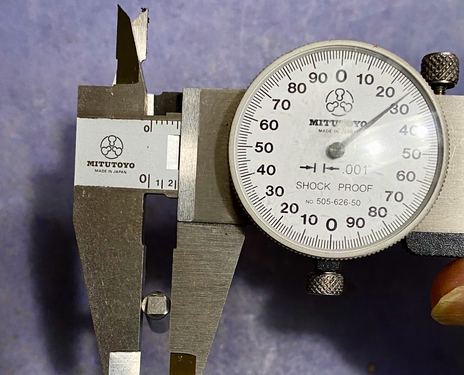

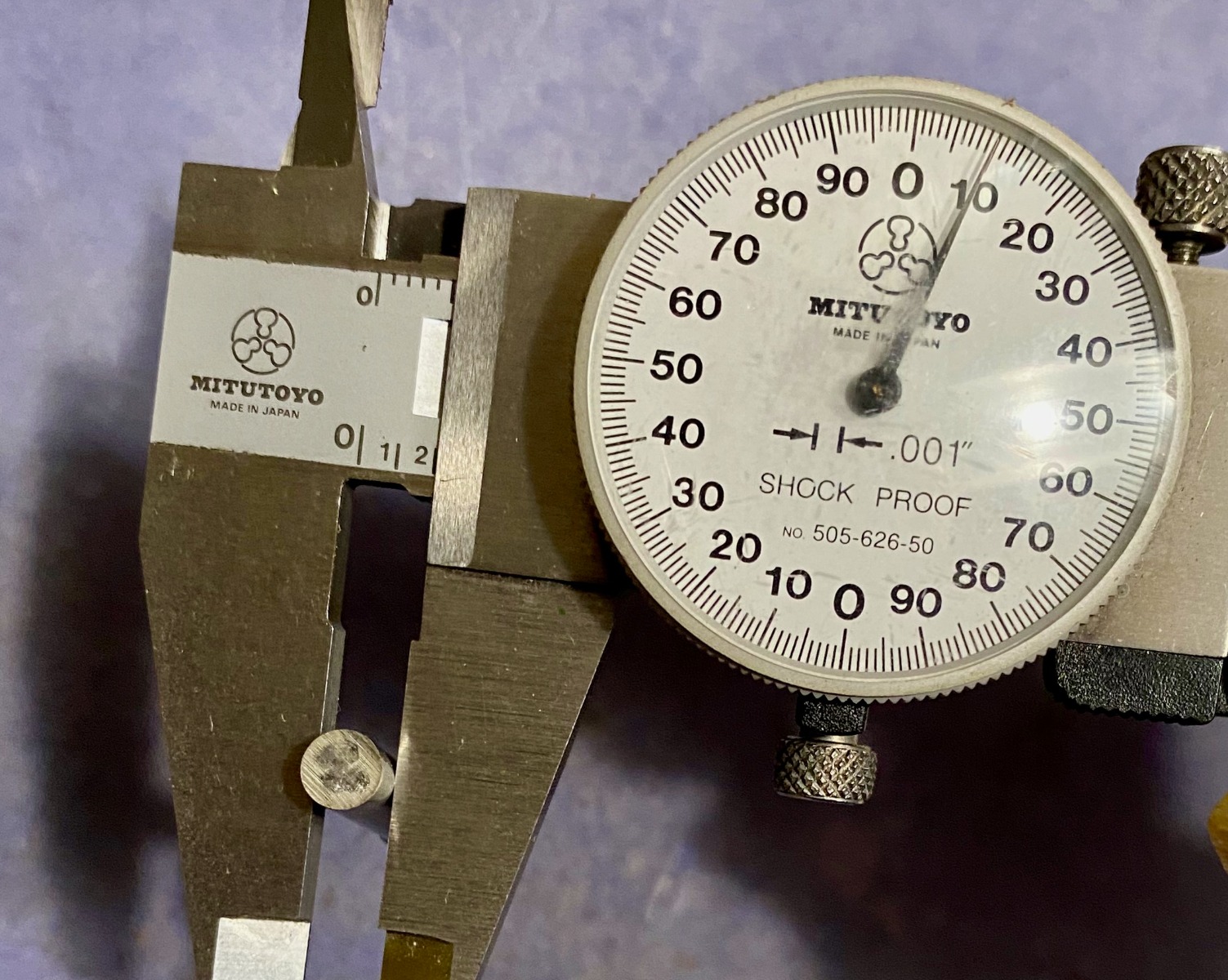

Had a coffee with Frank, the airframe riveter when he was a machinist apprentice in England.
Frank asked me how the rest of the chain was riveted, and I showed him the pin I had pressed out to shorten the chain.
With that guidance he suggested a punch with a 120 degree included angle (like a drill bit). That 120 degrees will flare the end of the pin AND push more metal into the pin hole in the side plate for a tighter interference fit. Frank suggested the same flare diameter as on the original pin, which is a diameter increase of about 17 thou.
Frank loaned me the punch in the picture, and said to "upset" the pin head gradually with several hammer taps rather than one big blow, as gradual upsetting is work hardening, and one big blow is more likely to cause splitting in the flare.
The calipers show my pins at 0.0210 inches and the "Quad-Staked" pin head at about 0.227. So I'll aim for a diameter increase of 15 to 20 thou.
Those earlier DID riveting instructions tell us to flare a 5.5 mm pin to 5.8 mm. Or converted to inches, 0.216 flared to 0.228 for a diameter increase of 12 thou. So same ballpark as the Quad-Staked process.
Some chance I may have overworked the planning of this task.............

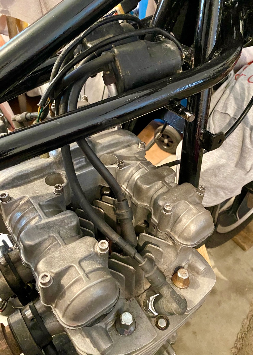

I had the cam cover finger tight, so figured to do a final installation. Put some goop on the head joint and gasket bottom, but not on the gasket top or cover joint. Might leak, who knows?
This meant the coils could go in place, so did that.
It occurred to me that carbs, exhaust, an IV bottle of fuel, and wire up a simple ignition with test leads , and it might fire up. But maybe later.
Next note about working of the kill switch.

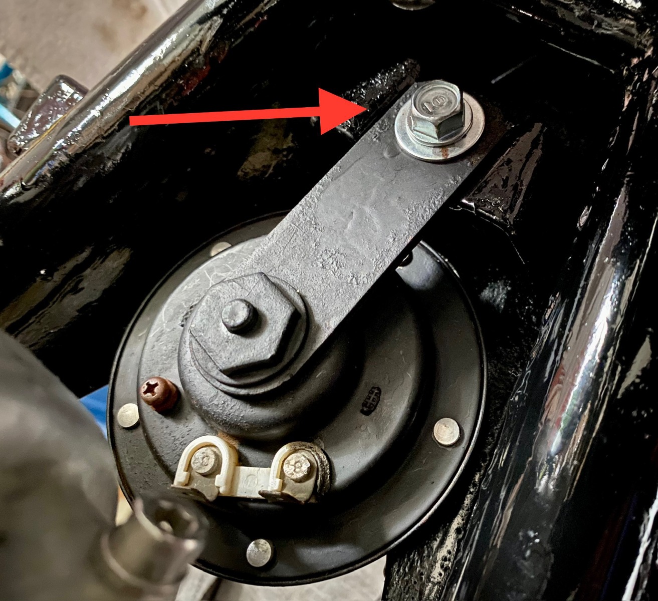

Small job to get the horn installed, but it took more than an hour.
The bolt is described as an M8 16 ( 8 mm diameter and 16 mm long under head), but I could not find the thread pitch. And neither a pitch of 1.25 or 1.0 would catch the captive nut which was clogged with thick paint. But the 1.25 is more common so I went with that, and it went in without stripping so seems correct.
