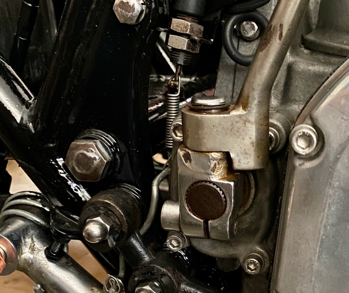

I dispatched that rust on the kickstarter as best I could with some WD40 in fine steel wool.

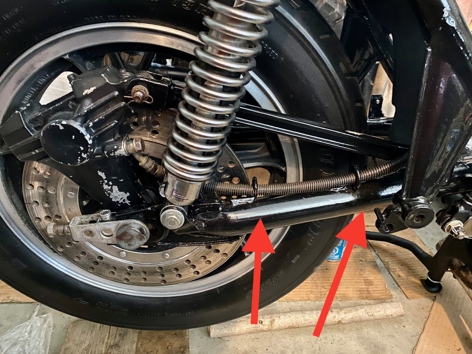

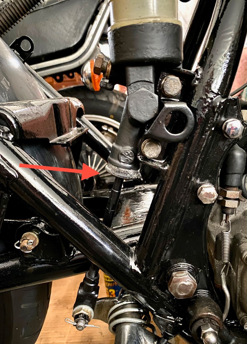

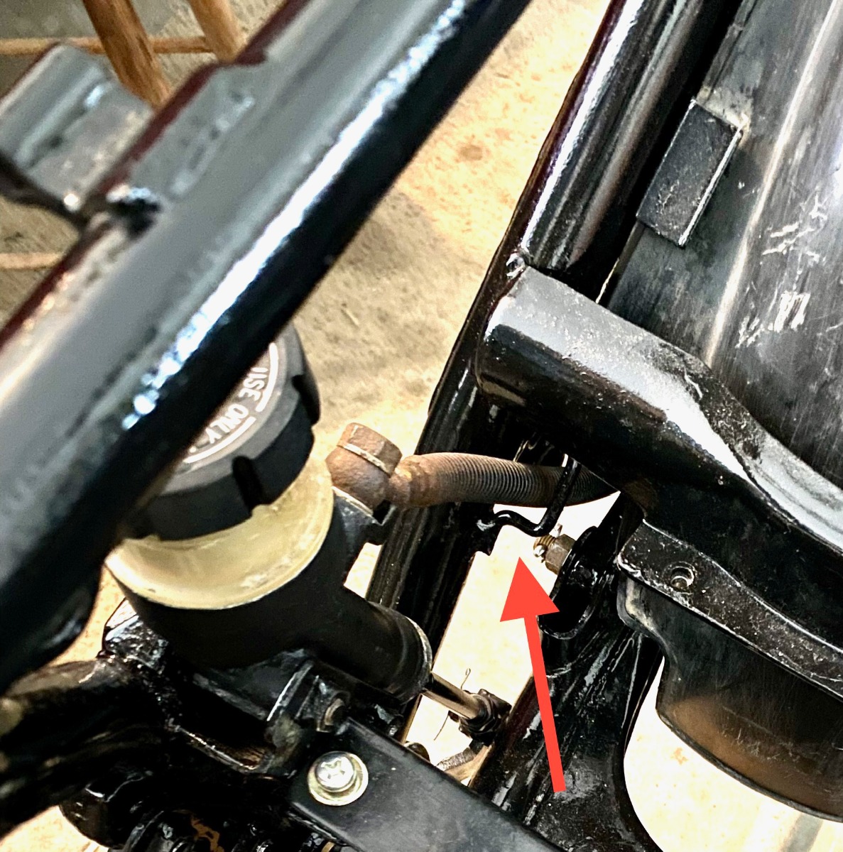

The rear brake hose was in reasonable condition, so that's installed. Is it correct to route the hose through the two circular hoops on the right arm of the swing arm, and then through the square loop behind the frame rail? I failed to take a picture of how she came apart.
Should I come to enjoy this bike, I'll get all new brake hoses.
Surprisingly my local Kawasaki dealer can get an OEM dust cover for the rear master cylinder. Only $20 in devalued measly $CDN.

I wouldn't be riding with that 46yo brake hose. That's false economy, it could blow on a test ride spraying brake fluid on the rear tire and then all of your time and effort is wasted. If you keep the bike it's done, if you sell it it's a selling point. Look up Apex Brakes, reasonable price, great quality and quick service.

14 Sep 2023 04:56I wouldn't be riding with that 46yo brake hose. That's false economy, it could blow on a test ride spraying brake fluid on the rear tire and then all of your time and effort is wasted. If you keep the bike it's done, if you sell it it's a selling point. Look up Apex Brakes, reasonable price, great quality and quick service.
Thanks Kelly E. I will replace that rear brake hose before any "serious" riding, since those brakes save your life pretty well anytime you use them. I've had an initial look at the Apex site.

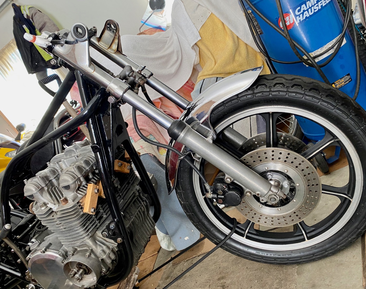

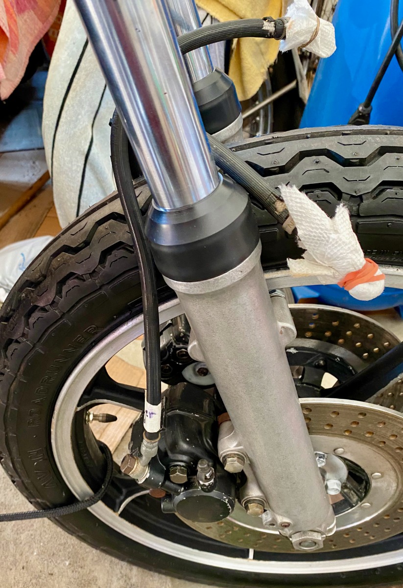

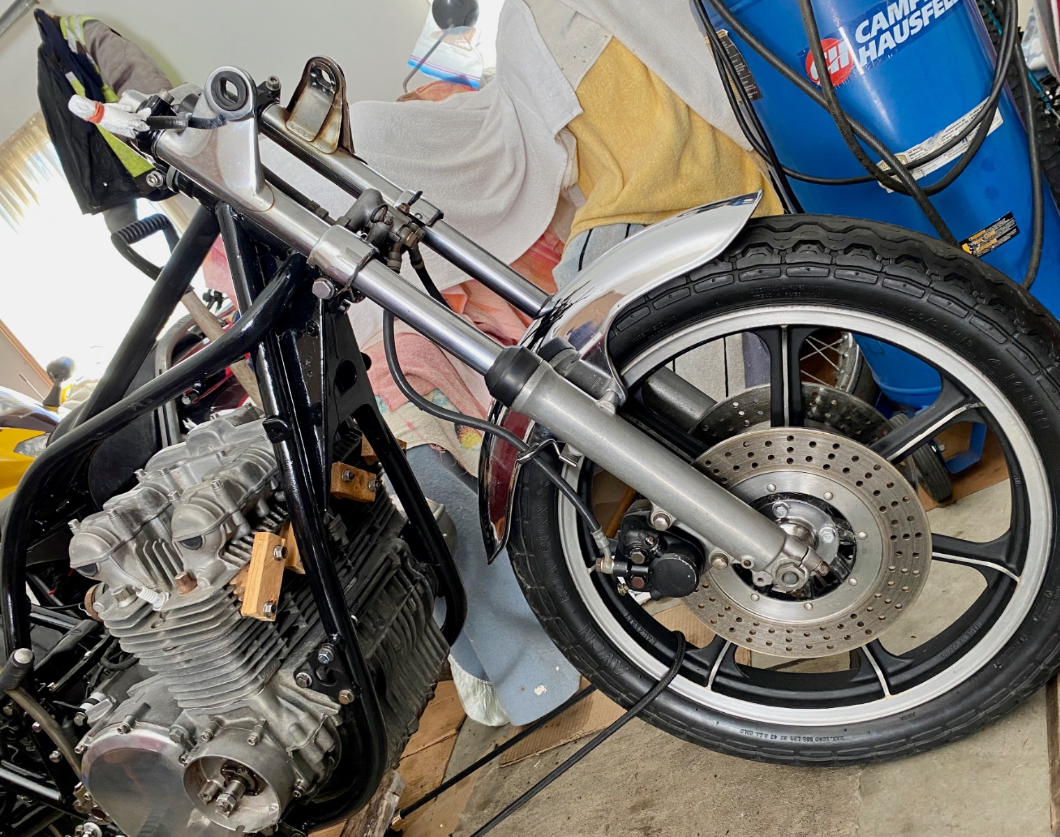

Did a few things on the front end today with brakes and fender.

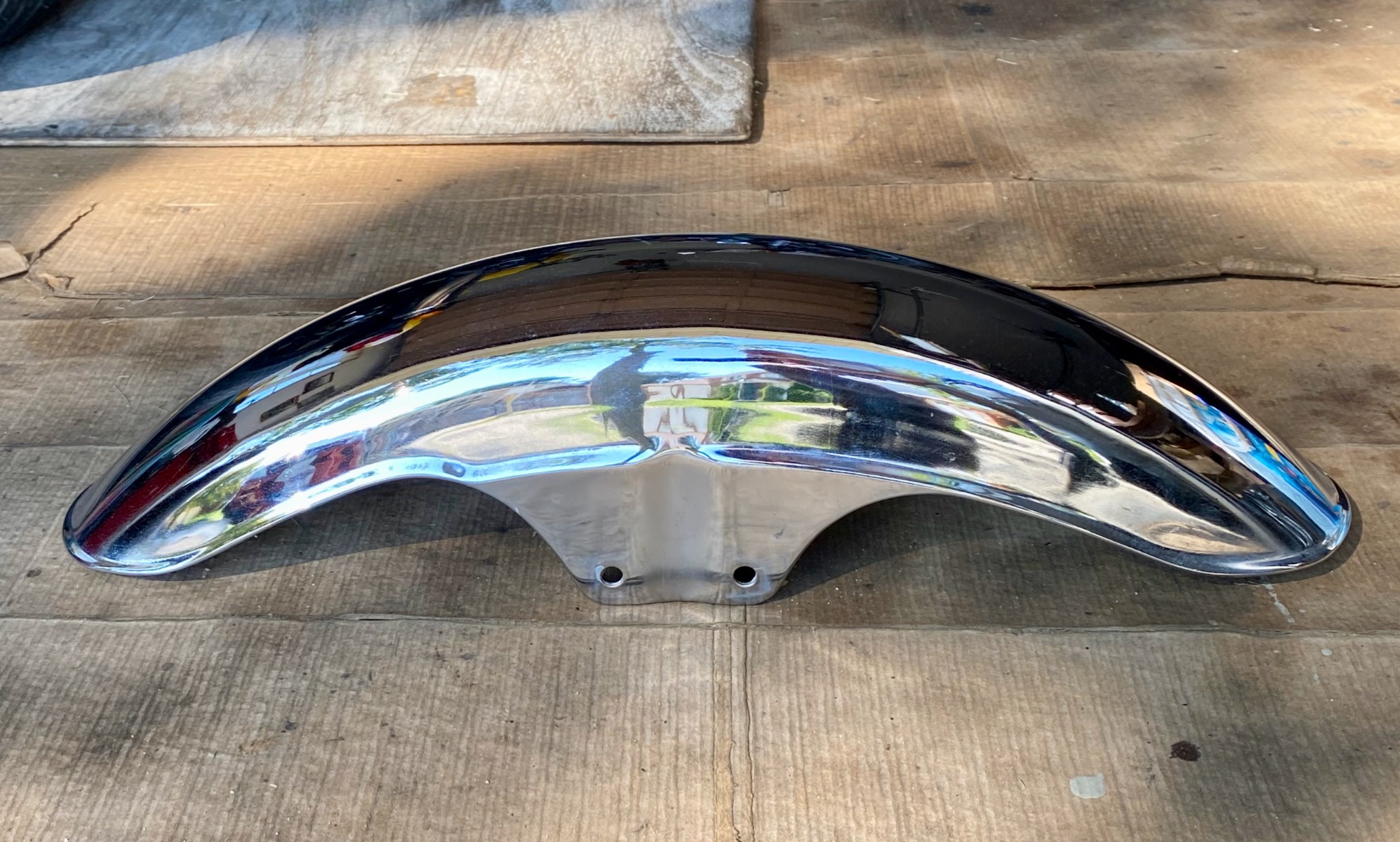

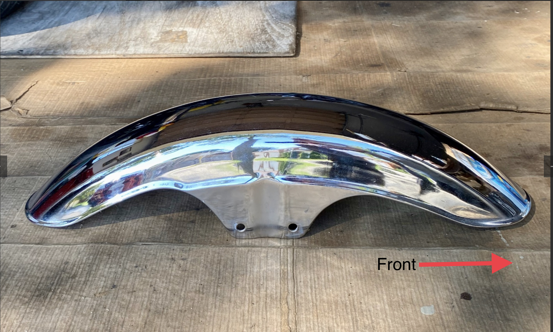

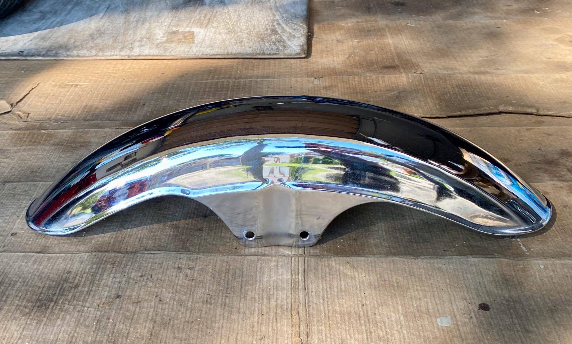

This fender looks symmetrical to me, that is, either end can be to the forward end. Do you guys agree?

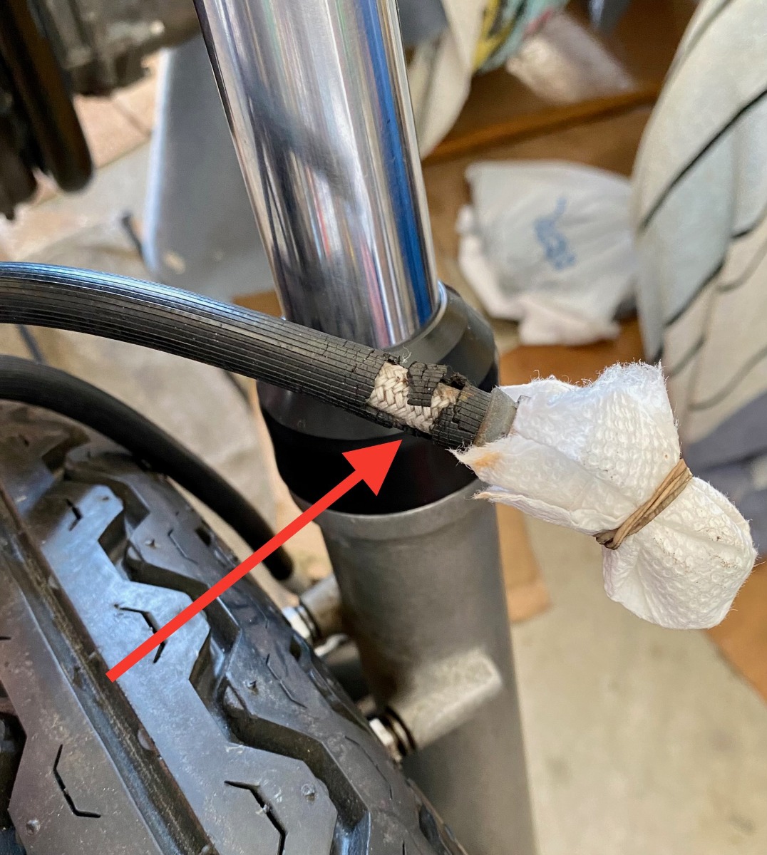

And this front brake hose bears witness to its age. However it looks like the woven carcass (where the strength is) is intact. So maybe that outer layer of rubber is like paint on a wall where there is no role in structural integrity.
New pads went into the front calipers.
What's the role of the two rings bolted onto the brake line junction block?
Thanks guys................

Re: Trying to Rescue a Late 1970s (1977??) Kawasaki KZ1000
14 Sep 2023 17:30

Thanks Mikaw
I've got an LTD front fender on my Z1A (one of those hot rod touches we all did back in the day) and all the times I've had it on and off I never noticed the difference. Now I'll have to check which way it's presently installed, maybe I got it right without knowing it. (Yet another piece of knowledge I've learned from you guys who know a LOT more about these bikes than I do)
Scotty
