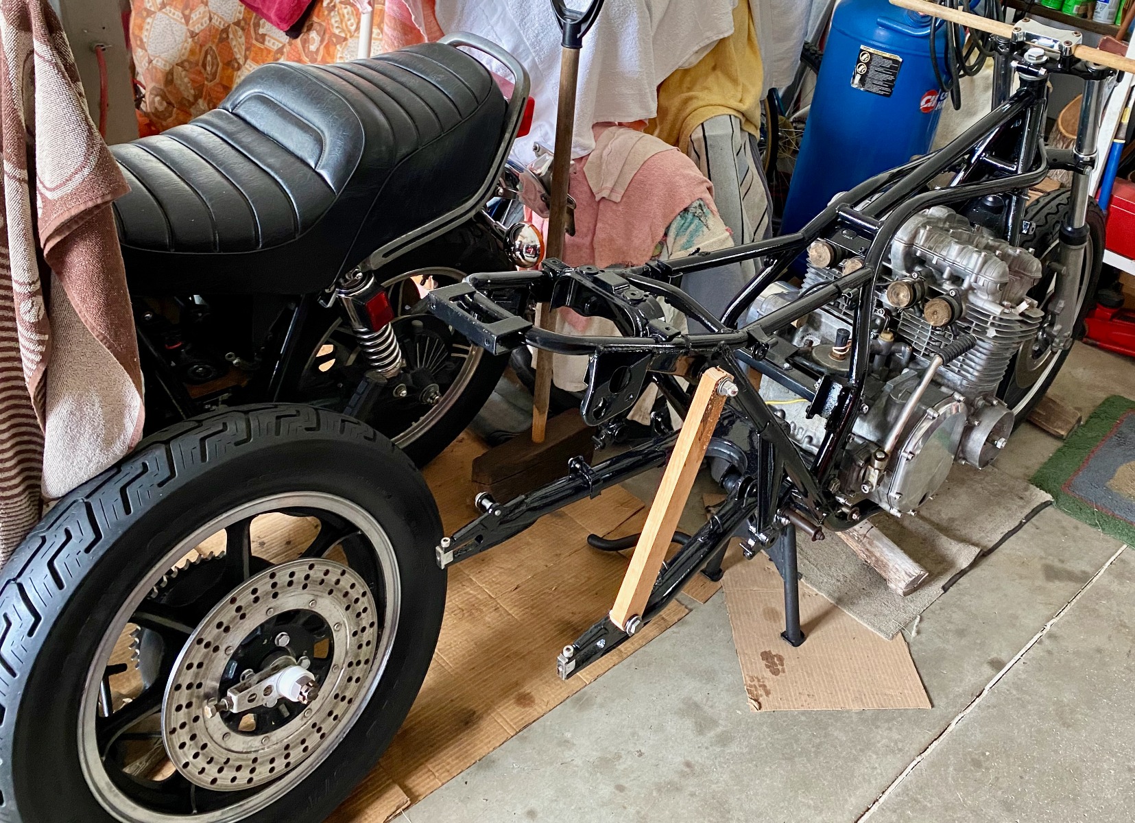

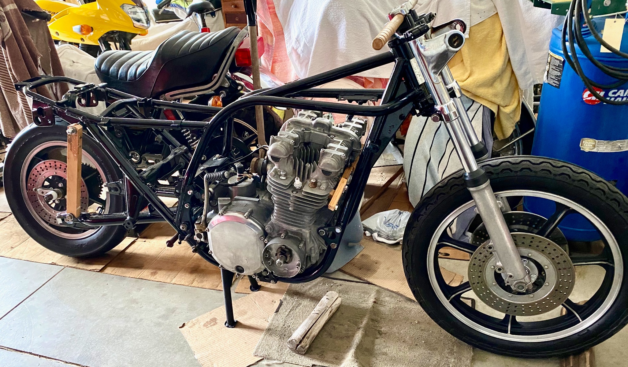

I had some help today from the neighbourly strongmen, incentivized with a box of Yukon Grizzly cones, even though the weather was not hot!
They lifted her tail up, allowing the center stand to drop into place. So I'll be able get the rear wheel assembly fitted and have a rolling chassis. And I can start loading bits onto her.
The wooden spacer in place of the rear shock just keeps the swing arm up temporarily, and similarly for the broom stick handlebar!!

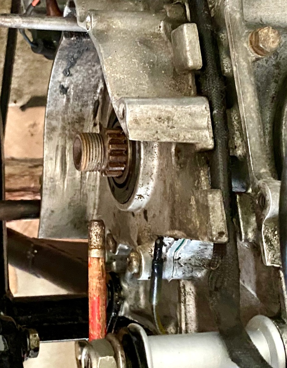

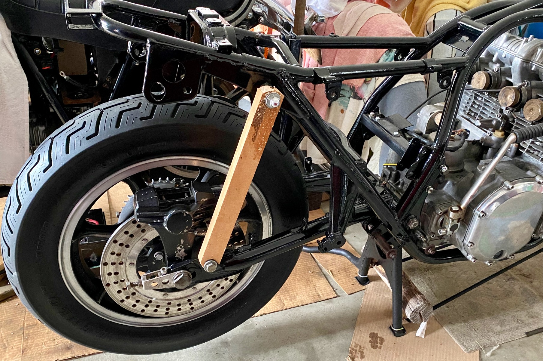

Big rubber on that rear wheel. It taxed me a bit getting that up out of the basement and into the garage.
But it slid into place nicely with the oiled axle a nice slip fit through all the components. Nut on the left as per the parts fiche.
I placed a 40 thou shim washer between the inner side of the rear caliper axle boss and the disc side wheel spacer. Nonstandard part, but it put the disc dead nuts center of the caliper slot. See red arrow.
Set the axles mid-groove in the swing arm chain adjustment slots to check for sprocket alignment. My old wooden arrow is not as straight as an arrow, but suggests that the final drive sprockets are in good alignment, which requires some imagination since the engine sprocket is not yet in place. Since the whole steel frame is a "spring", a rip in the lower gears probably elastically pulls things out of alignment a bit. So close enough.
Next might be the rear shocks and get that brake stay on. Basement work bench is getting lighter.
Nothing quite like the rip of a Big KZ
- Posts: 3163
- Thanks: 1252
Re: Trying to Rescue a Late 1970s (1977??) Kawasaki KZ1000
10 Sep 2023 18:26
The front sprocket must be the one with a shoulder on the inside to provide enough space for a 630 o-ring chain. If the sprocket doesn't have the shoulder the chain will rub the heads off the screws holding the transmission cover in place.
