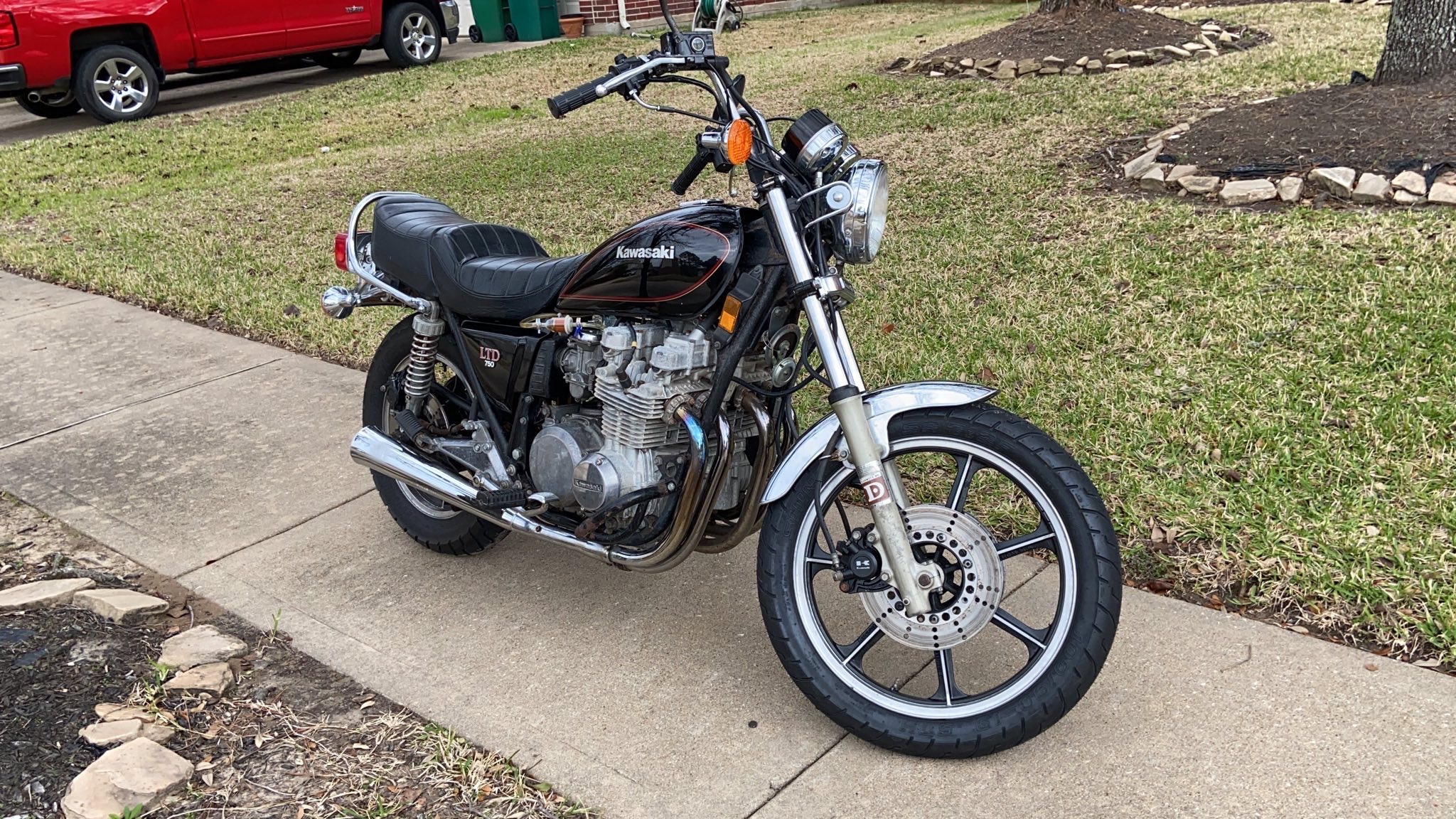

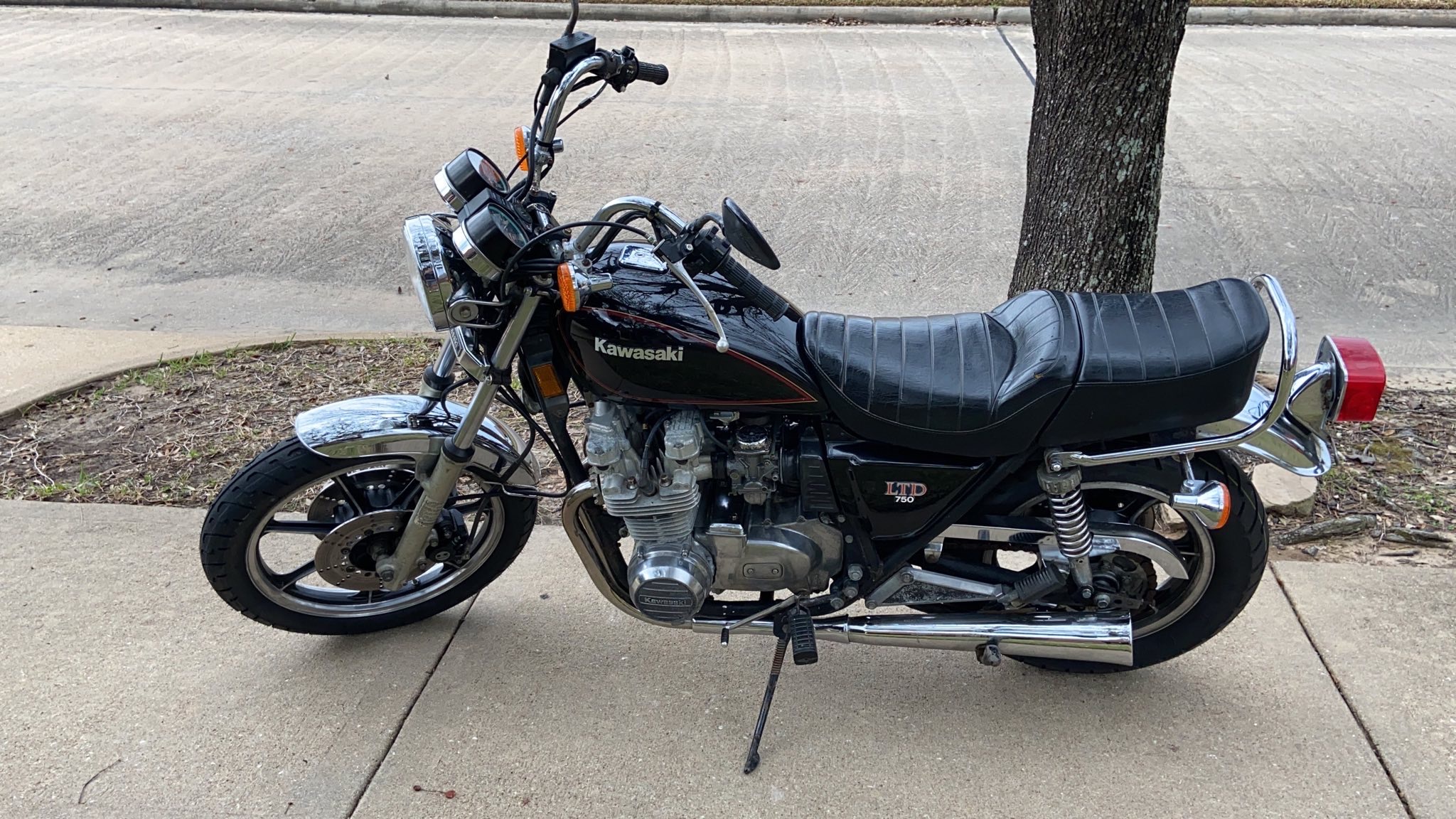

Got her back together. Brand new shoes....just passed inspection! In the end the only new parts she NEEDED were front and rear master pistons/plunger rubber, and new pads. Other than that everything just needed a LOT of elbow grease and attention to detail.
Title is transferred...just need to pay taxes on her to get tags then she is officially back on the road from her multi decade sabbatical in a barn.
Running an inline filter at the moment which at first caused a vapor lock issue (no fuel) but we worked past that. I am only planning to run this until I run a few tanks of gas through her as the tank cleaning was successful but there still may be things floating around in there.

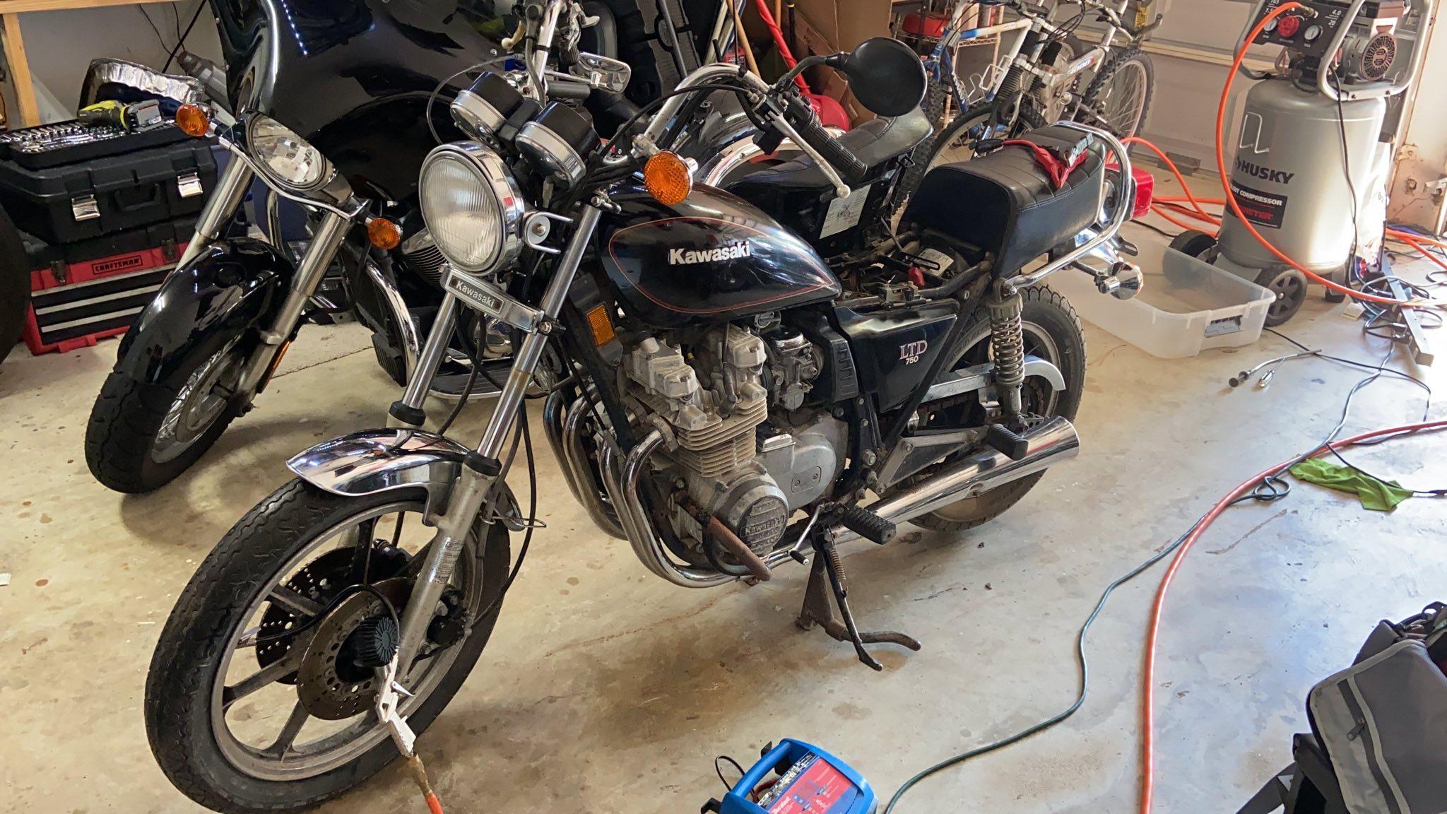

Before:
Still several things to polish up/spruce but the bulk of the work is done.

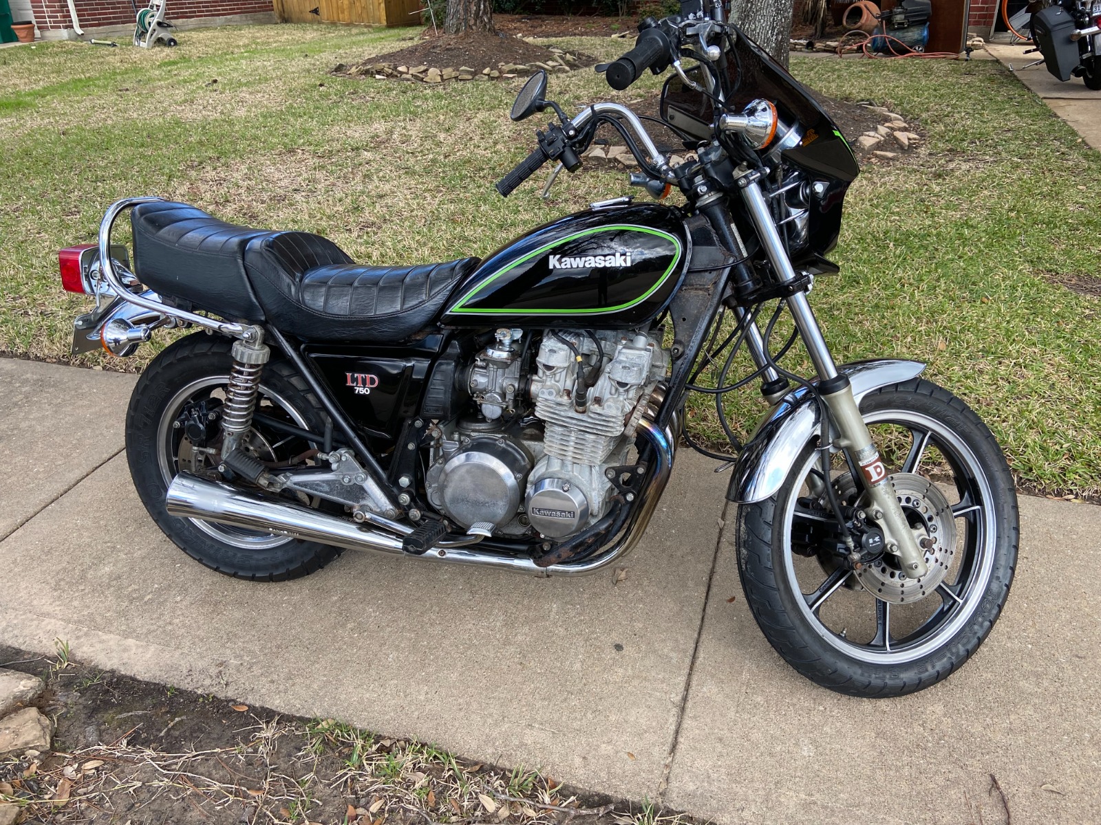

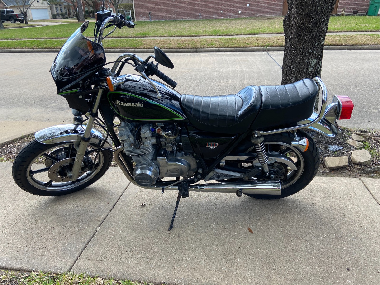

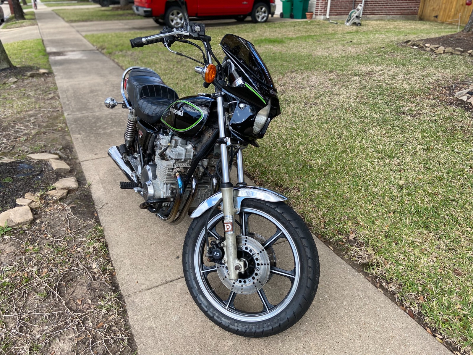

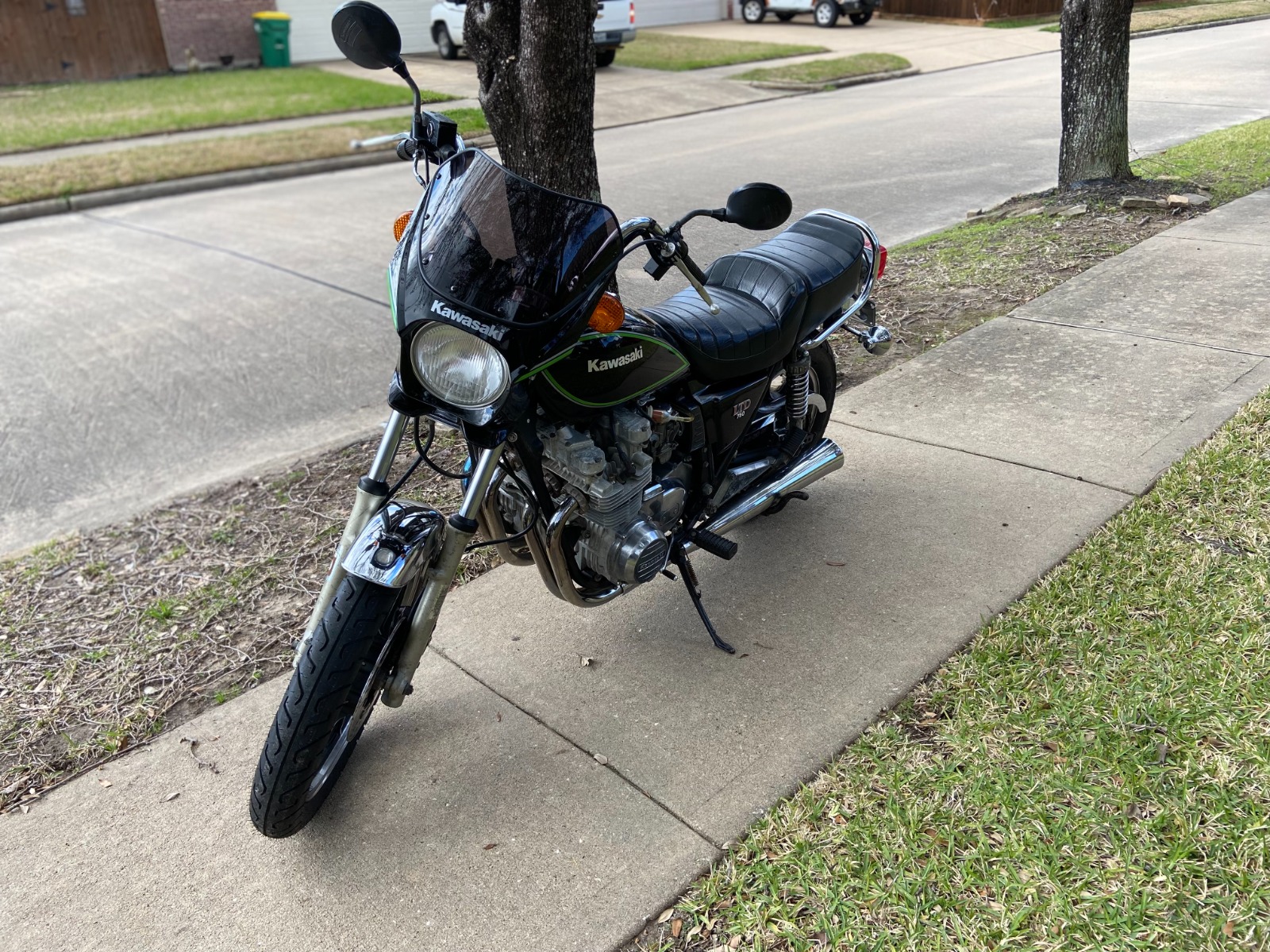

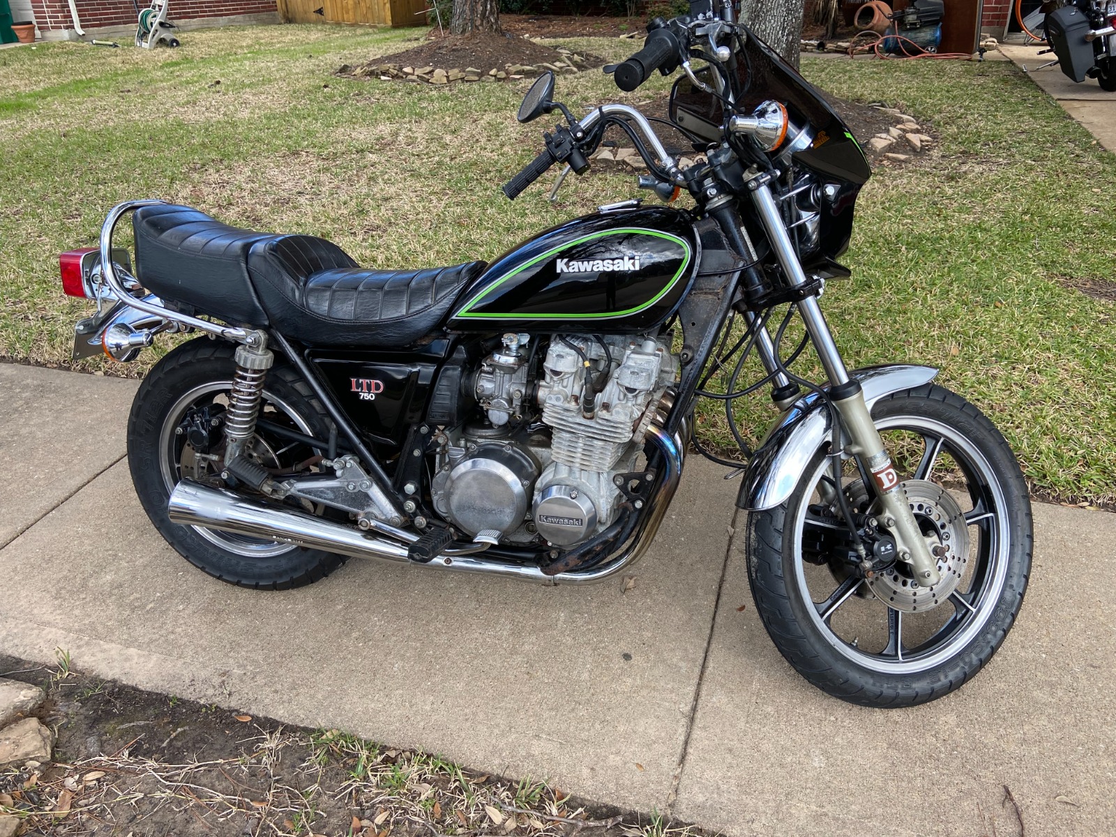

Added Ebay EMGO Venom fairing and Silver/Kawasaki Green pinstriping as the OG pinstripes were coming up.
I searched for ages here for pics of this fairing on these bikes but found none so here ya go.
The Kawasaki decal I made and the pinstripes really do bring everything together.
Still cleaning parts and polishing here and there but this is where we are so far.

Thanks. How's the wind noise? I tried a similar sized vintage fairing & wear a full face helmet >> the helmet wind noise was still pretty bad which was my reason for trying a fairing. doh.

Took her out for a spin to the next town over a few nights ago then to bike night the following day. The fairing makes a massive difference. Good chest wind protection. I wear an AGV helmet and its prolly one of the quietest I have ever had. Not saying its silent or anything but pretty darn quiet.
The kids on their new sport bikes got a kick out of it.

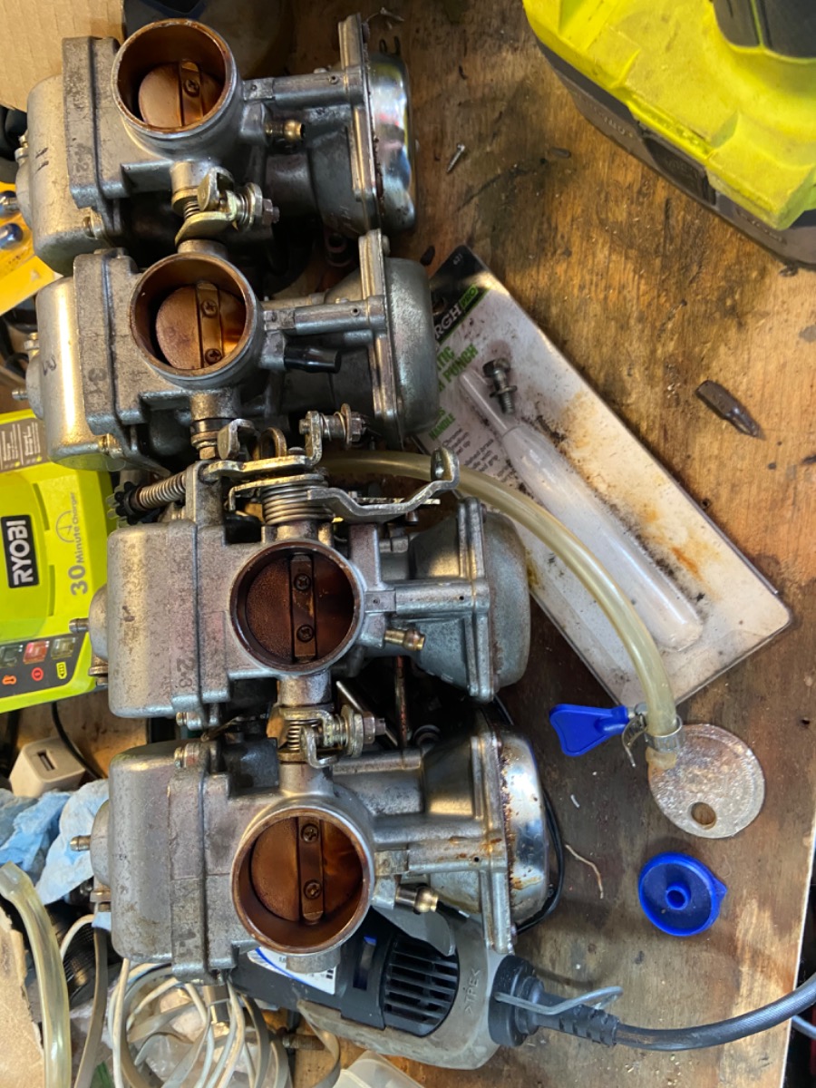

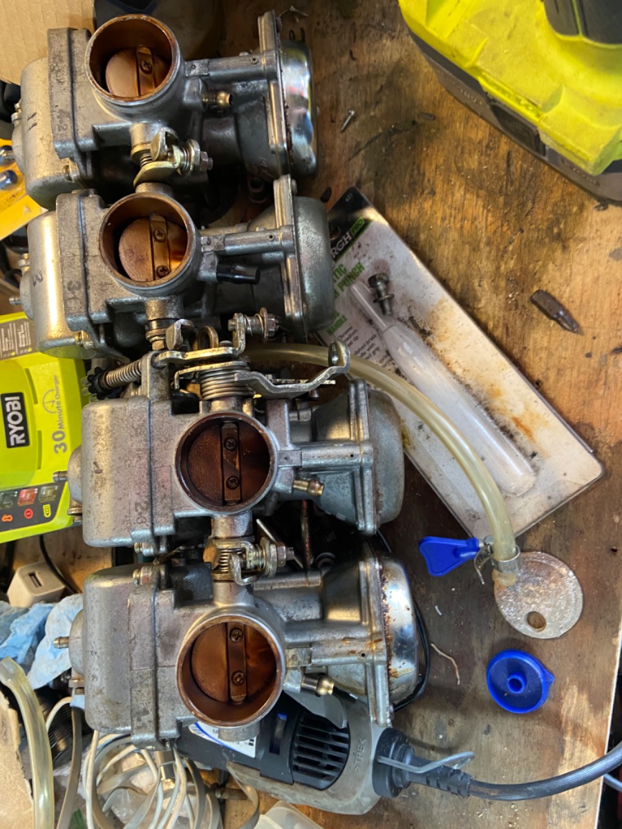

She was a bit lean...stuttering between low RPMs and higher ~4k then it would clear up and take off. I am running a service loop with a filter right now and I guess its just too much for a gravity fed setup.
Planning to cut the tubing and run a straight line with an inline filter to get rid of this suspected issue. If that does not work then I reckon Ill have to pull the carbs again and see what is going on.

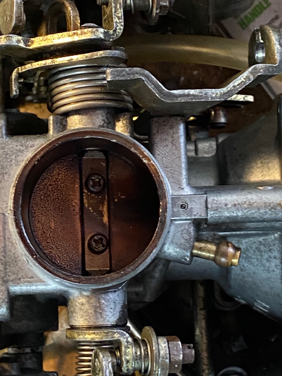

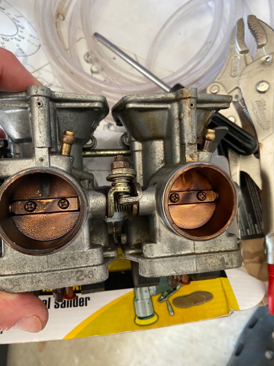

Dirt in the pilot circuit , pilot bypass. 3 tiny holes just behind and above the throttle butterfly. Essy to block. Easy to miss when cleaning. I have the same carbs.
BTW Great looking bike

Dang it. Off they come then. Thank you for the tip!

Restriction from a filter won't cause a midrange bog, it may cause bowl draining, and engine cutout, at high rpm on the highway, though. If your tank is clean, a filter isn't needed. If you want a filter regardless, get one for a gravity fed fuel system, not a pressure system. They don't filter all that great, because they need to flow easily, but the type with a gold stone inside should work.
