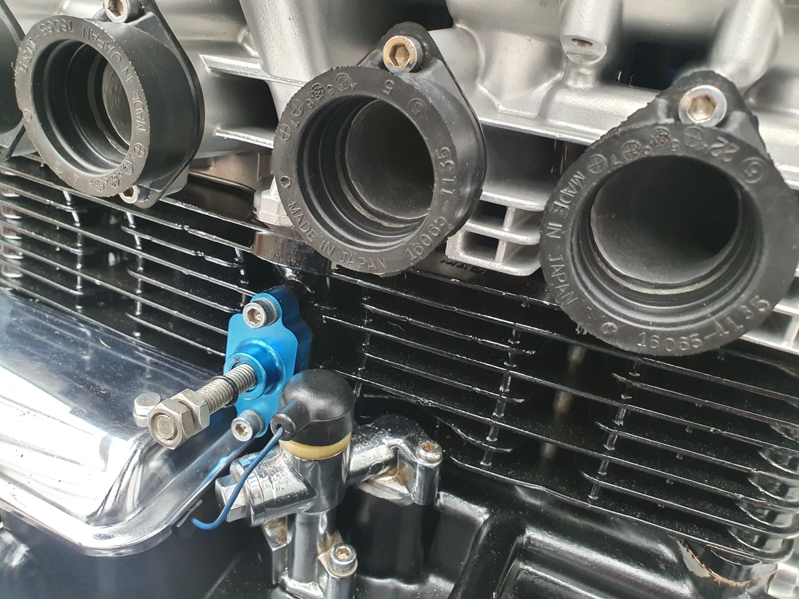

The rubbers were milled to match the ported intakes.
With 38mm flatslides and 430 cams it has never been vacuum synced.

I think I understand. The inside diameter of the intake boots was milled to make them larger. Do you know why the synch ports were removed?
- blackozvet
- Posts: 193
- Thanks: 79
Re: 1973 Z1 rebuild
24 Oct 2022 19:52These intake rubbers are #16065-1135 which are from early 80's Z1000J- they dont have vacuum ports.I think I understand. The inside diameter of the intake boots was milled to make them larger. Do you know why the synch ports were removed?
Engine builders in the 80's were using these rubbers for ported head/large carb applications. Lack of vac port was a bonus, coz they are just a potential leak in a race engine.
My rubbers were then bored on the inside half to match the diameter of the ported intake.

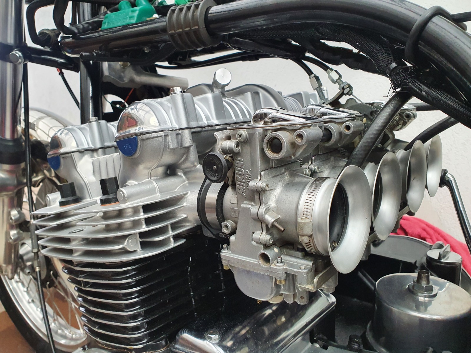

First thing on the agenda is to get the garage cleaned up - too many boxes everywhere.
Now take the carbs out of their box and throw the box away!
The carbs on this engine are Mikuni 38 mm flatslides.
I take the carbs apart, give everything a good clean, blow out all the orifices and put it back together.
Once the carbs are on, its time to fit up the new throttle cables. I have used the 'short ' version of the cables, which are 990mm - it doesnt sound short at almost a metre but its just about perfect for my application.
Its a little bit tricky getting the new combo together as I have deleted the remote single quick action throttle and gone back to the stock type push/pull throttle grip mounted in the switch block, but eventually get it sorted.
The engine is now looking almost done - the only thing remaining is the camshafts.

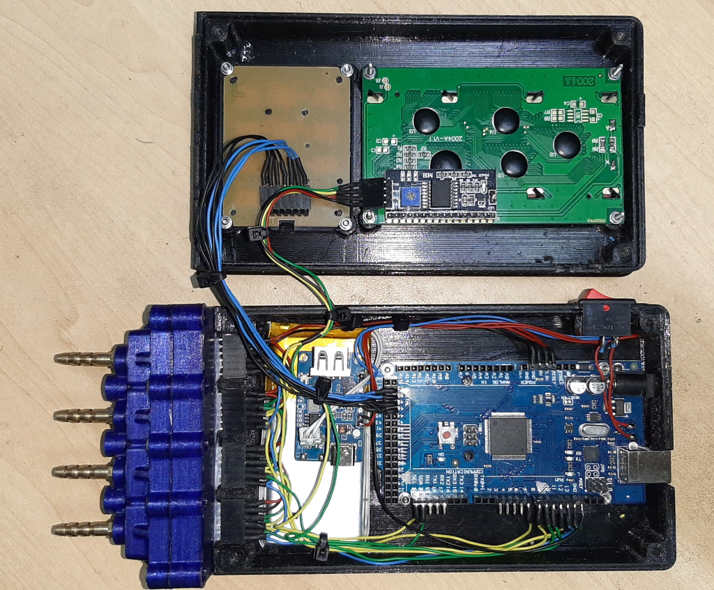

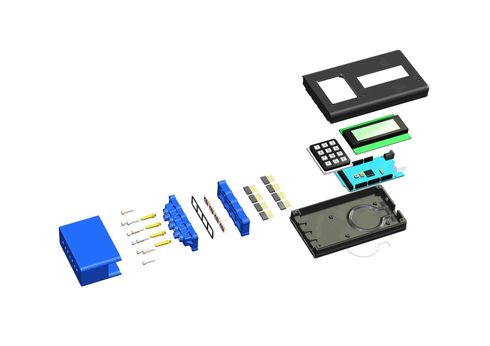

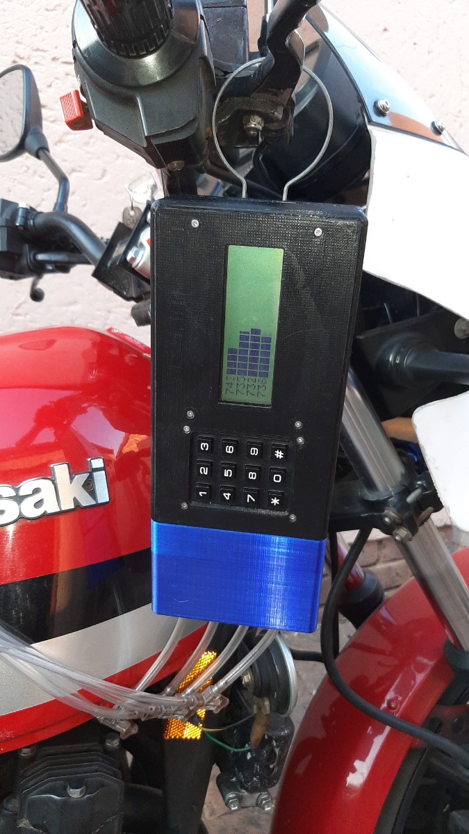

"Vac syncing is worthwhile to get the smoothest running, you could do this with the tool I posted or if your hearing is ok you could go "old skool" and listen to the intakes with a length of 1/2 inch hose and adjust until the rush of air in the intakes sounds the same
+1 !
I agonised over getting the vacuum sync. "right". However, using "analog" guages or Carbitune bugged me, in the digital age....
So I designed a digital sync. tool:
It uses four individual Bosch atmospheric sensors, like 2 dollars each.
Internal Lithium Ion battery, charged by cell-phone charger!
The trick was embedding them in an "air-tight (vacuum tight) housing, with 4 electrical connections to each one.
But, it's totally do-able.
The graphic display of each cylinder's vacuum is an expanded scale of 100millibar, and can be switched to inches or millimetres Mercury.
Being digital, calibrating all 4 sensors is simple... my software measures ambient atmospheric pressure before starting a sync. and, using channel 1 as the "reference", offsets the other 3 to read the same value.
I managed to set the sync to withing 2 mmMercury. (ok, so it took some patience...) now, once warm, it will idle happily at 500 rpm!
It's quite remarkable what a difference a good sync. makes.
If anyone wants to make one, I will gladly supply all the 3D print files, circuit diagram and the software, por nada!
H.

Howard that is an awesome piece of kit, you should sell the idea to one of the many equipment company's out there

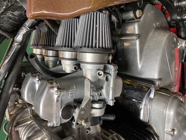

25 Oct 2022 11:38When I got my 76 KZ900, the "sync" ports appeared to be drilled into the intake portion of the head (see pic). It originally had Mikuni 33 mm SB's and the carb holders did not have sync ports.These intake rubbers are #16065-1135 which are from early 80's Z1000J- they dont have vacuum ports.I think I understand. The inside diameter of the intake boots was milled to make them larger. Do you know why the synch ports were removed?

25 Oct 2022 13:18That is similar to the factory set up on a CB900When I got my 76 KZ900, the "sync" ports appeared to be drilled into the intake portion of the head (see pic). It originally had Mikuni 33 mm SB's and the carb holders did not have sync ports.These intake rubbers are #16065-1135 which are from early 80's Z1000J- they dont have vacuum ports.I think I understand. The inside diameter of the intake boots was milled to make them larger. Do you know why the synch ports were removed?
