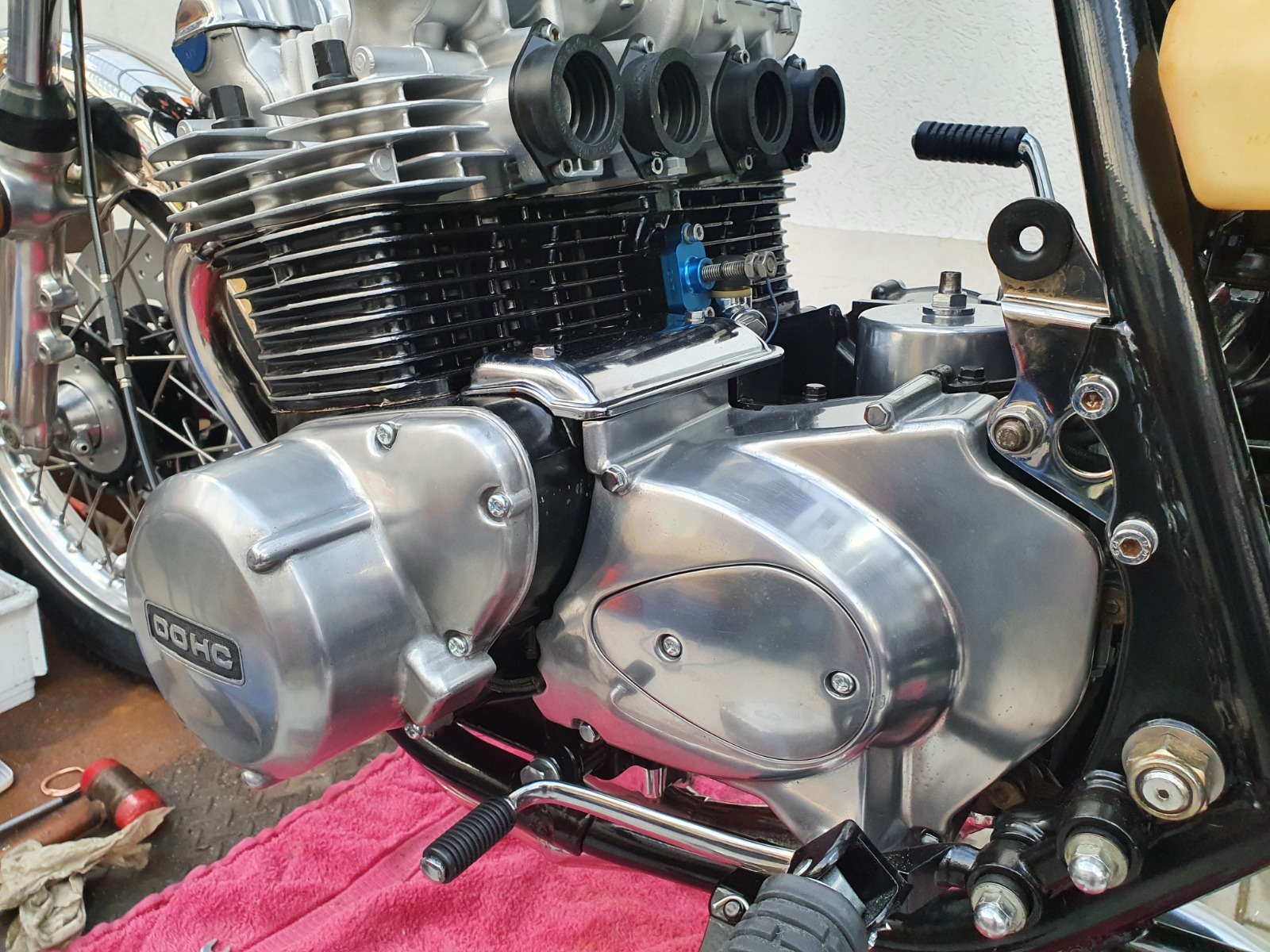

Today I finished tidying up the wiring and getting it tucked in the centre of the frame.
Next job was to get the dynamo into the cover and bolt it on (without the starter intermediate gear for now) and get the sprocket on, clutch cable hooked up and cover on - of course my wonderful polishing is now covered in grimey hand prints.
Then onto the right side to finish off things and get the kick starter on with a new rubber.
Also clean up the carb rubbers and bolt them on.
Polish up the headers and get them bolted on.

I just noticed that your head intake boots don't have the port for synchronizing the carbs. Is that an early head?
- blackozvet
- Posts: 193
- Thanks: 79
Re: 1973 Z1 rebuild
24 Oct 2022 05:02Those rubbers were supplied and milled to match the ported intakes by the engine builder.I just noticed that your head intake boots don't have the port for synchronizing the carbs. Is that an early head?
I'm pretty sure I gave the original ones to him on an exchange basis.

I would think that could cause a tuning issue later down the road. Is there any other way to vacuum sync the carbs you have?

The intake boots were milled? That's interesting. Do you know why?
I guess you can do a mechanical synch on the carbs but I don't know how you can ensure they are all at the same iintake pressure.

24 Oct 2022 12:48The manifolds have been milled to match the ported head (I think this was a hot motor at one time, not sure now ?) you can sync with the below vacum gauge used on sidedraught webbers etc but it is a PITA because you have to read each one individually and note or remember the readingsThe intake boots were milled? That's interesting. Do you know why?
