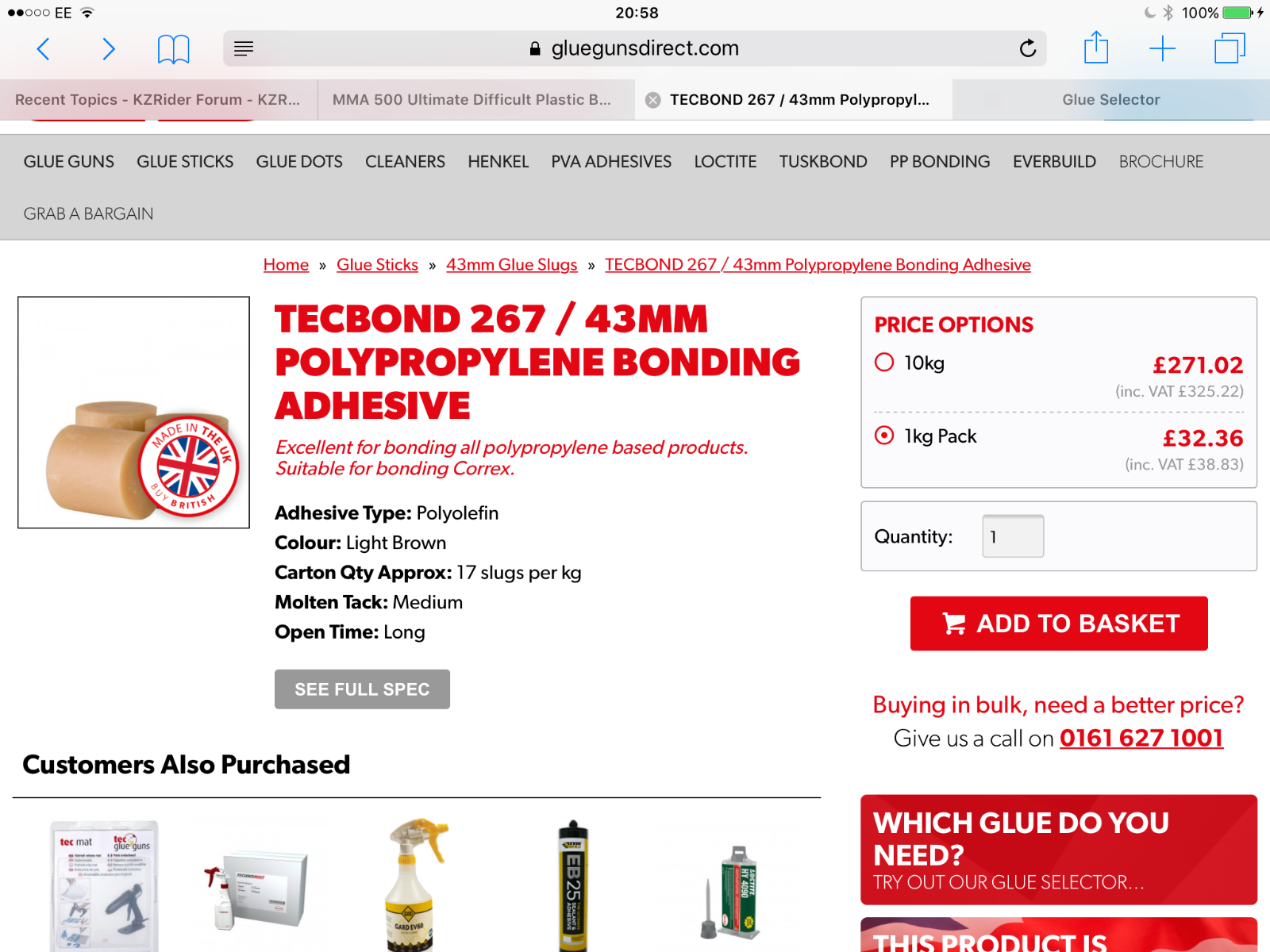

So another weekend of plastic and fibereglass draws to an end. Been making good progress with the seat pan and a few minor tweaks to the tailpiece but nothing picture worthy at the moment. I had to narrow the rear of the seat pan which is done now and I have started constructing the extension piece for the back which reaches over the tailpiece. Once I am happy with the seat and tailpiece I can make the planned mods to the side panels ( nothing radical, I just want them to fit better than they do now) I have run into a bit of a hold up (other than waiting for adhesive and resin to set !!) All the research I did and the materials I bought are "ABS" however it appears the pan is "polypropylene" there seems to be very few adhesives suitable for polypropylene and even less to join it with "ABS"
I have found a "hot glue" product that claims to be suitable but it is an industrial product that comes in 43mm slugs - the gun for this is approx £400 which obviously I am not going to buy to use once ( maybe again in the future but don't tell my wife) so I need to find out how long it stays fluid after heating, the plan is to melt with a heat gun then apply with a spatchula if it stays workable long enough. All part of my education " every day is a school day"

14 Aug 2022 14:38Thanks for the info, a lot of car parts are like bike bodywork (ABS) which is easy to bond (and reinforce with scraps dissolved in acetone to make a paste/filler) I will have a look at these products. below is what I have been looking at but I need to call them tomorrow - it says it has a long "open time" but I need to know how long it is workable before I can even consider itit appears the pan is "polypropylene"

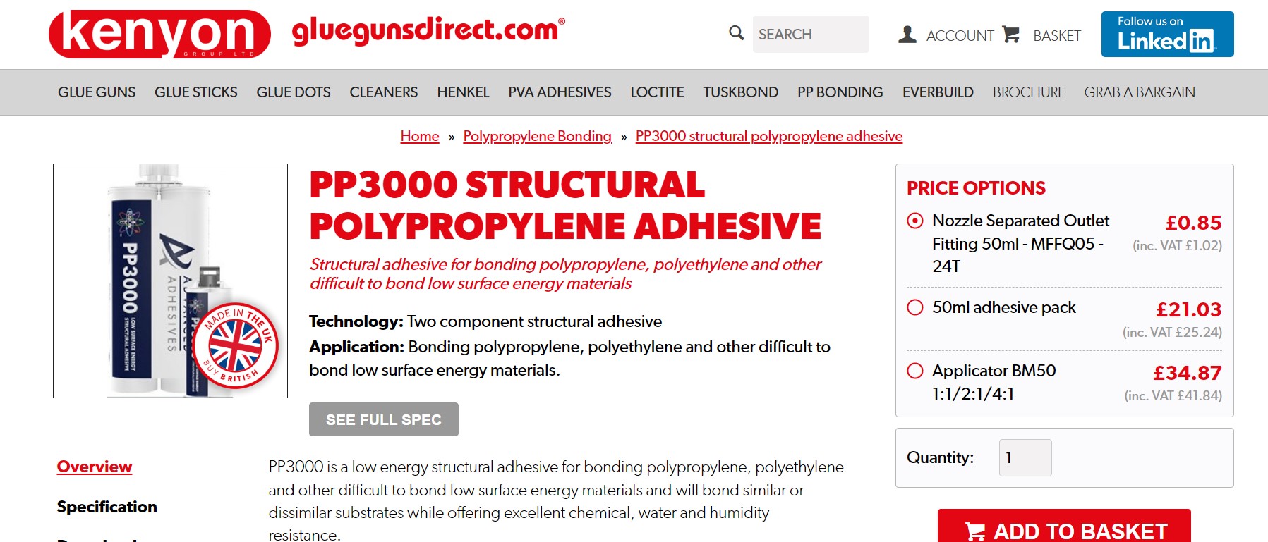

15 Aug 2022 06:43The 3M product looks really good, I have however gone with the below which appears to be a very similar product from a UK firm. The adhesive is a similar price but when you factor in the applicator gun and nozzles etc the 3M works out about 40% more expensive. Hope "it does what it says on the tin"it appears the pan is "polypropylene"
