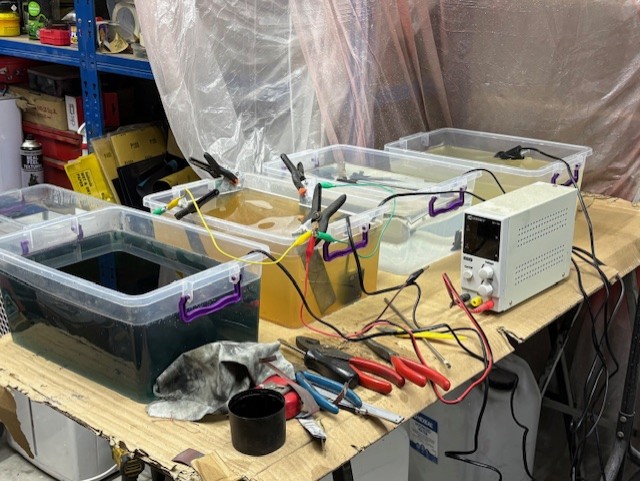

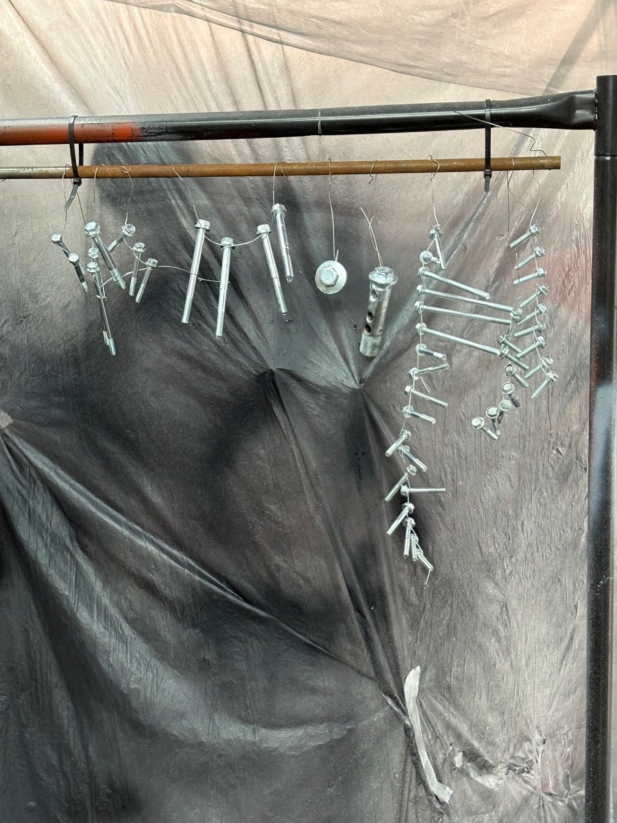

Today has been a day of wire brushing and plating oil pan and crankcase bolts, not much fun but worth the effort for corrosion protection

Nice. What sort of playing setup do you use?

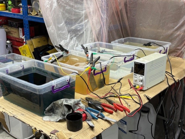

30 Mar 2026 00:08 - 30 Mar 2026 00:09I bought this kit from Ebay and use four 10ltr tanksNice. What sort of playing setup do you use?
Ultimate Bright Zinc Electroplating Kit + Power Supply - for DIY restoration | eBay UK

Thanks. Now that I see it, I seem to remember that you posted this previously. Do you rebottle the fluids when it is not in use?

30 Mar 2026 06:49At the moment I just use the "clip on" lids on the tanks. Once this build is finished I will put it in "screw top" containers to avoid accidental spillage and evaporationThanks. Now that I see it, I seem to remember that you posted this previously. Do you rebottle the fluids when it is not in use?

More parts finished over the holiday weekend (family was over yesterday so I was banned) I've rebuilt the starter, body and fittings plated (the yellow passivate didn't work out too well so I scuffed it off with some 000 steel wool which has left the zinc behind and looks way better) I also need to turn new insulators. The brushes are worn but at $140 they will do for now, I also skimmed the armature.
