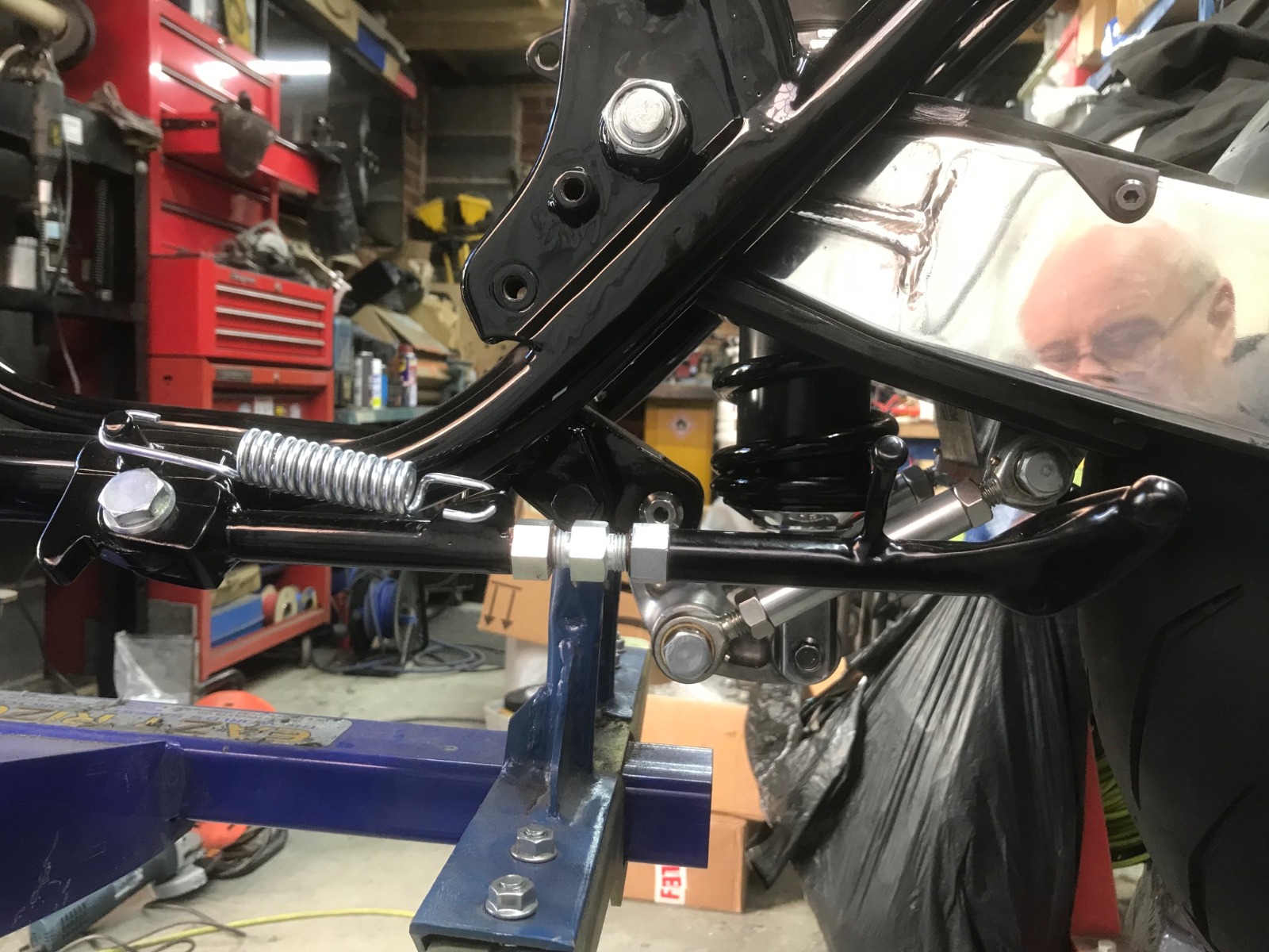

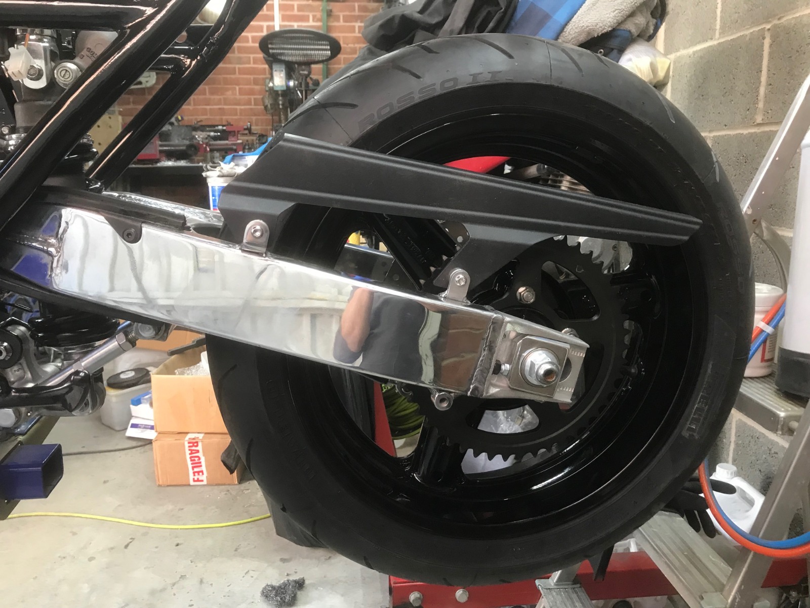

Also managed to get the stand assembled and re-fitted after plating the required parts and fitted the OEM (Suzuki) chain guard with some spacers to move it in as necc, it's going to want a trim though (too long !)

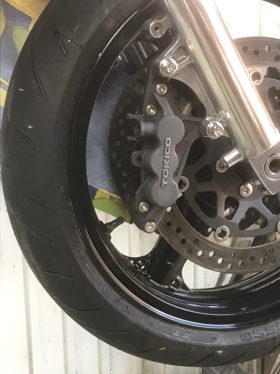

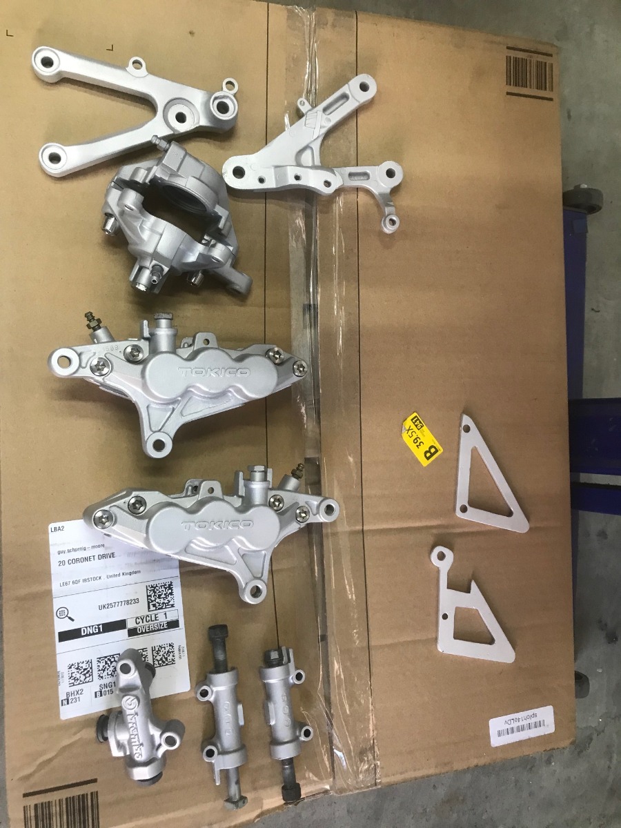

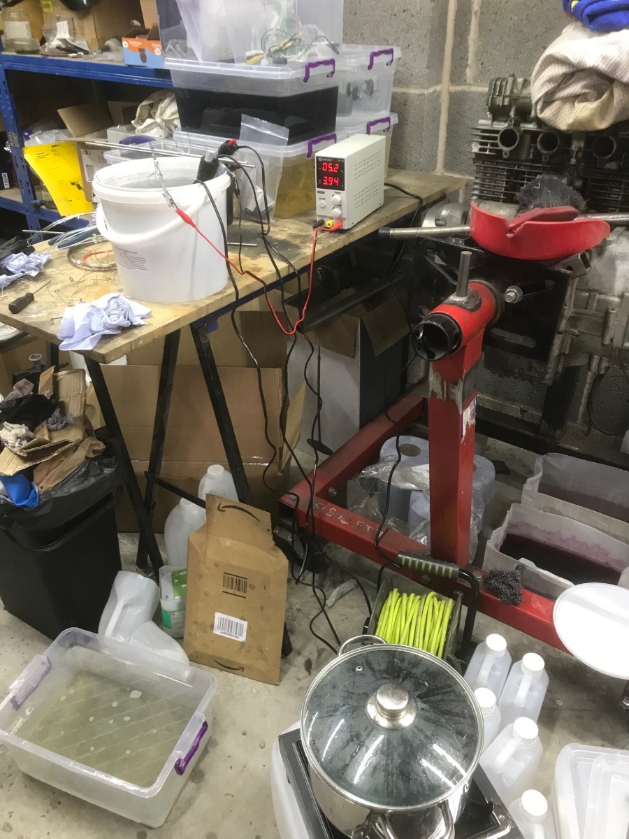

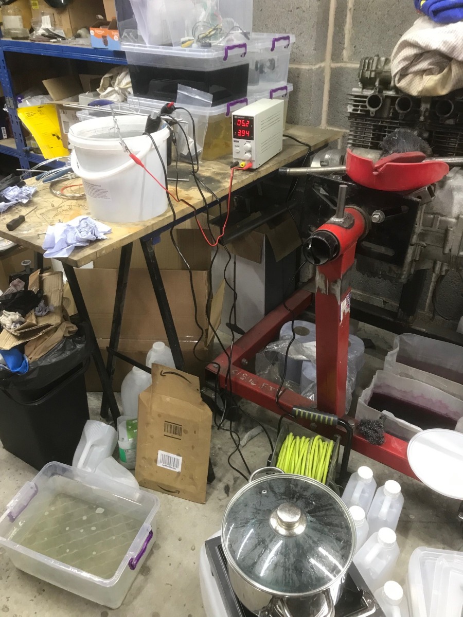

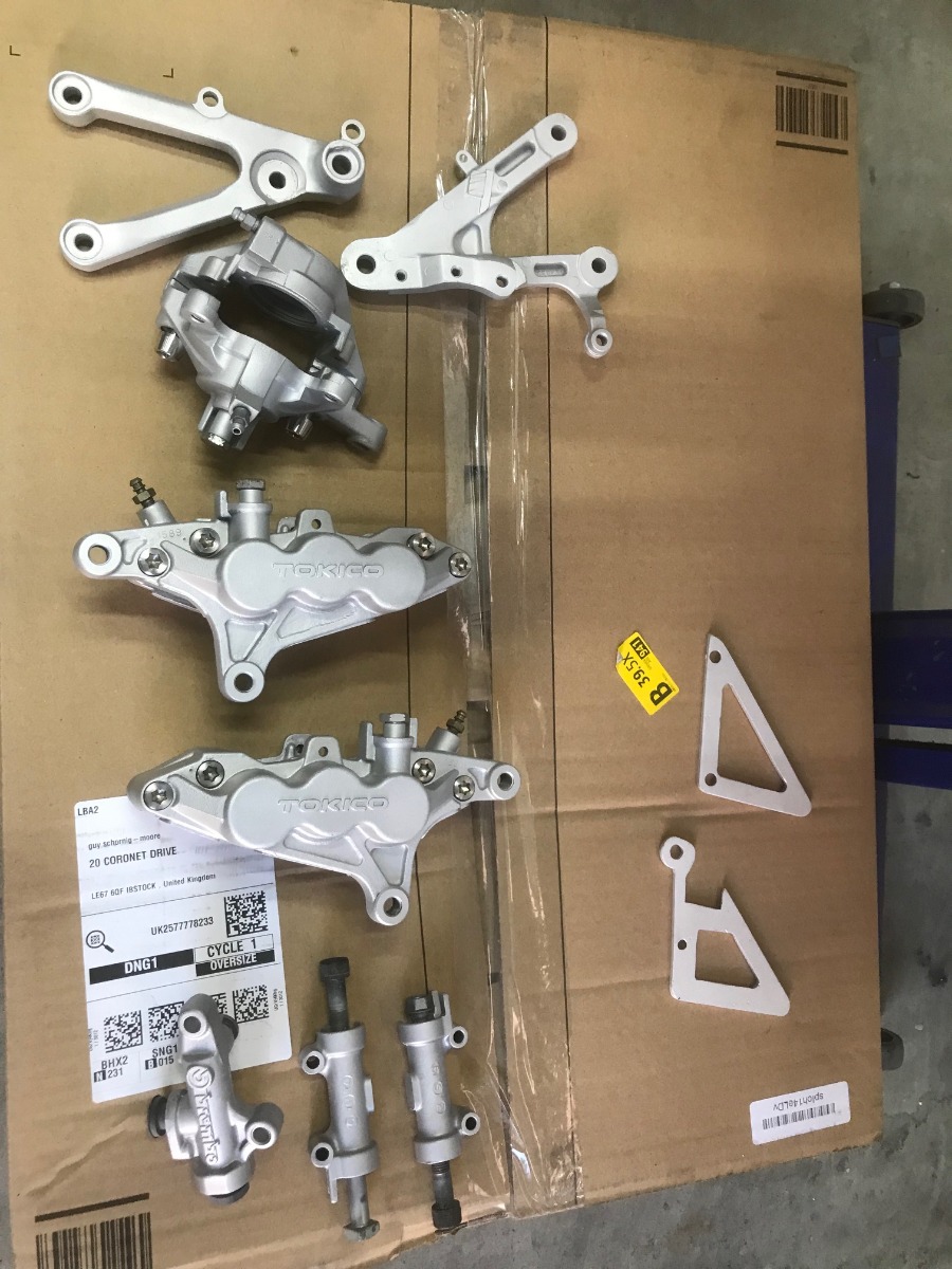

As another weekend draws to a close (holiday in the UK today) things are still moving forwards and still experimenting with new (to me) processes. I have been dabbling in the world of anodising (what a PITA
) with varying levels of success. I have now done the rear master and calliper and also the front callipers (a bit patch in places but acceptable and will "weather" I'm sure)

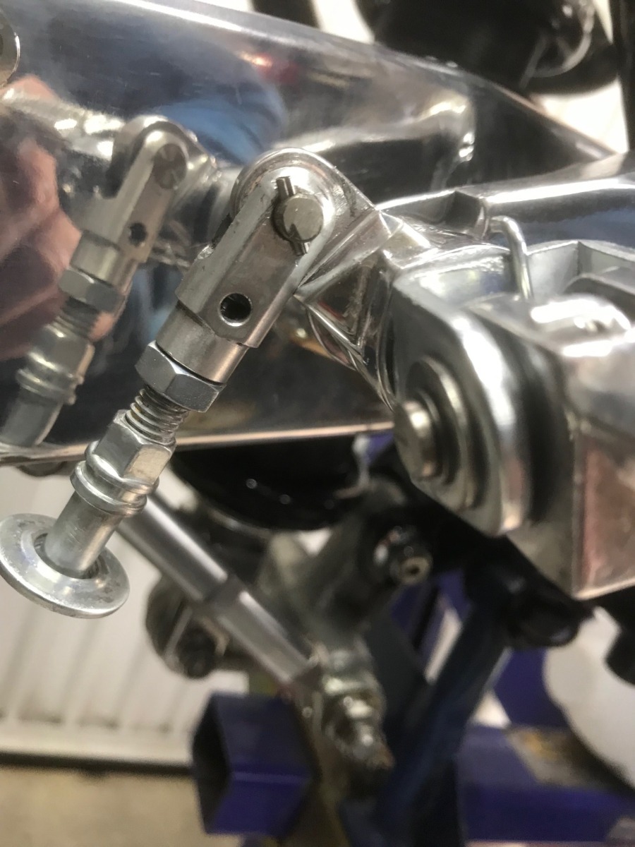

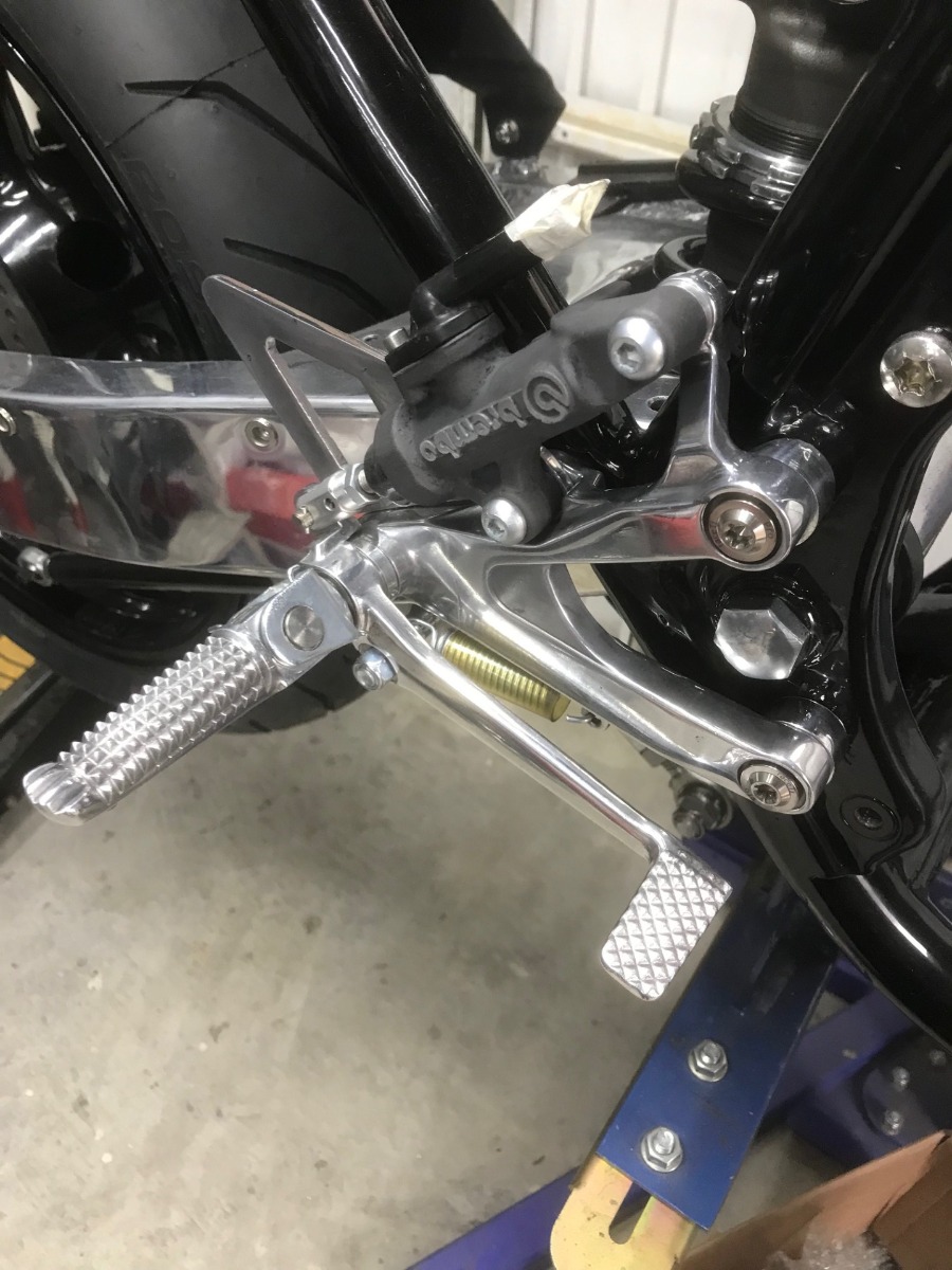

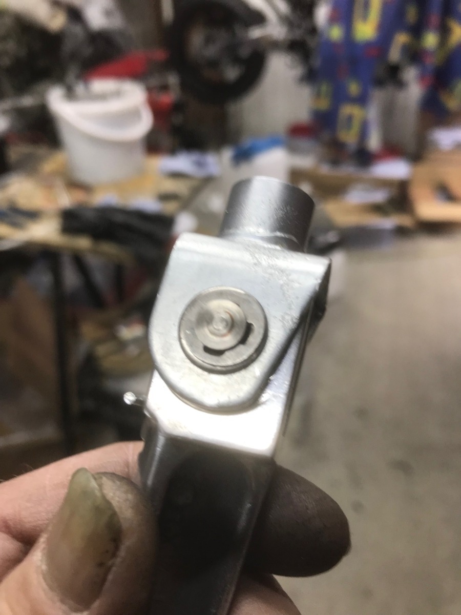

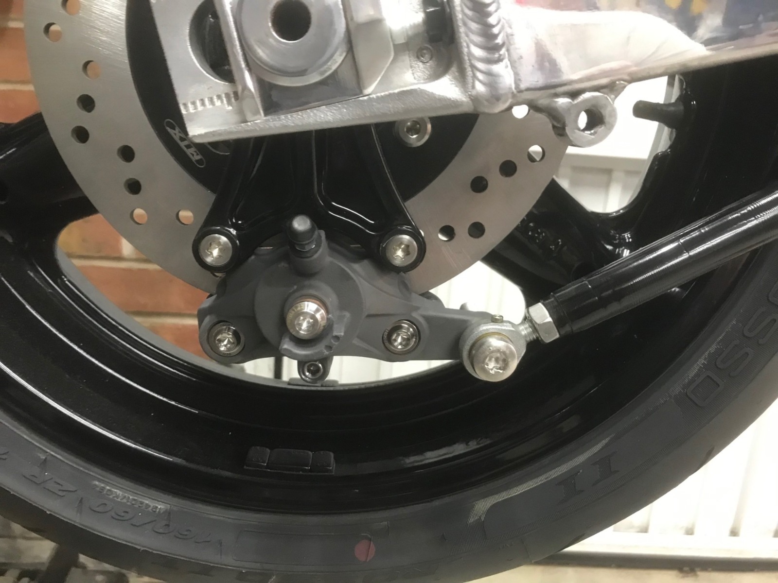

Now with the anodising done I have wrapped up the rear-sets (can't believe how many individual components make up OE rear-sets !!) I wanted to clean and replate the peg mounts and springs so this meant drilling out the riveted factory pins I have made replacements in stainless that are now secured with "E" clips. I have also made a stainless "clevis pin" to connect the rear master to the pedal, this is flush to clear the heal guard and is now secured with a stainless roll pin rather than a rusty split pin. All in all happy with the way things are going

Love what you did to your kickstand. Love the bike you have built. That kickstand absolutely would have helped me. I must have cut/welded and chromed four of them over the years trying to get it just right. Still have them. LOL.

22 Apr 2025 11:49Thanks Joe, just seemed to make sense since the ride height is adjustable and I needed to straighten out the "kink" anyway to clear the gear selectorLove what you did to your kickstand. Love the bike you have built. That kickstand absolutely would have helped me. I must have cut/welded and chromed four of them over the years trying to get it just right. Still have them. LOL.
