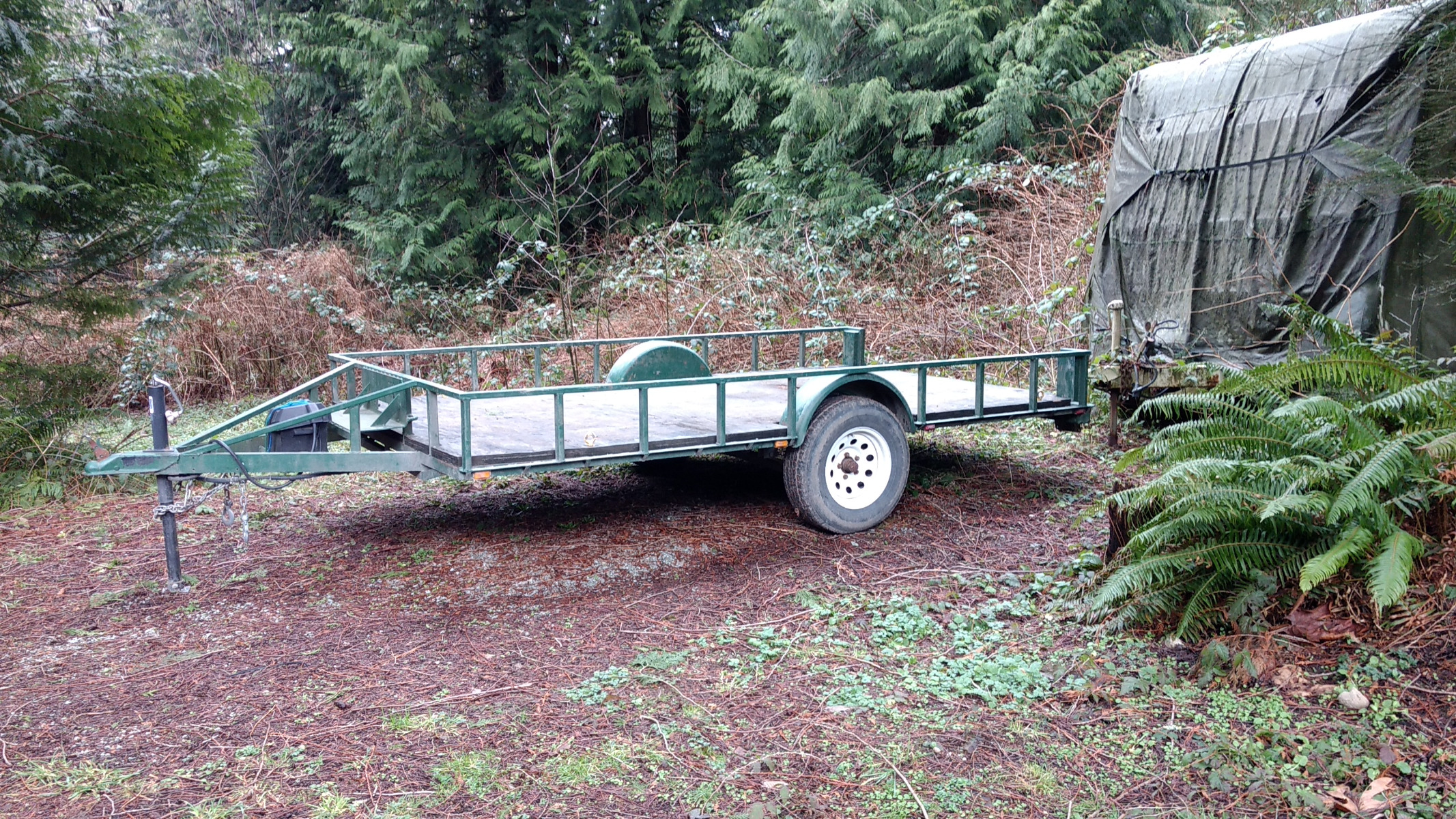

There's a difference between a cheap welder 20 years ago and a cheap welder today. My buddy and I pooled our money and bought a quality MIG welder 14 years ago and couldn't be happier. We've built a 12' flatbed trailer and a stack of other projects with great results.

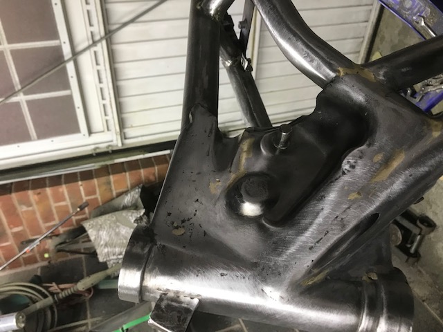

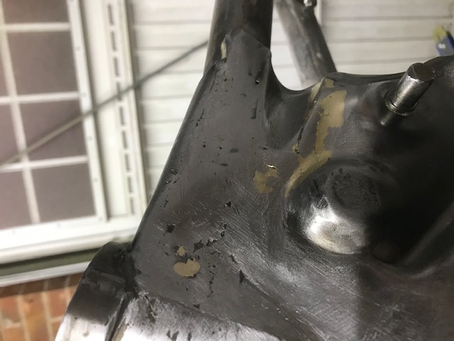

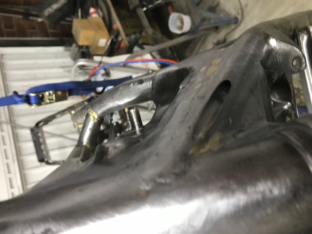

New welder is here and I'm back in business

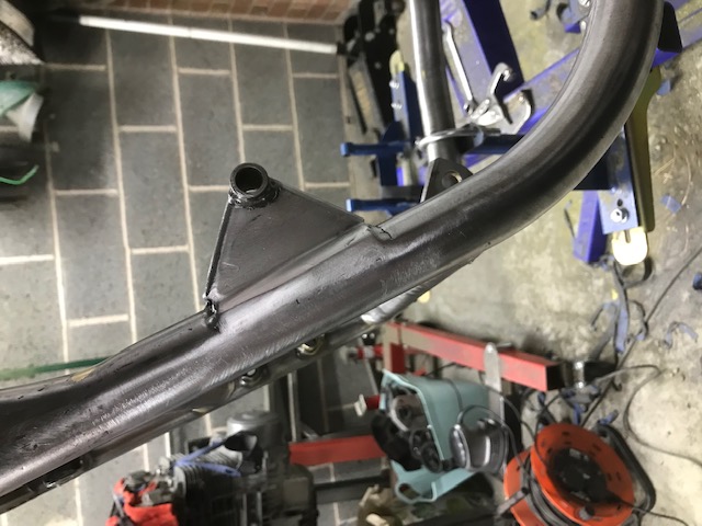

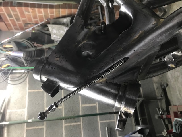

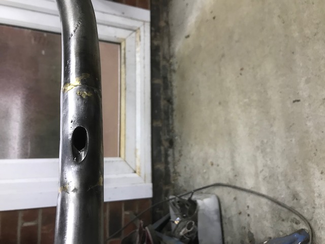

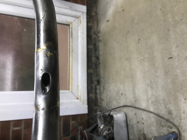

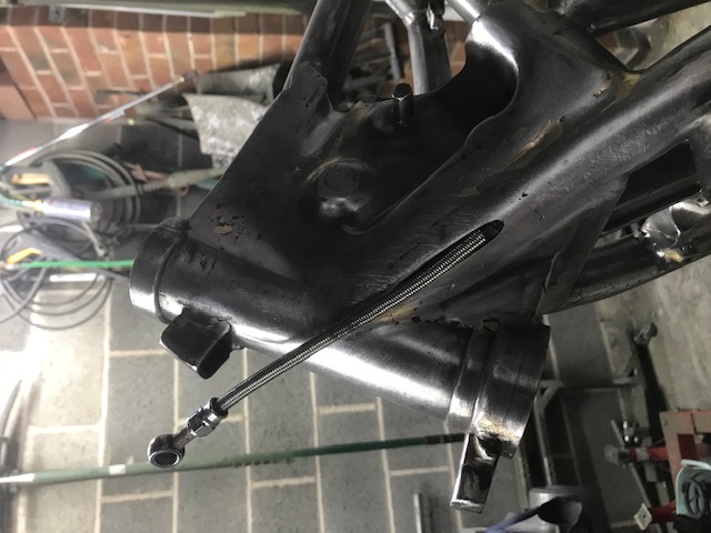

(got to say for a cheap machine it does OK) I have managed to get the other side of the headstock finished and the "fixed" front engine mount. This side was a bit trickier as not been one to do things the "easy way" I wanted to run the hydraulic line for the clutch inside the frame tube but just chopping holes in the main structure didn't seem to be the best idea I've had !!! . At the outlet point on the lower tube I have reinforced the area around the hole with a piece of thick walled tubing, for the inlet I have added a piece of "slash cut" 12mm tube to reinforce and provide a guide for the hose. I have also added a "scallop" to allow the wiring a better route to the front connector station. Still moving forward

Nice, and nice!
To my uneducated eye, the later year bikes have a much better reinforced headstock area, compared to the early 900/1000 frames. Good job cleaning up the factory welding, and building on that...

That's a clever way to hide the clutch line. Nice!

16 Dec 2024 00:03Thanks Ed, those brace pressings are certainly significant (2mm plate) and I think along with the additional tubing I have installed should allow me to "reap the benefit" of the improved suspension. I would say to anyone thinking of going this route with smoothing their frame that the key is to ensure you "add" enough material to be able to grind it back without "compromising the original structure".Nice, and nice!

16 Dec 2024 00:13Thanks Scotty, it's a "double bubble" as cosmetically it's cleaner but also keeps the line away from the heat of the header pipesThat's a clever way to hide the clutch line. Nice!

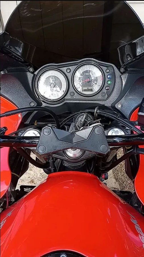

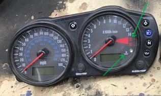

16 Dec 2024 17:09 - 17 Dec 2024 00:25Amazing work your doing on this bike Wookie!On another note, while looking around I noticed that the ZR750S (watercooled model) uses a very similar instrument cluster to the ZX6R that I had already (there are some small differences) I had a set turn up in the post as there are a few advantages (more realistic redline - fuel gauge) and they are cosmetically different. Side by side I am unsure but am angling towards the ZR unit - What do you guys think (ZX6R on the left)??
I wish I could Weld.
The Gauge clusters look very much like the 2005 z750s I have.

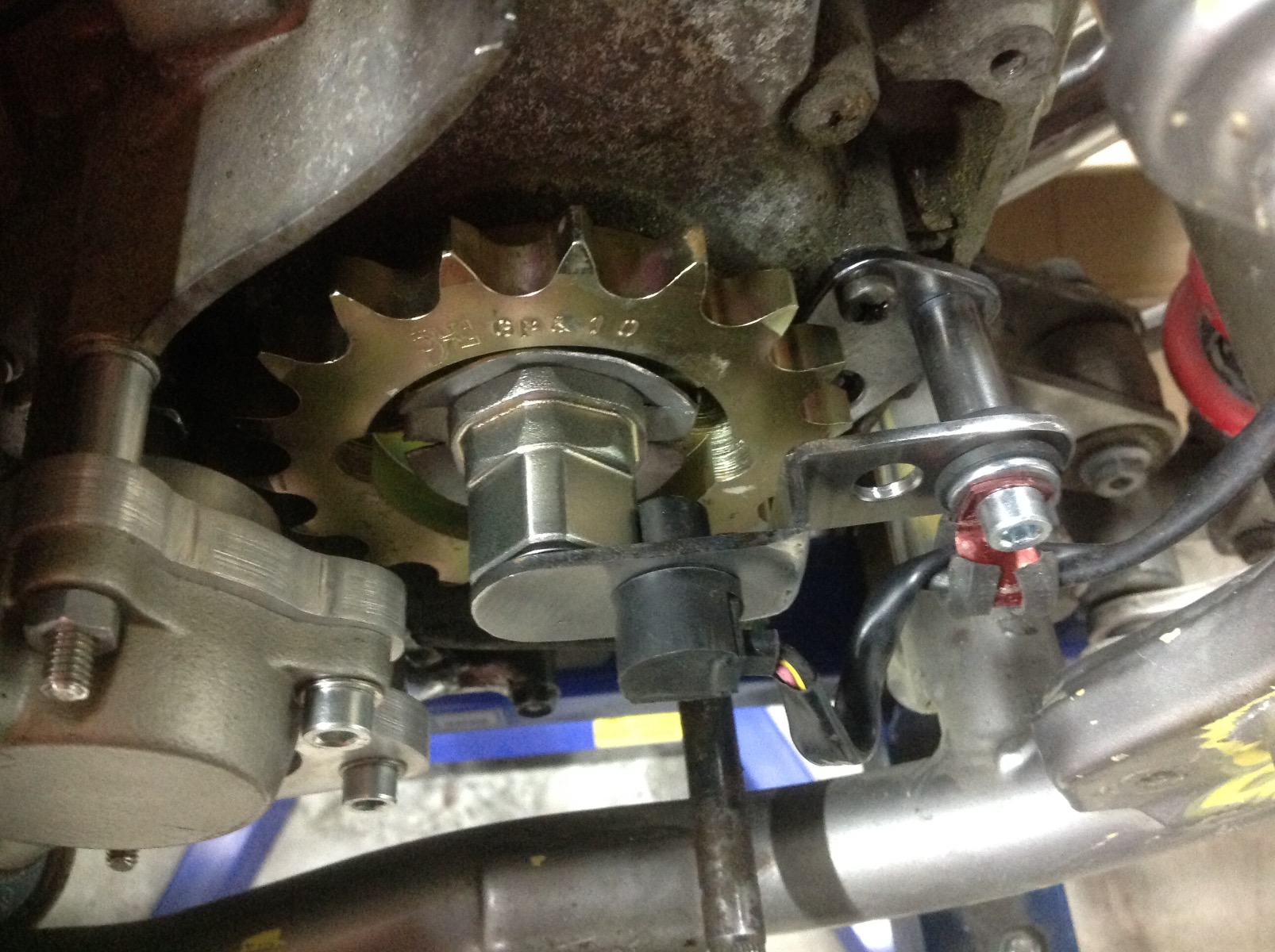

It's pick up is on the front sprocket.
Rob

17 Dec 2024 00:27It is indeed, this was a bit of a PITAIt's pick up is on the front sprocket.The Gauge clusters look very much like the 2005 z750s I have.

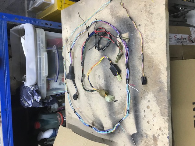

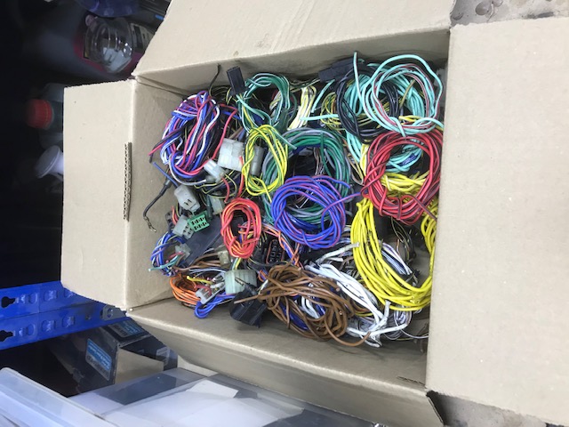

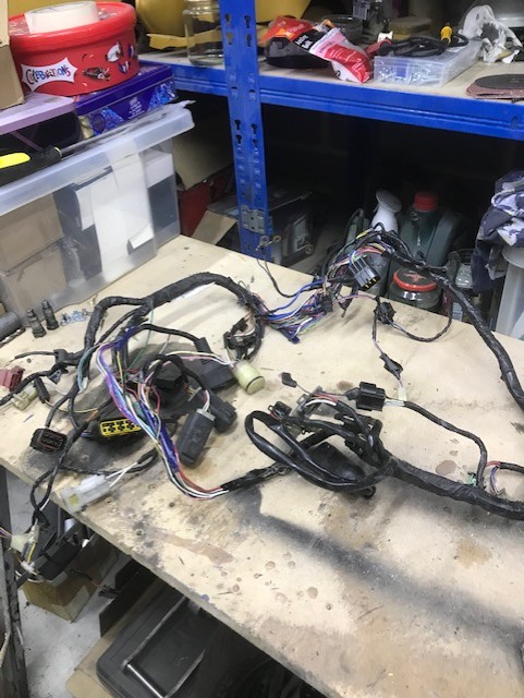

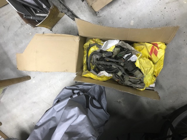

So now the holiday's over I have been back at it today, I decided that I should break the neighbours back in gently so the welding and grinding can wait until tomorrow. I will be making my own loom using DTM style connectors but I still needed factory plugs for the instruments, ignition module/pulse-coils and speed sensor. I picked up a ZX9R loom a while back that had been butchered so was dirt cheap (I only needed the 16 pin plug for the instruments and the 3 pin for the speed sensor) I am using a GPZ1100A2 ignition system but fortunately several other kawas of that era use the same type igniter so have the same plug (I bought a GPX600 loom for $20 as it doesn't carry the "classic" premium of a GPZ part but is the same 10 pin plug). Having stripped both looms today I have harvested the required parts and have enough cable of the correct colours that I shouldn't need to buy much in the way of cable to build the full loom, a good day

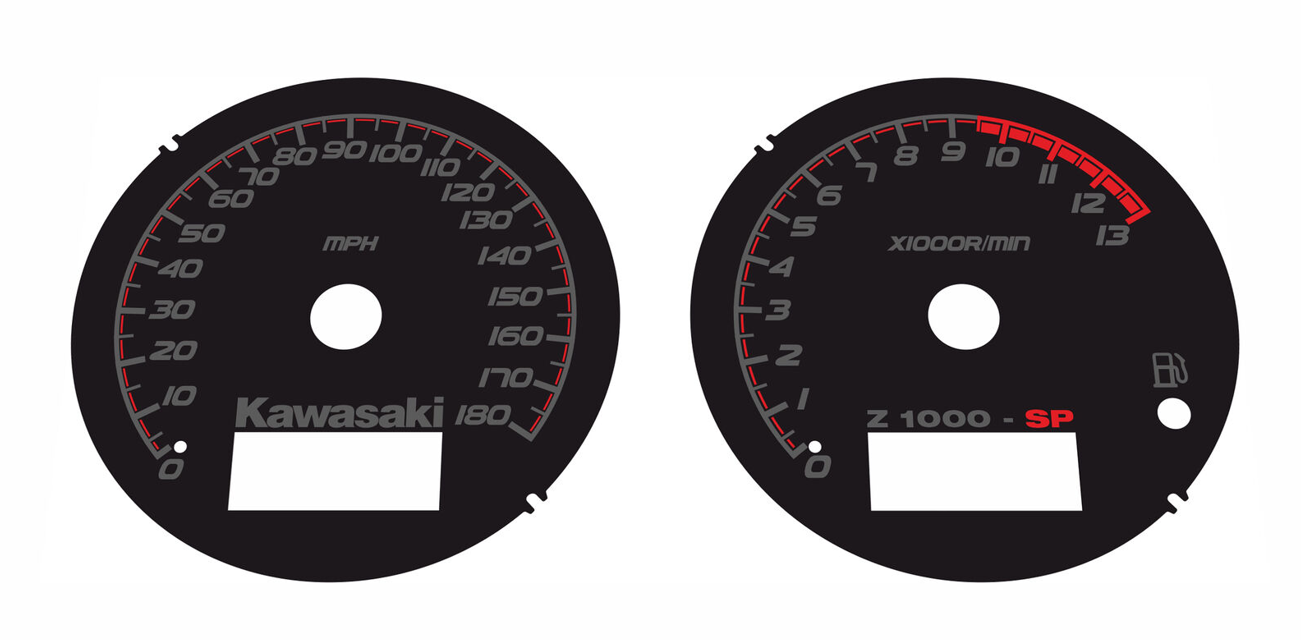

Today has been a good day just a couple more days and the frame will be PC ready (I won't bore you with any more frame pics !) but also I have been thinking about my instruments. I am using ZX6R but there are a couple of issues, first it has a "temp" warning and obviously my bike is air cooled - 2nd is the 15k red line on the tacho. Just before Christmas I reached out to a company in Poland who make replacement faces to see if they would do a "one off" custom set. I sent them a drawing of what I wanted and got a response the next day saying "no problem" and that they would send me a preview after the holiday. Well today I got the preview and I am "stoked" - why can't other suppliers have this "can do" attitude, they are only charging $8 more than their off the shelf offering which is awesome. They have said 8-10 day turn around so I will post pics when they arrive and let you know about the finish etc (I have shared the "preview" below )
