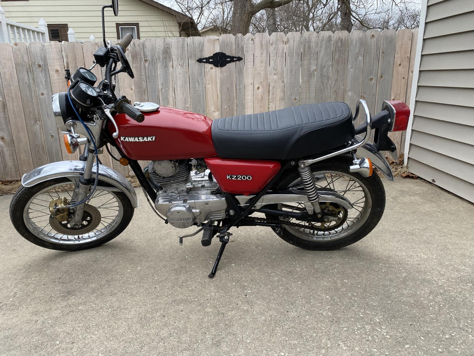

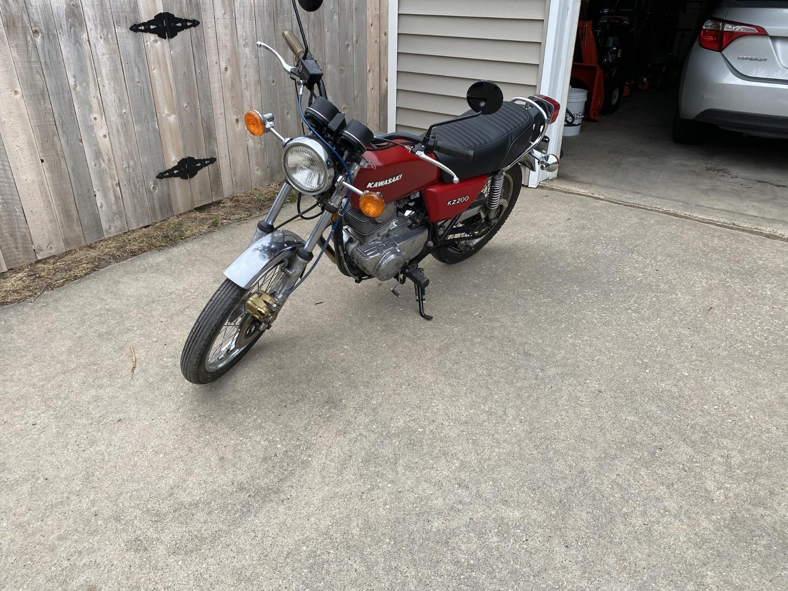

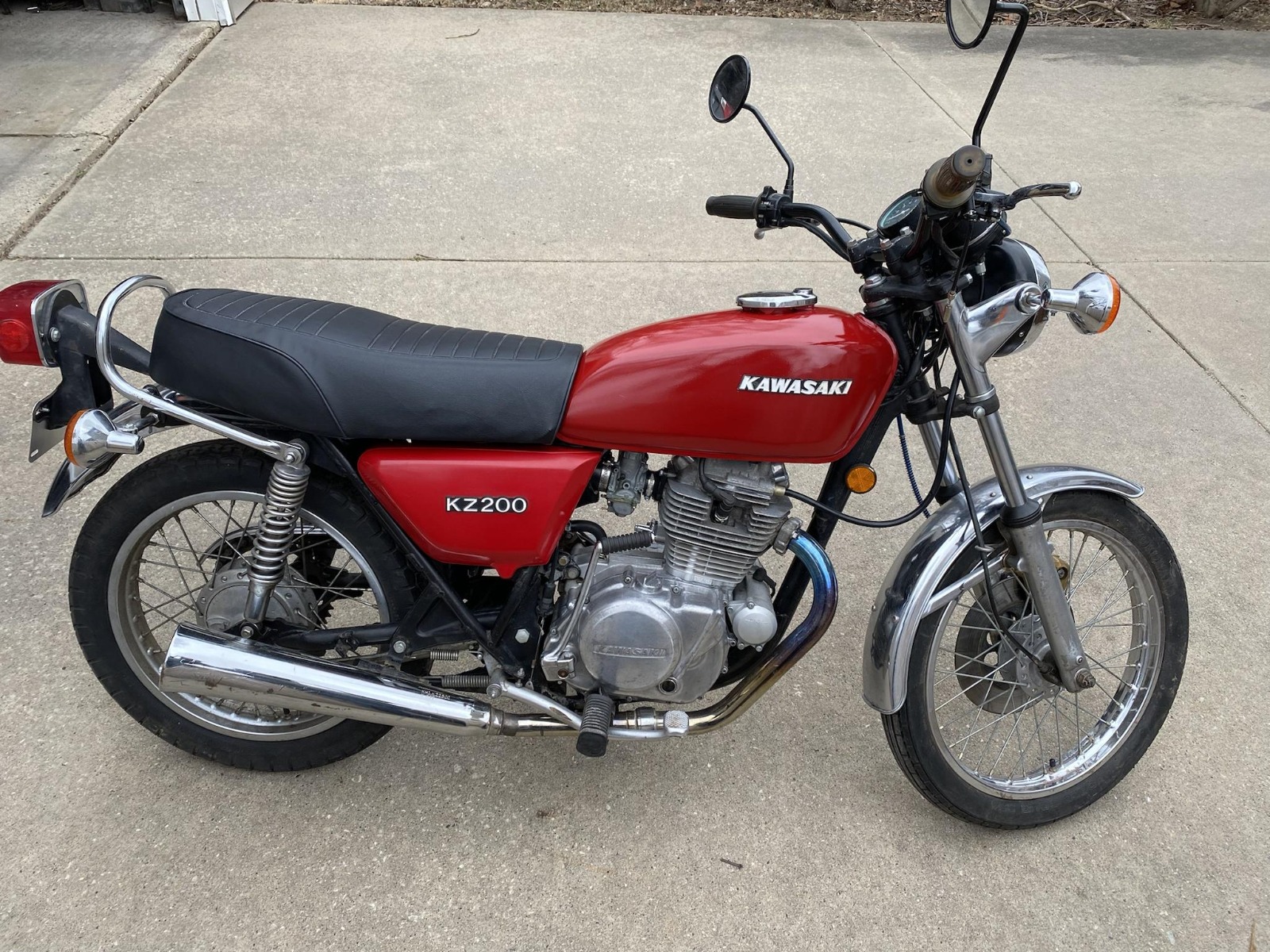

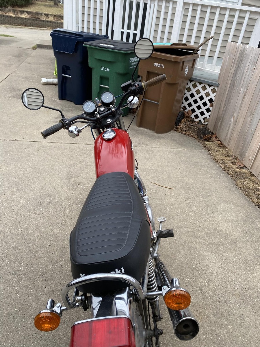

No one really cares about the little singles, but figured I would share my long term basket case KZ200 project here. Goal was to keep its looks as stock as possible.

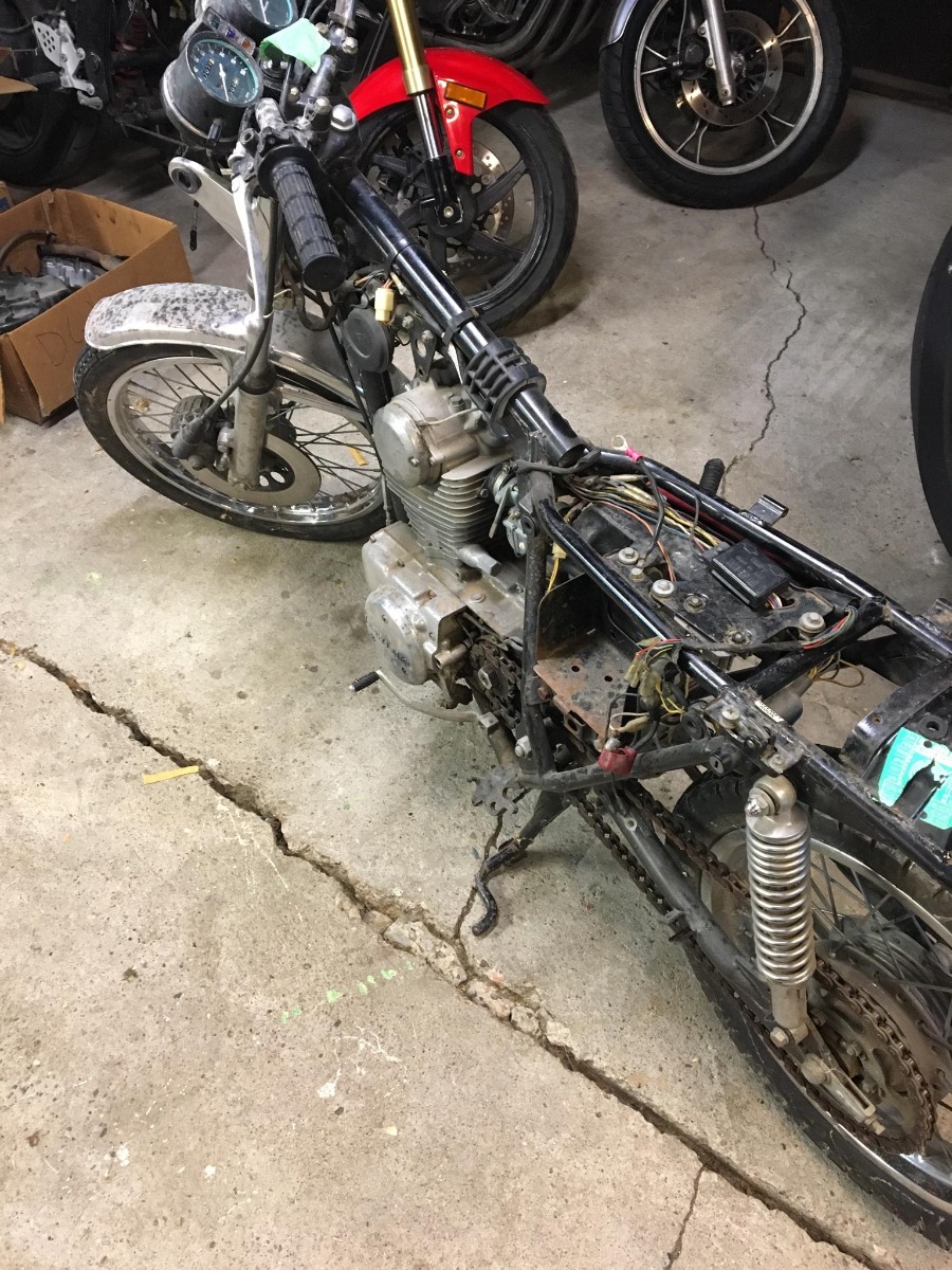

I had engine issues with the original engine where some previous owner has used ATV instead of a real gasket, that got into and blocked the oil filter/oil pump, which trashed the cam bearing surfaces in the head when they ran it starved of oil. Took the opportunity to turn it into a 250cc using 81 KZ250LTD top end parts + crankshaft. Changed the carb to a Mikuni VM26 since the OEM carb was way too lean and I couldnt get it tuned for the larger displacement (intake size was very very small). Original was missing airbox anyway so it has a UNI foamie pod filter on it. Whole bike has been rewired because electrical was a nightmare. Still has original handlebar switches, snagged some period correct "coke bottle" grips, and new mirrors. Swapped over a KZ650 hydraulic front brake (bolted right on, works with the original brake rotor). Fixed the numerous dents in the tank and painted with "color matched" paint, which was not color matched at all, so I'll be painting side covers to match at some point. Had a hideous seat cover on it so I replaced that with a Pitreplica pressed vinyl one that looks the part. On the whole I think its a pretty cool survivor bike, that's pretty fun to ride around town.
