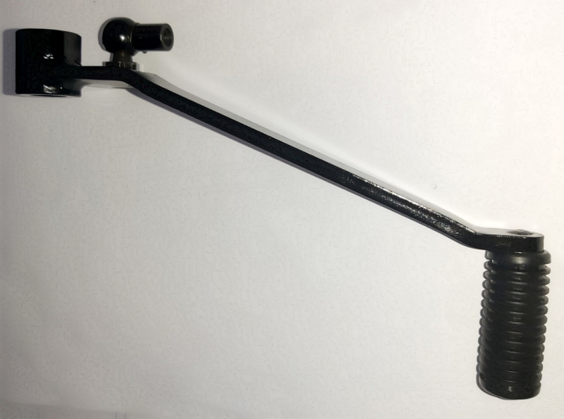

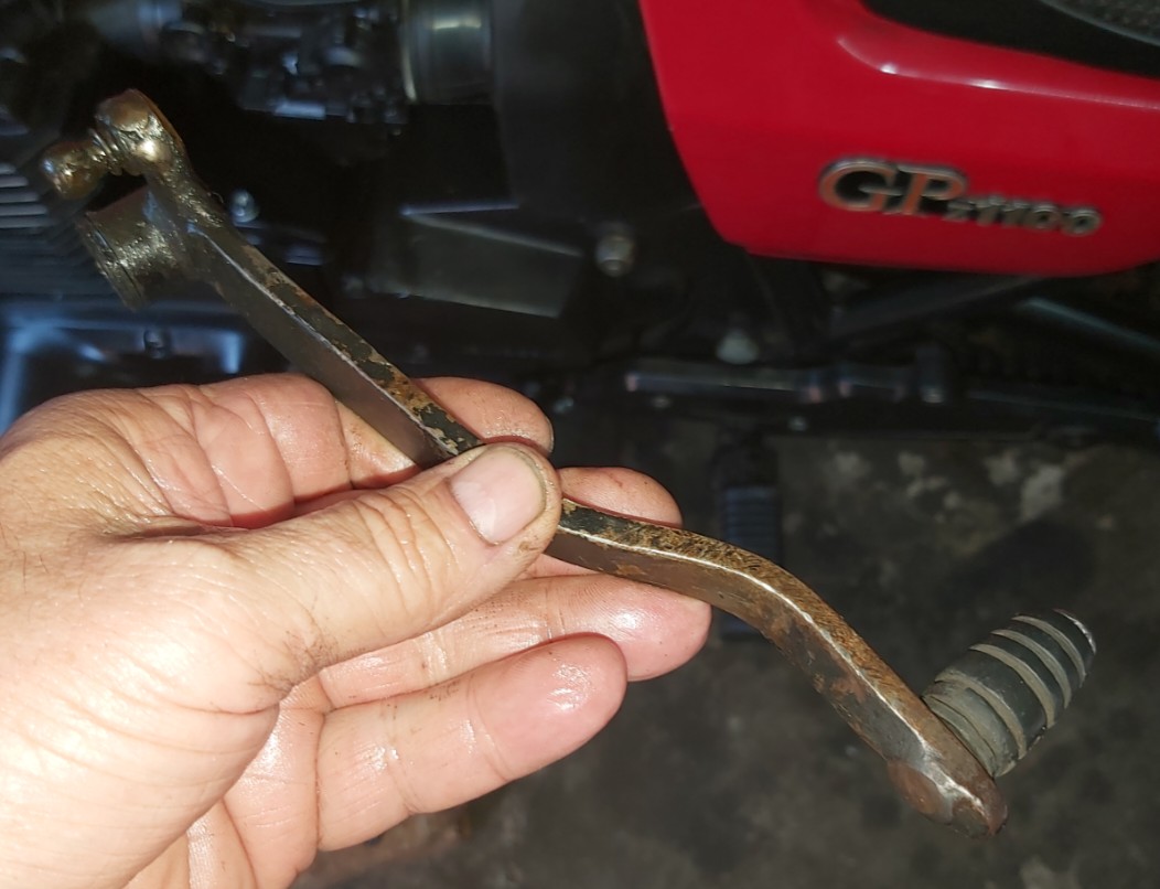

The previous owner had fit a hideous gear lever, of unknown origin. The linkage ball joints and also the pivot bush were badly worn, exhibiting a LOT of "slop"...
Horrible!
I saw a few NOS levers advertised on Ebay, for ridiculous money... Not gonna happen!

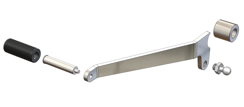

However, I was able to use the advertising pictures to design a replica:
Having access to a laser cutter at work, and a lathe at home made this a breeze!

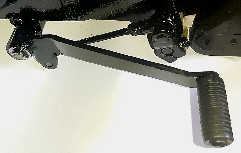

The ball joint was salvaged from a gas strut, having an M8 external thread on the ball, and an M6 internal thread in the "socket". Screwed right onto the existing linkage!
"I was well pleased with that", quoting Allen Millyard once again.

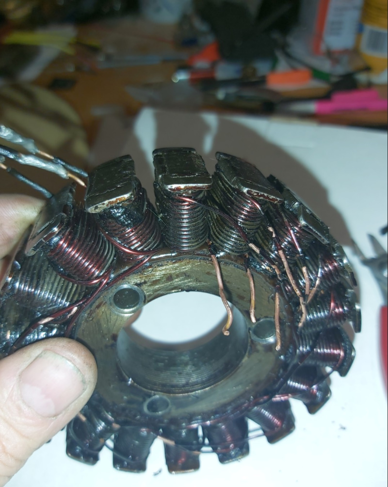

Upon opening the cover, I immediately saw the cause:
The stator winding insulation was "blackened" and "crumbled" to bits while I was removing it.
I could not find a suitable replacement stator at any of my local spares outlets.
Ebay to the rescue: so I pulled the trigger on a repro. unit, including a voltage regulator and a complete ignition pick-up for $75, half what I was quoted to have it re-wound!
But, delivery is 6-8 weeks away. Uhggg!

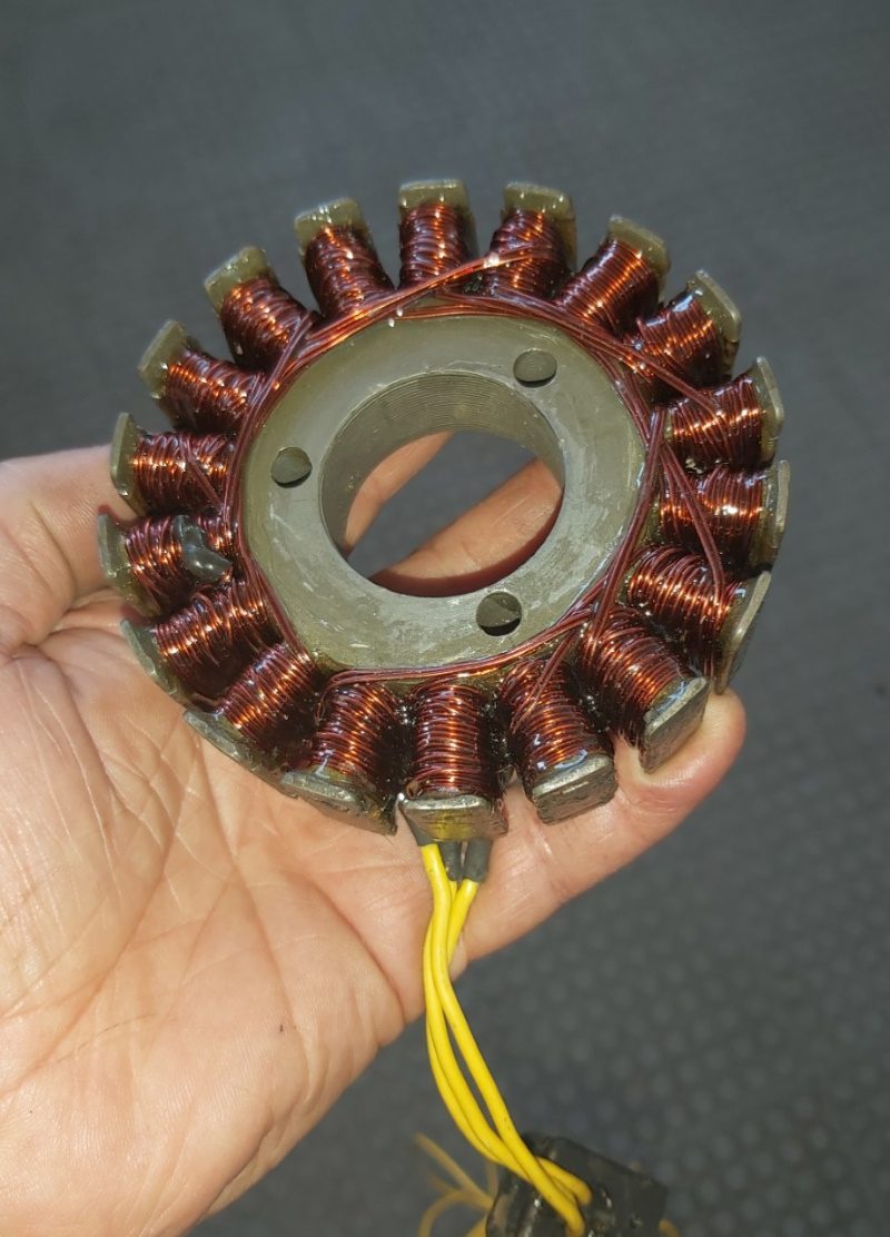

I thought "while waiting delivery, why not try rewinding it myself?"
I had some enameled copper wire on hand.
I carefully counted the number of turns while "disassembling" the toasted unit:
3 phases, with 6 segments per phase, 26 turns on each segment, liberally coated in epoxy resin.
Here is the result of an evenings work:
I installed it in the cover.
I fit the replacement rotor, and after making a new gasket, I buttoned it up...
It works! (to my surprise) the regulator now delivers 13.8v at 4000. Sweet, I can ride again!

Rewiring the stator is brilliant. I’ve never hear of anyone not a pro doing it.
You paralleled the wire because of smaller gauge?

30 Jan 2023 16:51Rewiring the stator is brilliant. I’ve never hear of anyone not a pro doing it.
Yes, the original wire dia. is 0.9mm and the wire I had was 0.7mm

30 Jan 2023 19:12Rewiring the stator is brilliant. I’ve never hear of anyone not a pro doing it.
___>>> Your rewound one will run a little cooler then. You might be on to something.
