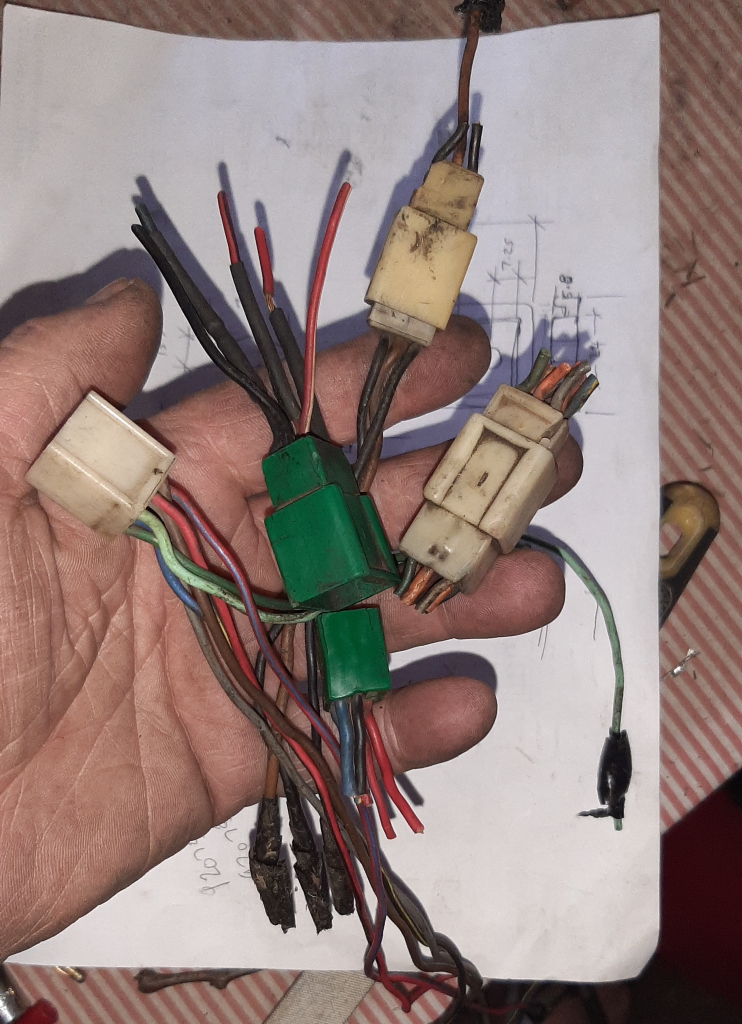

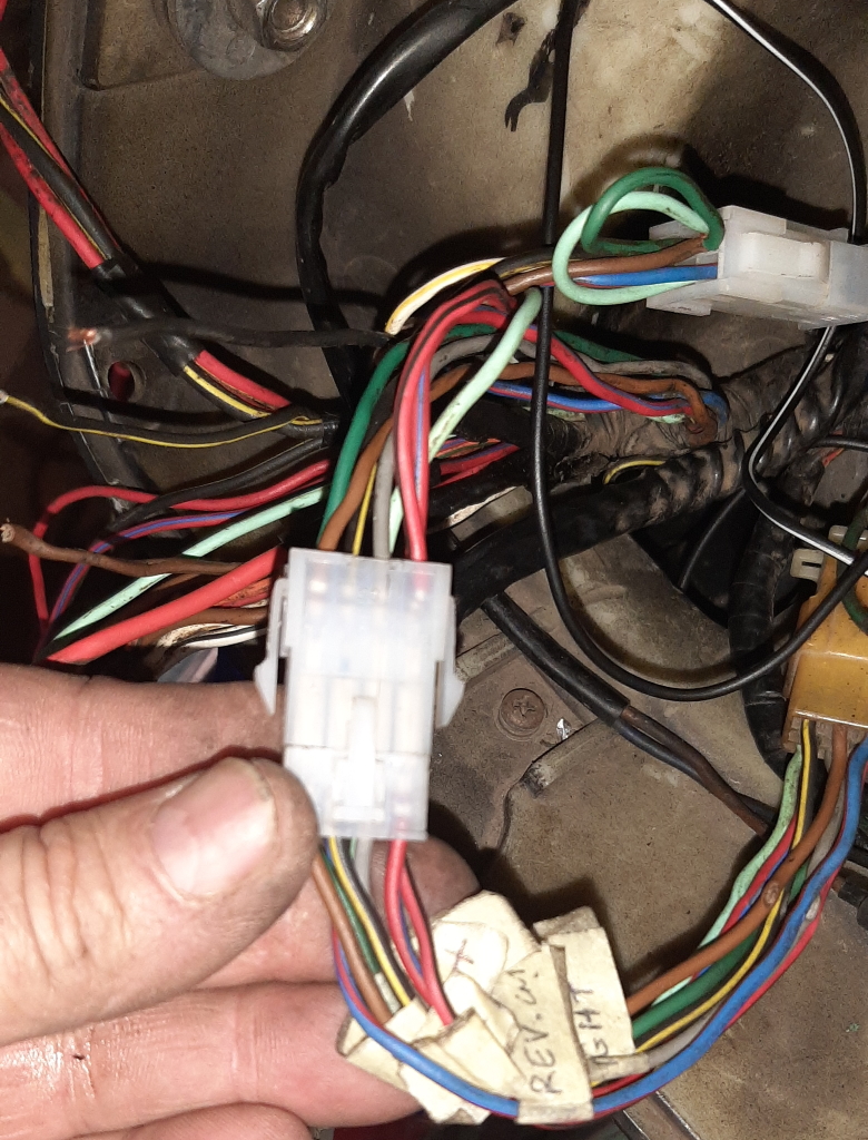

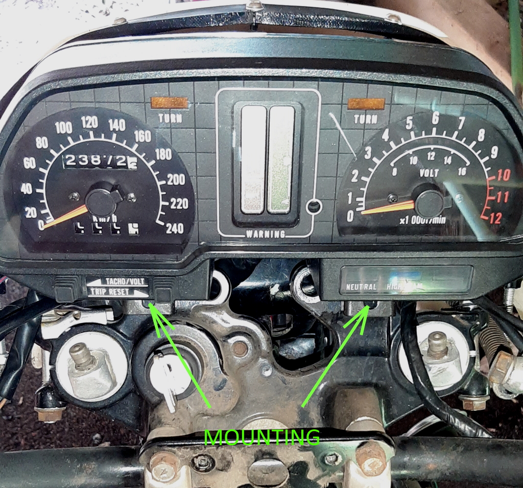

Most of the wiring had been seriously butchered, and almost all of the connectors were badly damaged,
some broken completely. The 9 pin main connector fell to pieces when I unplugged it!
I found suitable, but not replica, connectors on Ebay (are "replica" connectors even available?) and replaced them one by one...
I had to replace the un-serviceable GPz1100 B1 instrument cluster with an "almost new" unit from
a B2, so, some wiring adaptation / modification was required.
This modification to the wiring was effected INSIDE the head-light bucket, using the new connectors.
One thing that intrigued me is that the oil pressure switch signal...
The oil pressure switch on the B1 "opens" when oil pressure is present, but the instrument cluster
required the opposite signal condition!
So I had to "invert" the signal, using a 12 volt relay, neatly hidden inside the head-light.

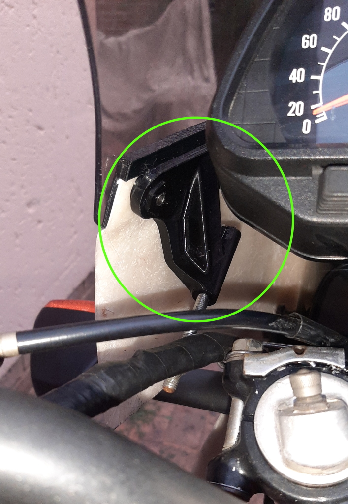

As you know, mounting hardware for the bikini fairing is no longer available, so I set about designing the brackets
that would be suitable for 3D printing. Obviously the parts had to be "thickened" in certain areas, owing to the
material properties of the plastic. I also added some "strengthening" gussets and "features" to ensure sufficient strength.
Once that was done, I could figure out the correct mounting position for the B2 instrument cluster, which has to fit "inside" the fairing,
while at the same time be suitably spaced from the screen.
This turned out to be quite simple. I simply drilled and tapped metric 6mm mounting holes in the top triple-clamp.
I also 3D printed some vibration isolation pads that did the job nicely.

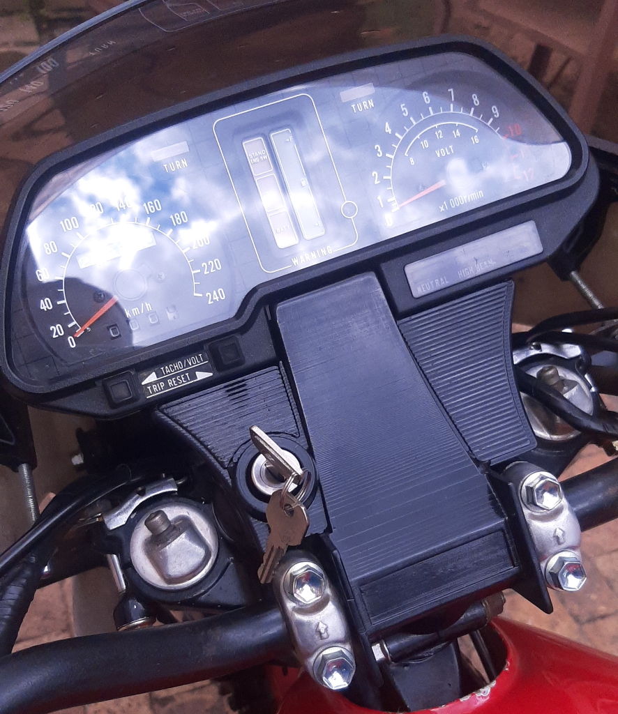

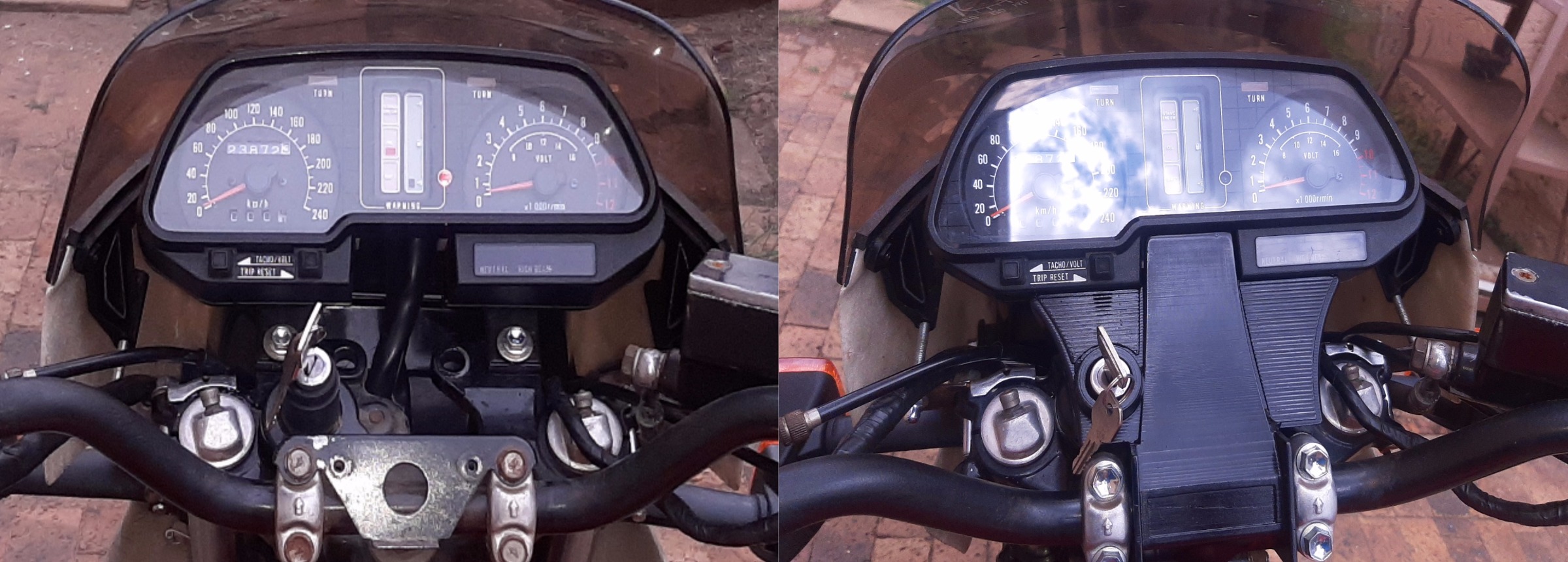

Next was to try to replicate the "cover" that hides the instrument cluster mountings and the ignition switch body.
The idea was to have the cover look like the Eddie Lawson / 1100R instruments, as far as possible.
However, the B1 ignition switch is offset to the left (what were they thinking!) so I had to incorporate this "offset" into my design.
Using some pictures of the 1100R cover (and a very good photo from member hx35w ) , I 3D modled a cover to suit...
Then, onto my 3D printer... 26 hours of printing later...
I am quite happy with the result.
Before / After
I think the result is usable!
Before / After
