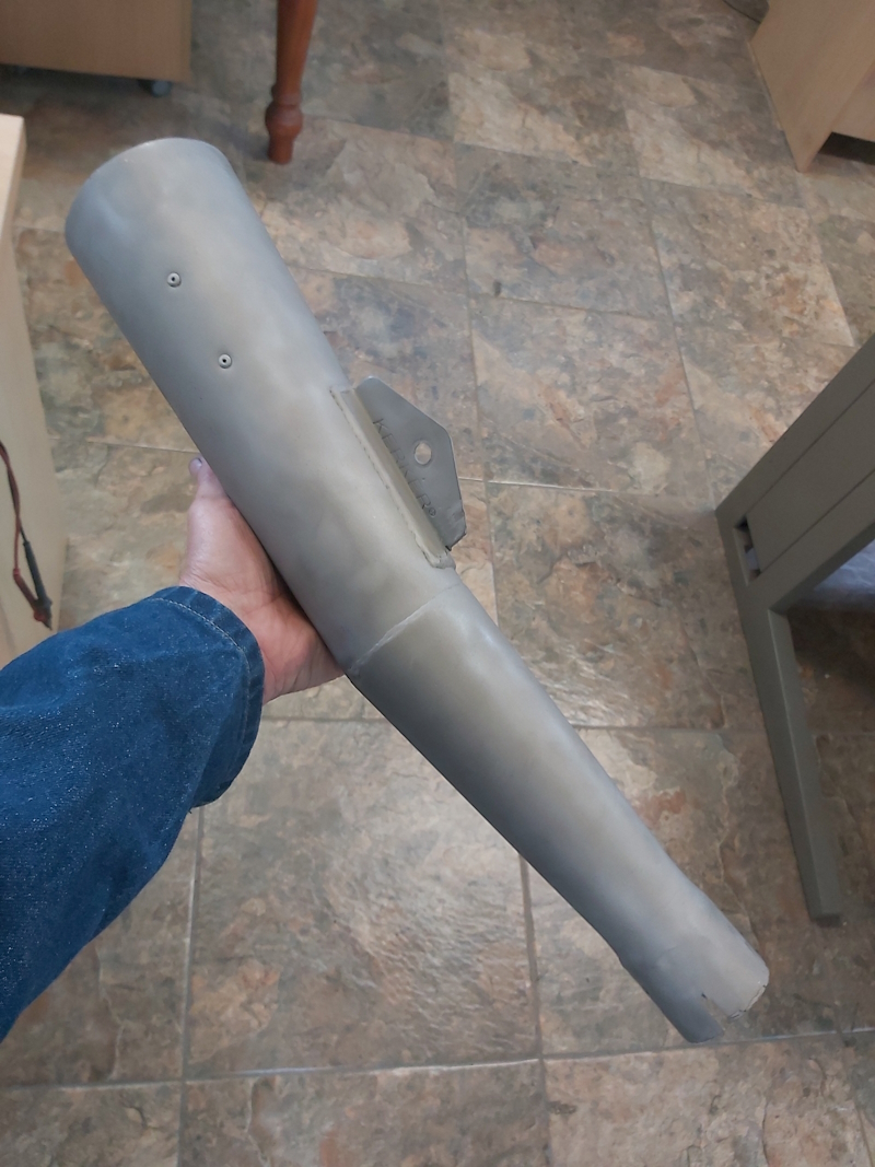

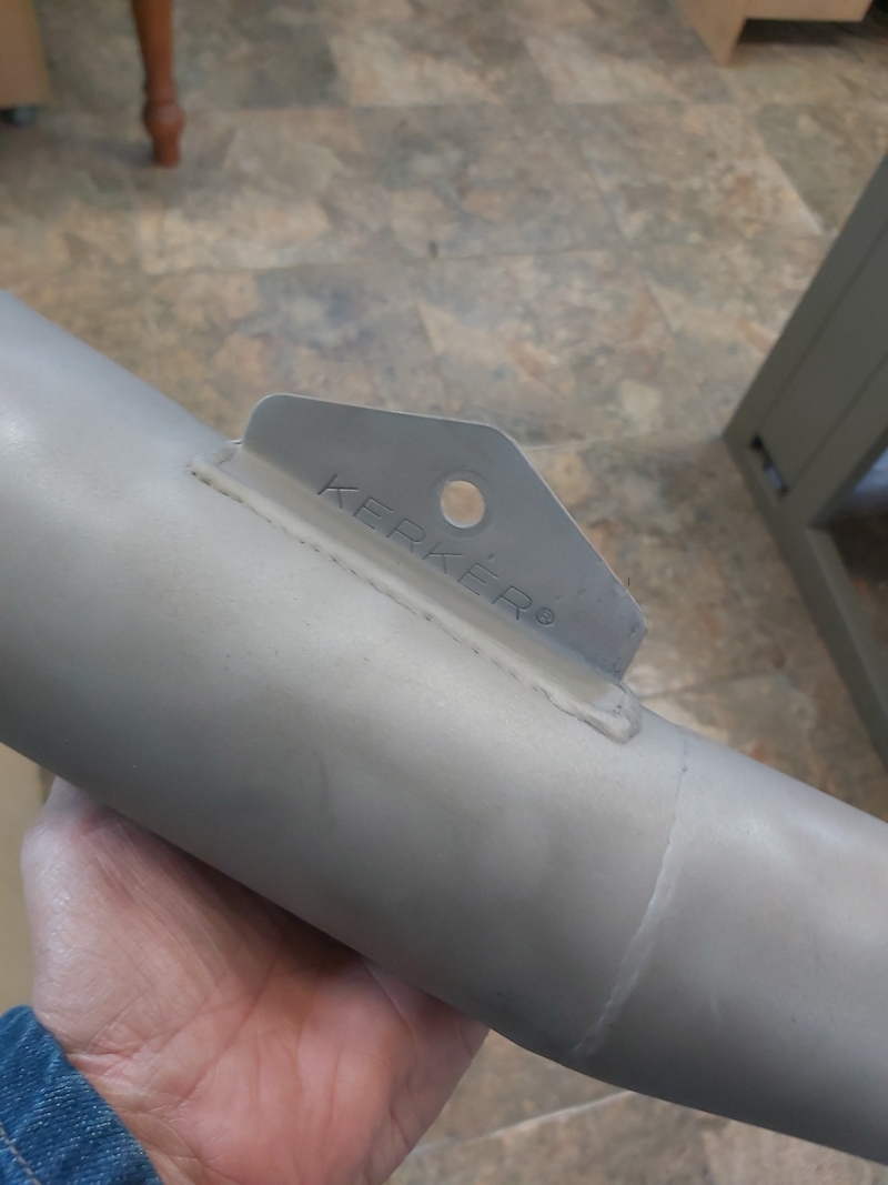

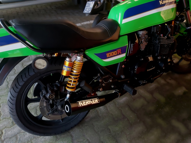

Finally, I've finished the Kerker pipe....
I sand-blasted the chromed outer surface, to ensure good paint adhesion...
To be sure, it is a REAL Kerker...
I had to fabricate a new baffle pipe, to fit inside the end-cap (I had to modify it, to correct the damage that the PO had inflicted on it)
32mm OD, mild steel pipe.
I made 680 drill centre marks, but drilled 520, 4mm holes
I have spray-painted the end-cap and pipe, with Rustoleum Ultra High Heat, satin black paint.
Afterward, I riveted on my "home made" Kerker emblem.
(had to fabricate a new hanger bracket too...)
Installed, it looks the part, and sounds sweeeeet!
H.

No such luck Wookie!
I used my lathe to mark out 17 rows and 40 coulmns, then centre-punched 680 drill centre marks ! ! !
However, I ommitted to drill a few rows in the middle area of the tube, thinking it would assist in getting the airflow to go IN at the entrance and OUT at the exit...
The sound is fairly quiet, deep and "throaty" below 5000 rpm...
After 5000 the note changes to a convincing ROAR !
H.

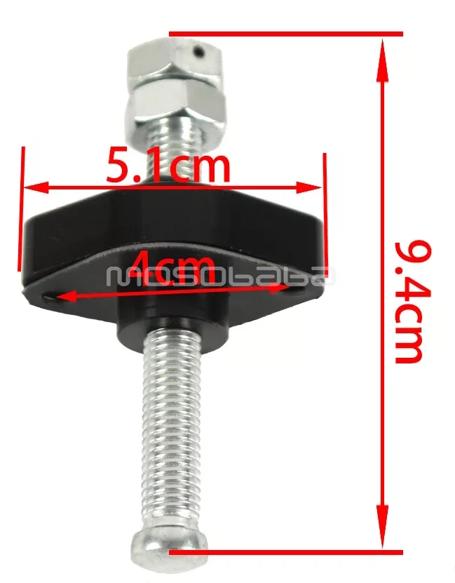

After 10000+ miles of utterly enjoyable, trouble free ridin' since I rebuilt the top end, I started to notice some cam-chain "noise"... ever so slight, but undeniable.
After removing and inspecting the stock tensioner, I discovered that it had seized solid, with about 3⅛" extension stroke still available.
Hmmm...
I decided to fit a CNC machined, manual tensioner, that I sourced on Ebay.
Installation was straight forward, the unit being supplied with fasteners, a gasket and o-ring.
I checked valve clearances and all are still in spec, likely because I never rev her past 6000 rpm.
(No need to reset the new manual tensioner either)
Marvellous !
She's purring beautifully again.
This is the tensioner that I bought:.
Also, I fit an LED headlight bulb... the difference is literally day and night, especially the clearly evident low and high beam light patterns. Love it!
H.

I plan to go “manual” also - not least because space will be tight with my planned cooler set up
