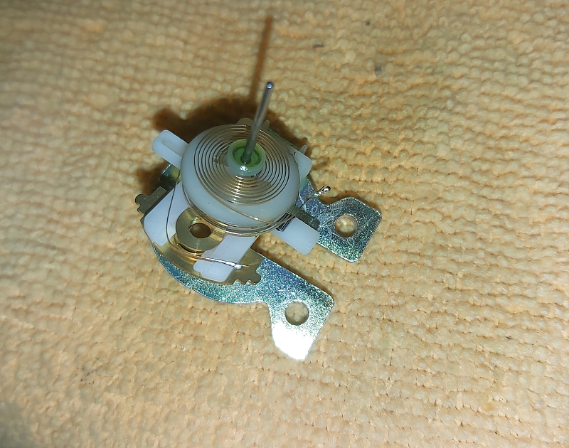

With nothing to loose, after donning my +3.50 reading glasses, I carefully disassembled the mechanism to see if repair was possible.
Here is the movement, with needle and faceplate removed:
This picture shows the next step in disassembly...
And here is the movement, un-soldered from the terminal circuit board...
The coil is so small !
One end of the coils wiring must have broken / fatigued off its terminal, which connects to the copper spiral return spring.
Murhpy, being ever present, dictated that the wire end that is buried UNDER the windings was the one at fault...
In order to gain acces to that end of the wire, I had no choice but to unwind that tiny little coil
I unwound just over 9 metres of wire, thinner than my own hair (and that's saying A LOT !)
I then rewound it, very slowly and delicately, ensuring I had left enough wire protruding in order to solder it back to the tiny little spiral spring.

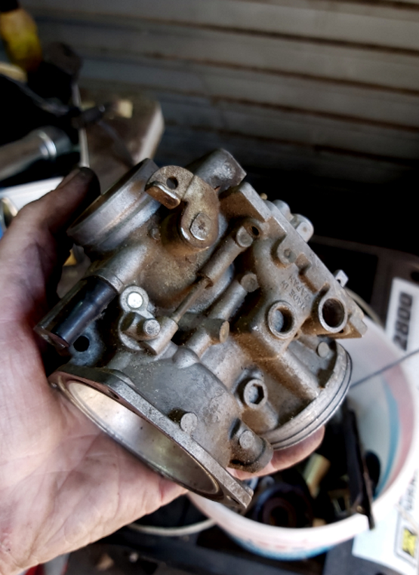

The Mikuni BS34 carbs that were on the bike when I got it were not in great shape.
Although they worked fine, some external corrosion and pitting made them look tatty,
even after I had re-painted the diaphagm covers and float bowls.
Also, carb #2 seems to have been swopped in from a different set, and "looks" a little different
from the other 3.
I was fortunate to come across a set, in ok shape, for 100 bucks. Bargain!
The add said they were form a KZ1000 CSR.
This is what they looked like in the advertisement on my local FB Marketplace,
with the remanant of a pod filter on carb #3

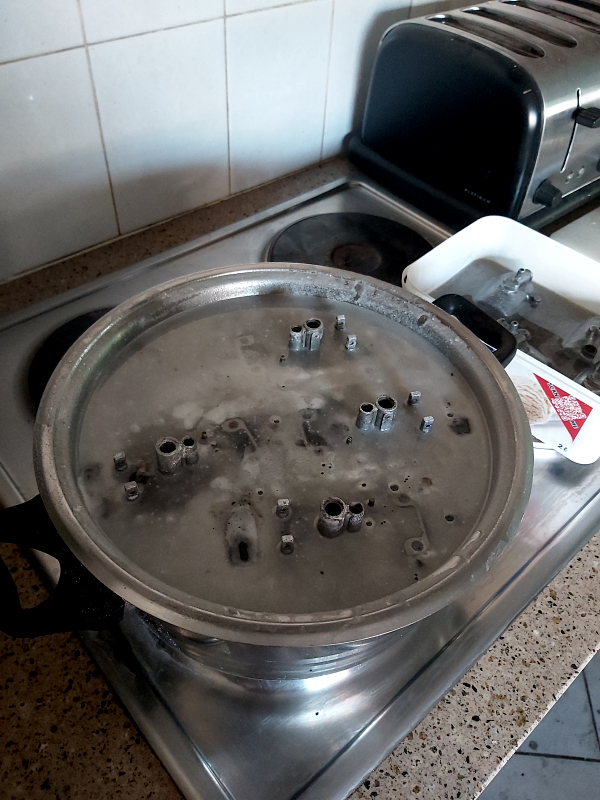

My chosen method for deep cleaning is to boil the parts in a STRONG solution of clothes washing powder.
5 cups of powder in 5 quarts of water. In this concentration it is pretty caustic stuff !
10 minutes on the stove, stirring regularly...
(I learned this method years ago, restoring vintage model aircraft engines that had years of varnished caster oil and crud on them)
After thoroughly rinsing in fresh cold water the parts look almost new...

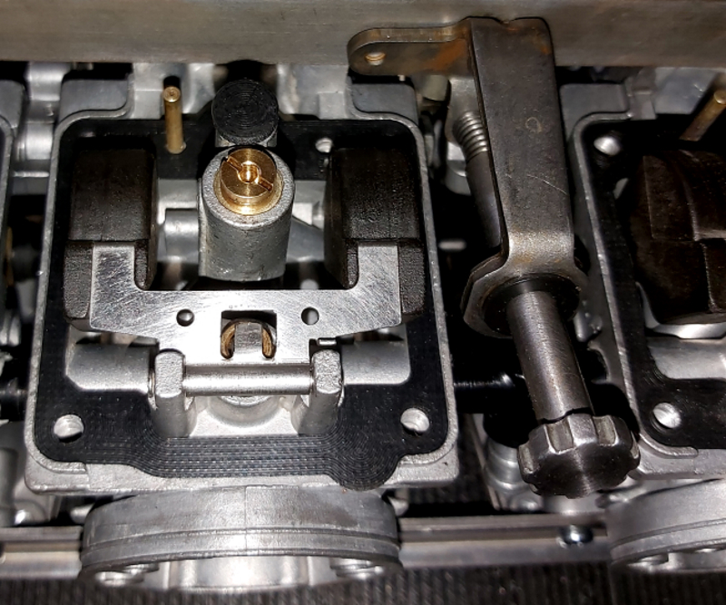

I 3D printed the seals on the choke plunger tips, as well as the outer "dust" seals for the choke plunger shafts, and the pilot jet plugs.
I realise that the original outer dust seals were "belows" type, but I could not print that shape, so I designed
them to "slide" on the outside for the plunger shaft. (I see many other Mikuni carbs that use this type of sliding seal)

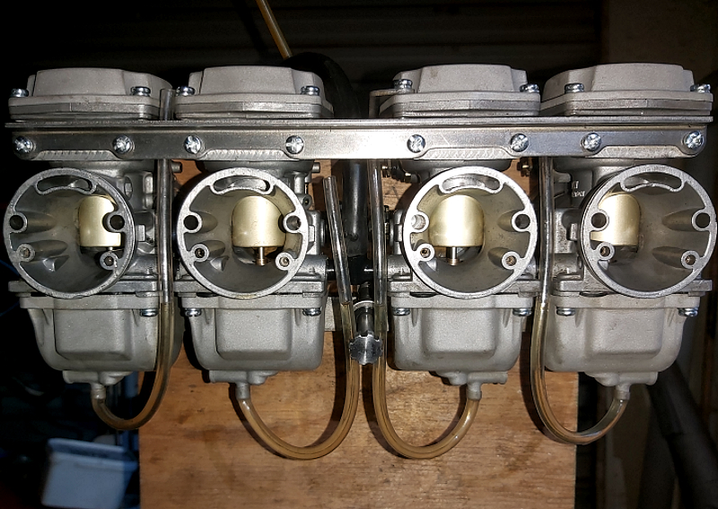

Re-ganging 4 carbs is fun, especially getting the choke shaft and all four choke fork parts in the correct sequence!
I live up at 5500ft so I swopped in the main jets (.125) from the other carbs.
Fully reassembled, with new M5 and M6 pan-head crews and split washers, they look fabulous:
Next up was to set all four float levels, using the clear-tube method.
I installed them on the bike... I like the contrast to the black engine and air-box!
Did a 100 mile ride yesterday... all good!
H.

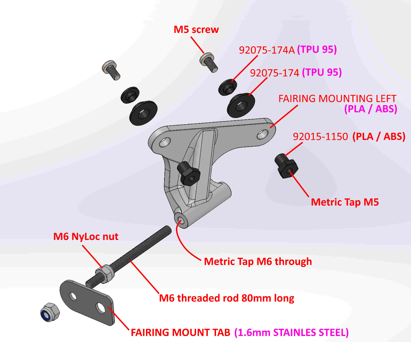

Thanks
Michel3007
, I had a whole lot of fun making my "Tribute", and I LOVE riding her every day!
I replicated the original GPz 1100B2 mounting method, with ALL its parts:
There are quite a few parts to print, so I've made two drawings that show what materials to use:
Here is the lower mount that attaches to the front brake pipe manifold (Kawasaki emblem removed),under the headlight:
Below is the left hand side, upper mount... Right hand side is a "mirror" of this.
Attached are two ZIP files containing the 3D printer files that you will need.
See pics above, showing which printer materials to use.
Regards.Howard.
Regards.Howard.
