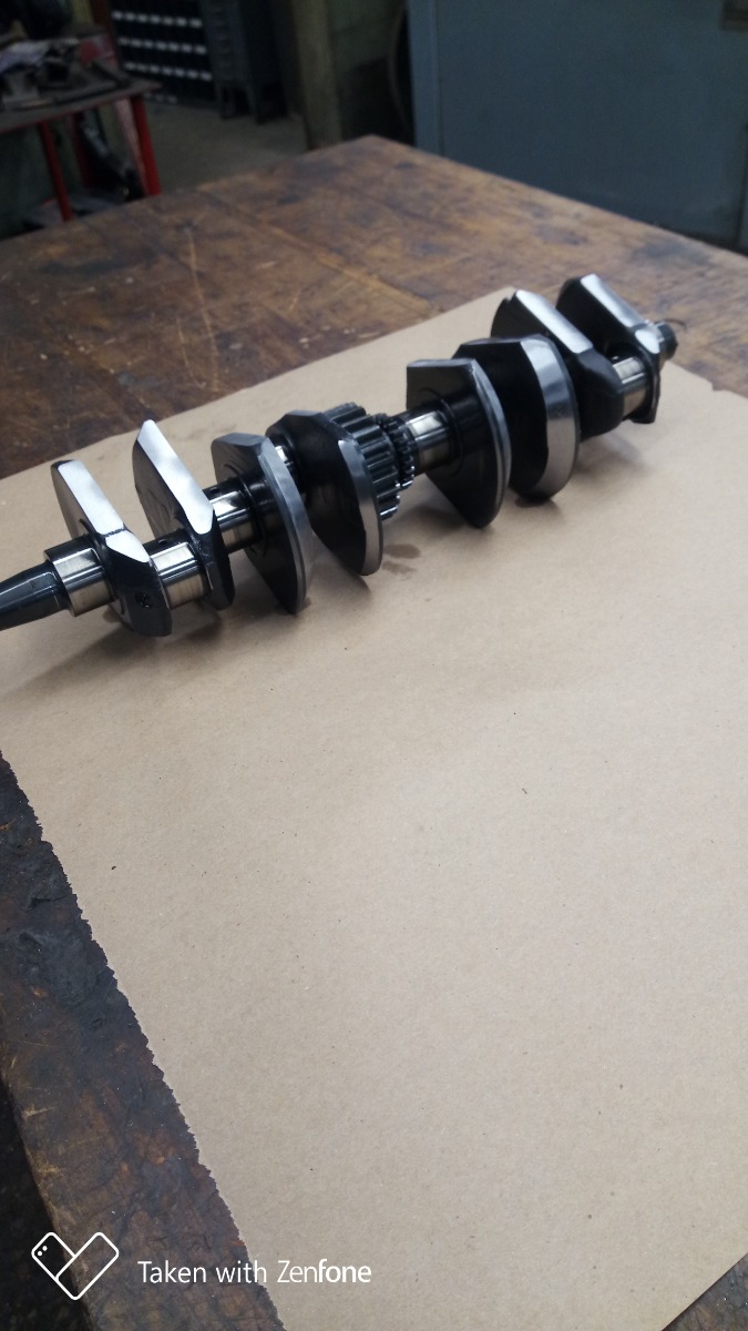

Crankshaft all machined and back from balancing

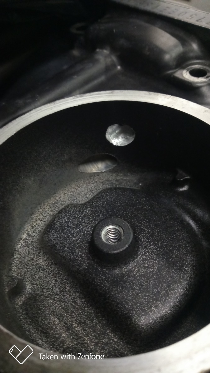

A Second hole was drilled to evacuate any crankcase pressure

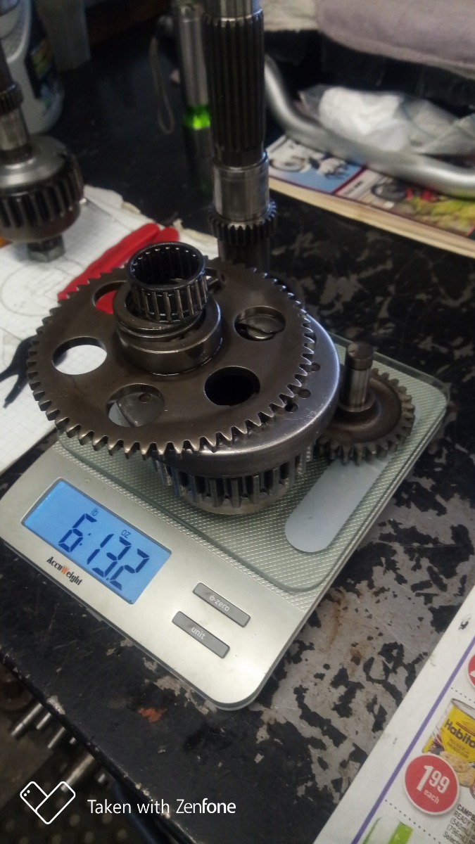

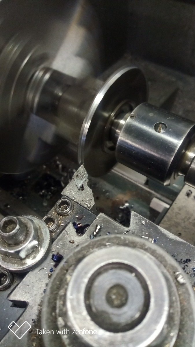

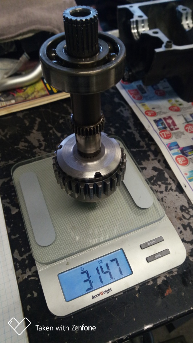

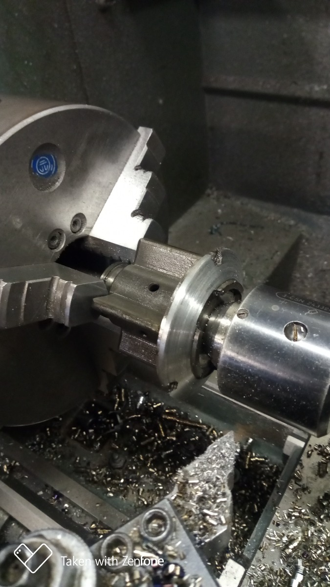

Starter clutch was machined
To reduce weight ,and anything not needed on the assembly removedAlmost 3 lbs was shed off ,most of it rotating mass
