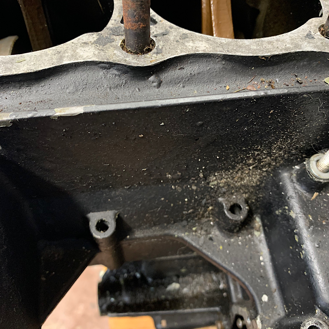

So today I started removing fasteners to split the cases, I’m waiting for my clutch tool so I’m leaving the large ones in. It’s a little nerve wracking removing the 6mm bolts torquing them up hoping they don’t snap off. They came out ok but I found two missing bolts. I’m glad I’m taking this engine apart, hopefully I’ll catch all the errors. The clutch plates look ok but the springs are heavy duty, I’ll revert to stock, I’m not drag racing and I don’t want to pull on that much spring. If my hold up continues I’ll start breaking down the wheels for new spokes etc. the spokes are terrible, par for the course here. Zinc plated spokes don’t hold up long.

I also cleaned and tapped out the 8mm jacking bolt holes.
