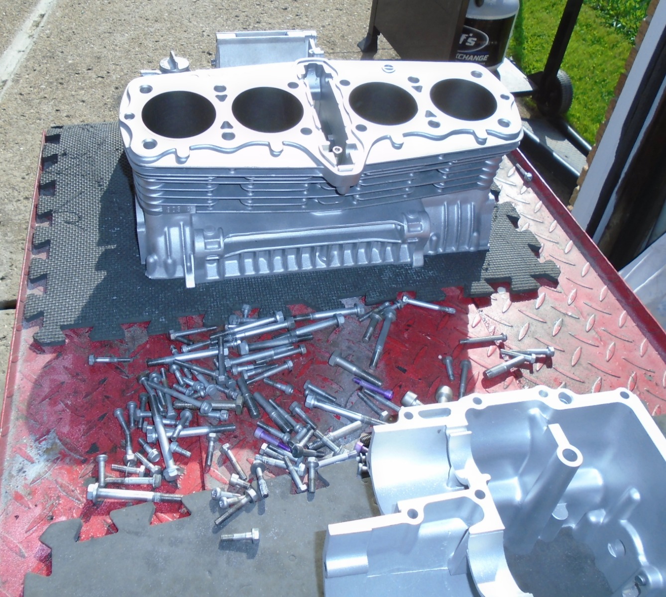

Het "Danno" (that's a compliment!!)
I don't know if your interested in any up close clean pictures of the oil galleys or a certain angle of anything?? Of these set of cases I just finished??But there just sitting now getting ready for a sale.I could get some other pictures.Until you do this yourself? This is a pain in the ass! My fingers are numb and sore even with gloves putting screws/bolts into every thread then removing. I also bored spigots out for 1197cc liners 3.225" sleeves.Marty in Buffalo
